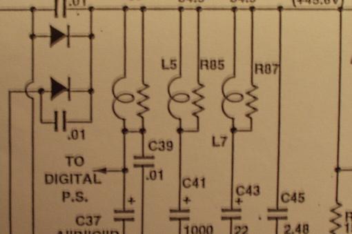

analog_sa said:decoupling". Looking at the PS of a PH3 one sees a 470uF in series with a parallel combo of a 2.7uH and 54R9. The resistor is presumably to damp the inductor and the result is a predictable impedance behaviour (rising) at high frequencies. All this is bypassed with a 2,0uF and 0.01uF. Seems like a reasonable way to achieve bypassing and at the same time decrease the sonic signature of the electrolytic at HF.
Part from PS schematic of AR preamp LS10
analog_sa said:I'd be keen to see the rest of that pic 🙂
Hi, Peter
I haven't scanner at home. I can send this schematic tomorrow to you. (please, mail me your e-mail address)
