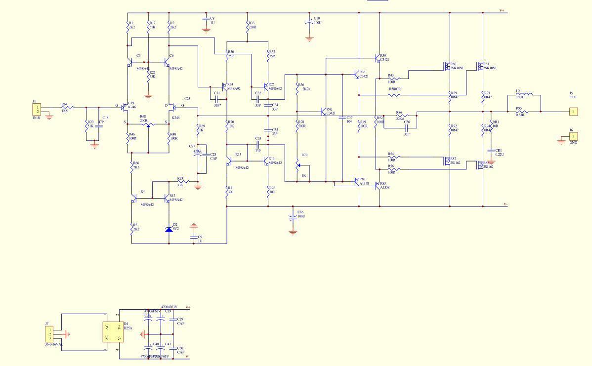

You did say that the doubler supplies were on the pcb. Even if you did not mention the protections specifically, no commenting on them made me assume they were not included.
But that is not what I had asked. My question had been if you can add that additional filter Goldmund had included for oscillations on the protection you had proposed, based on the UPC1234, which I had uploaded.
Thanks!
Thanks!

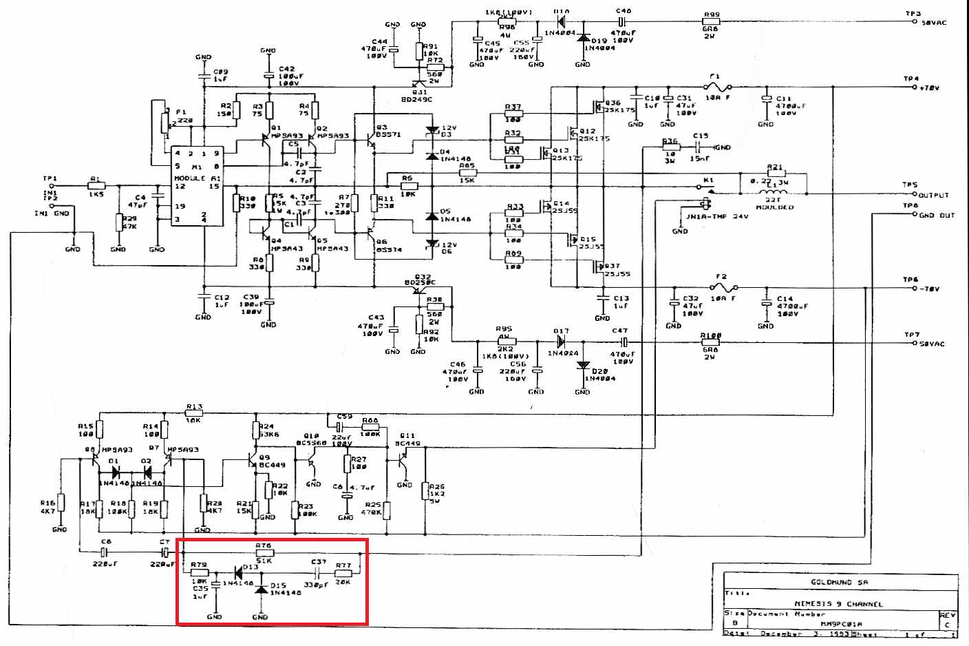

I have no intention to make this PCB. The filter part (I think you mean Zobel and Thiele network) is already on the board. Further, I have another PSU board with 1237 protection system, I think that would be enough.
And, you can buy 1237 boards from China easily.
The GM8-D remains a upgrade space for this (There are 4 additional screw holes). So it's not really a problem.
Since I have done protection boards for GM many times, I think the protection is not that important(?!)
Because these MOSFET have negtive temp co., and my topology won't cause any oscillation or instability in my experience.
This is the oscillation filter Goldmund put on their power supply.

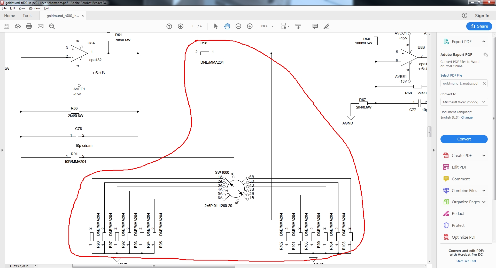

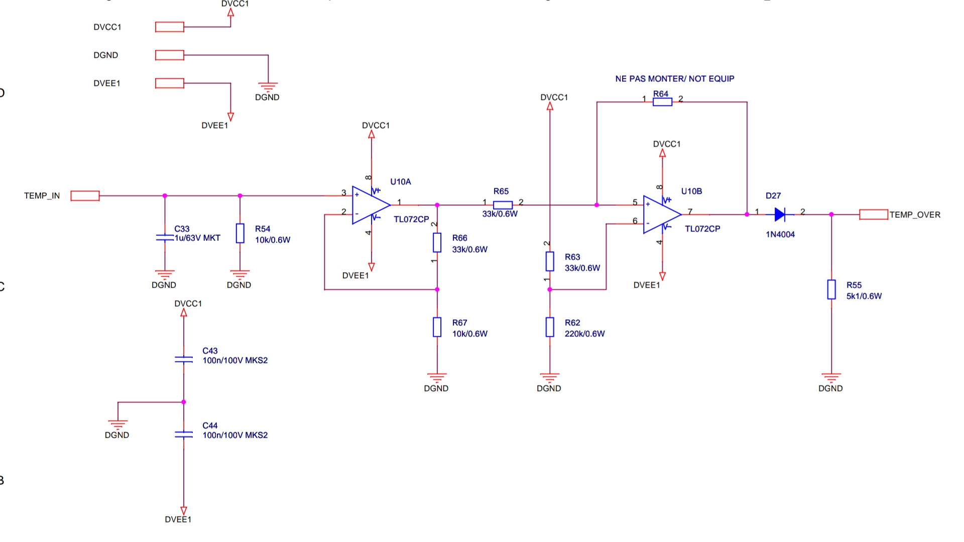

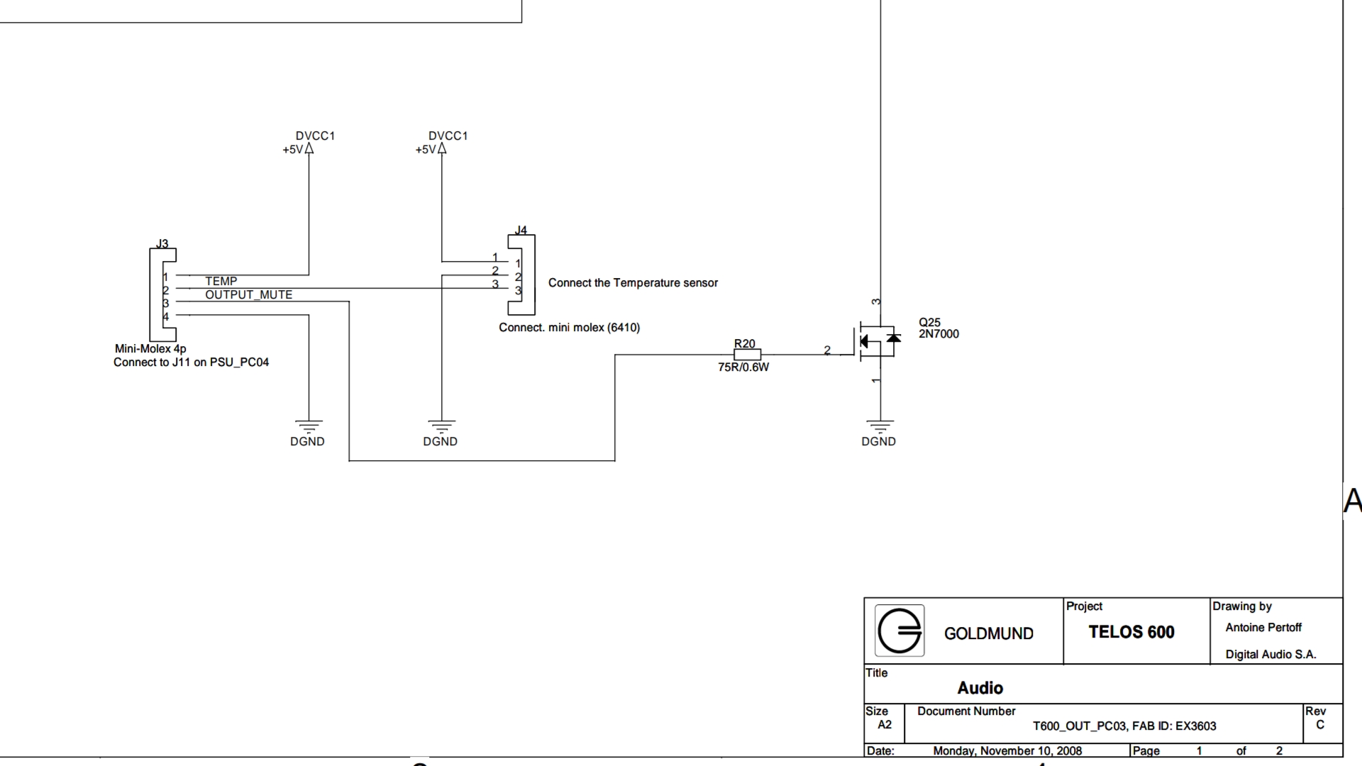

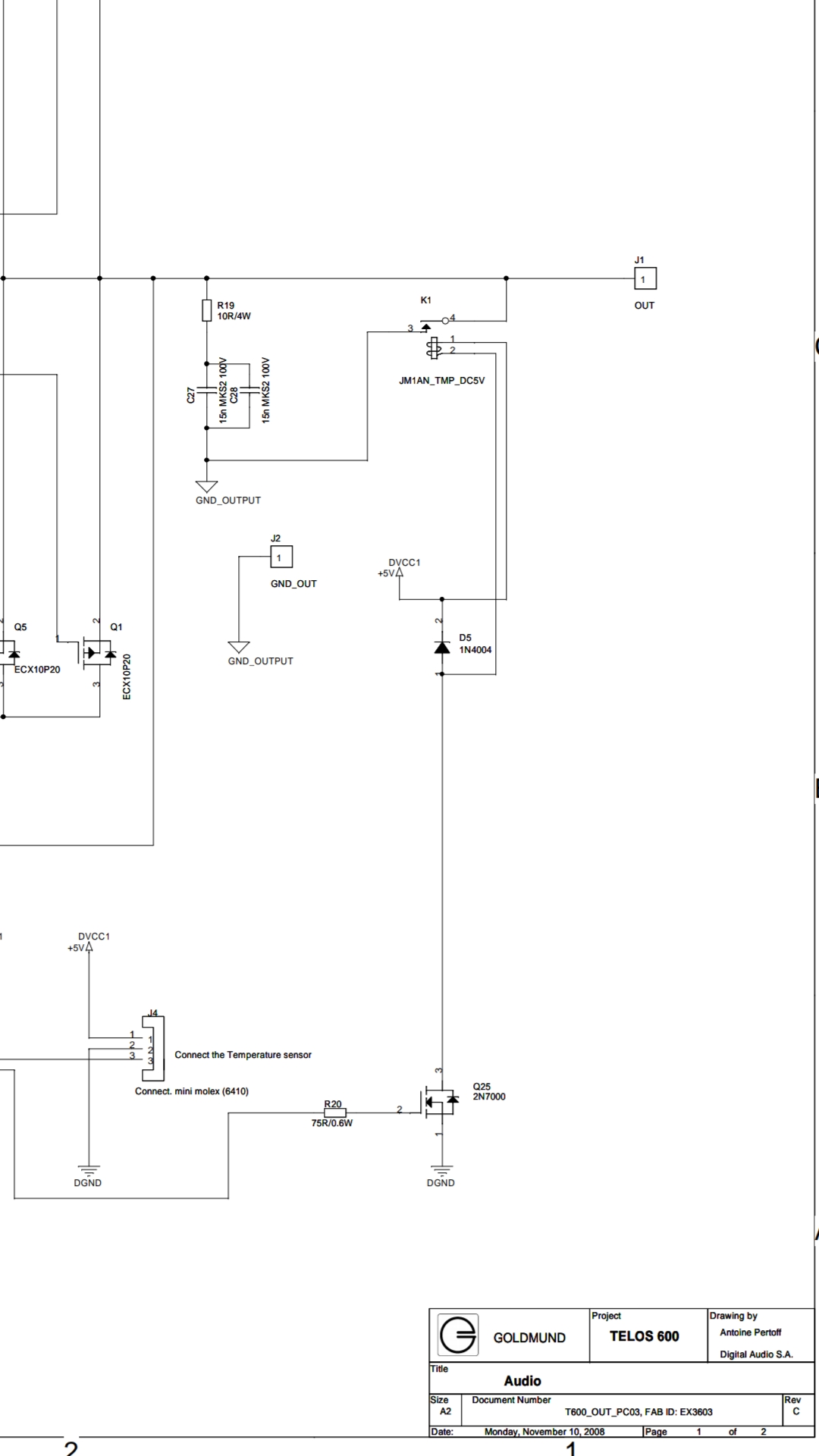

I have full original the service manual, include schematic from GM.
Some people on this forum have received original manual detailed from me, included JOB4, TL600, TL5000.
We are sure to building this Amp, instead use the junk schematic on the Internet.

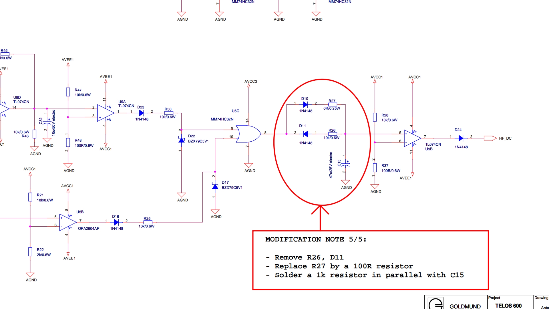

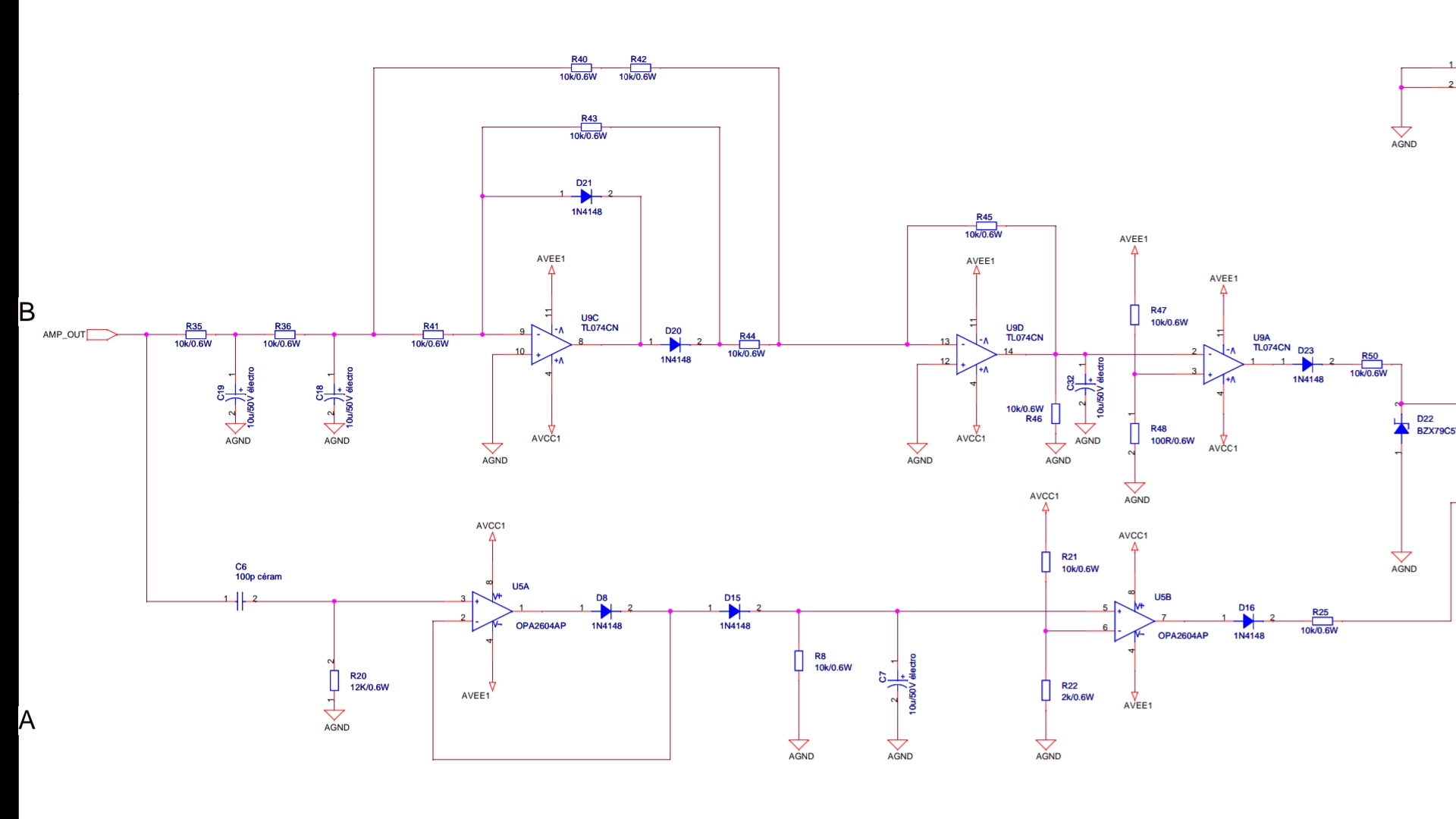

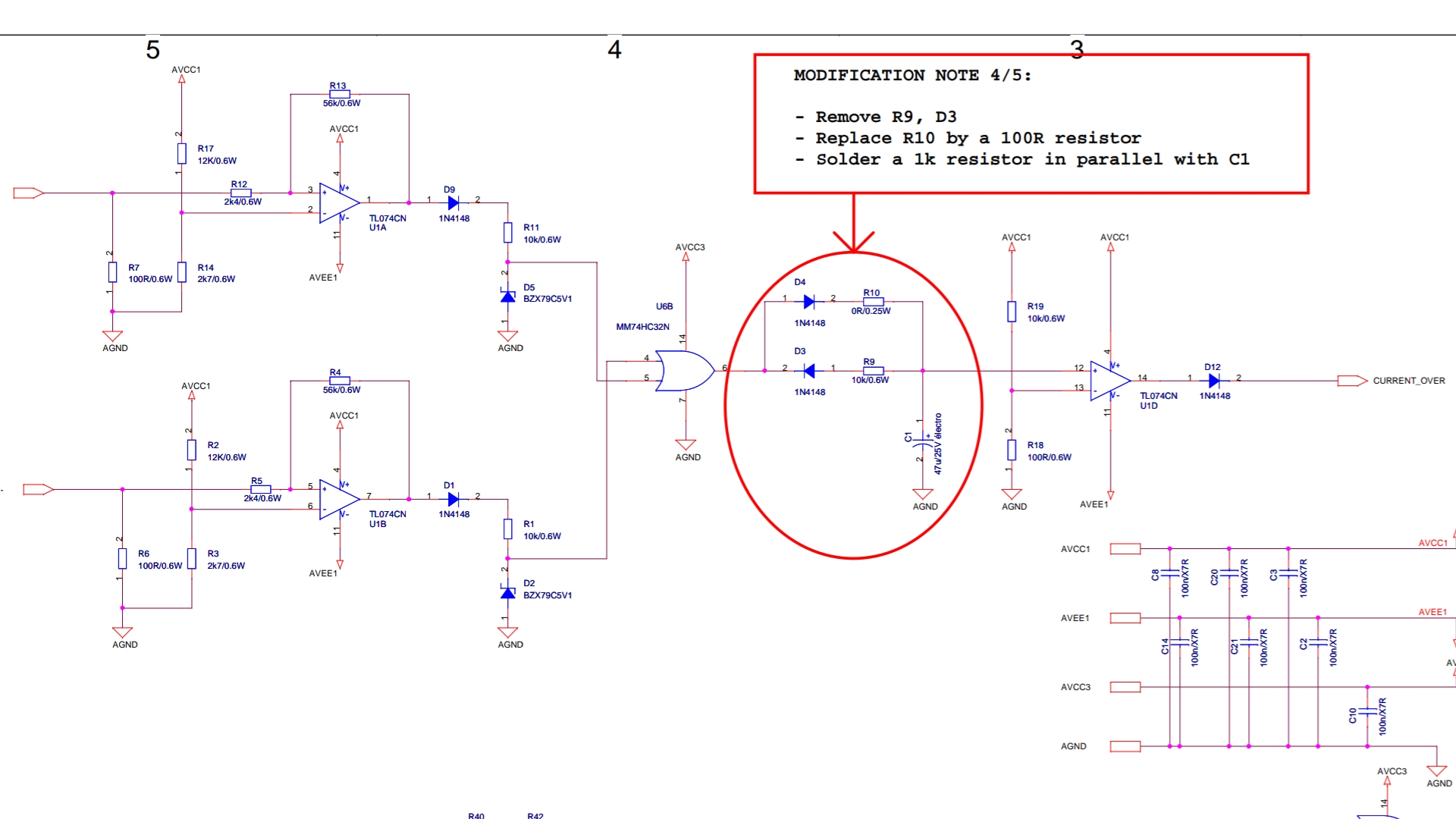

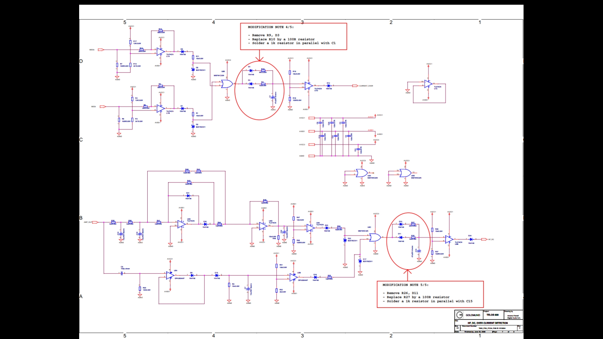

On TL600 with Over Current, HF Detector, DC Detector and Mute 😀

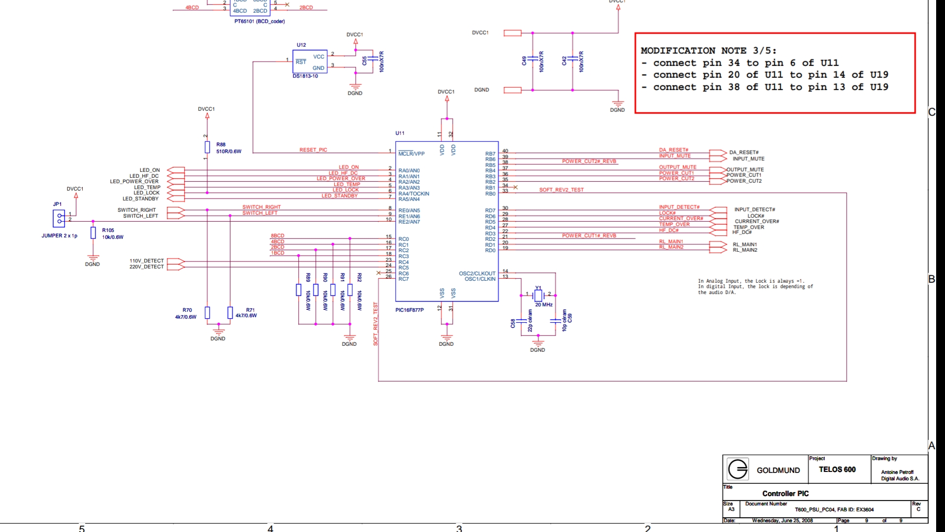

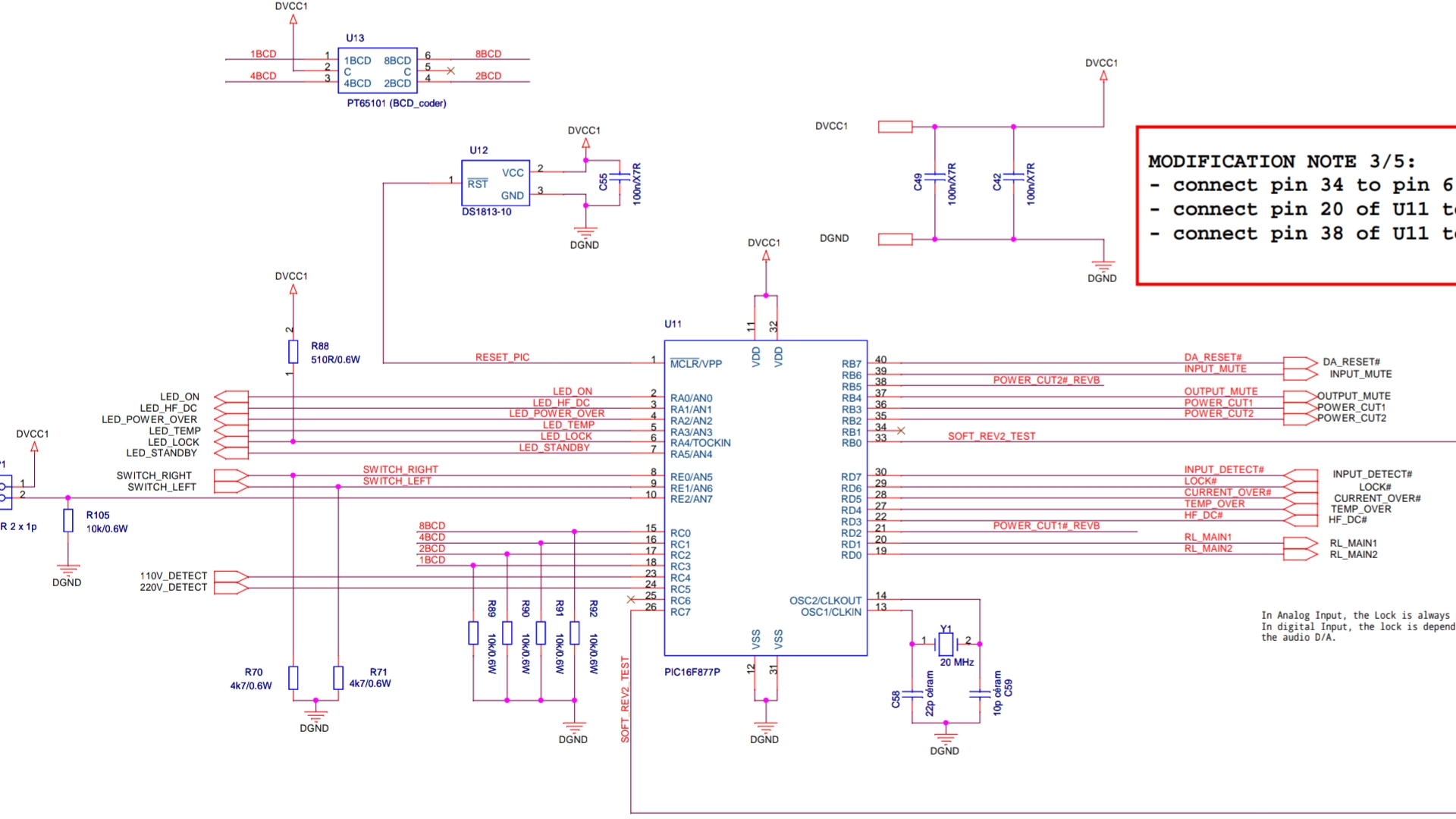

Sorry, I don't know what you mean.
This is Digital Detector on TL600.
Pls check your inbox messenger to received high resolution.
