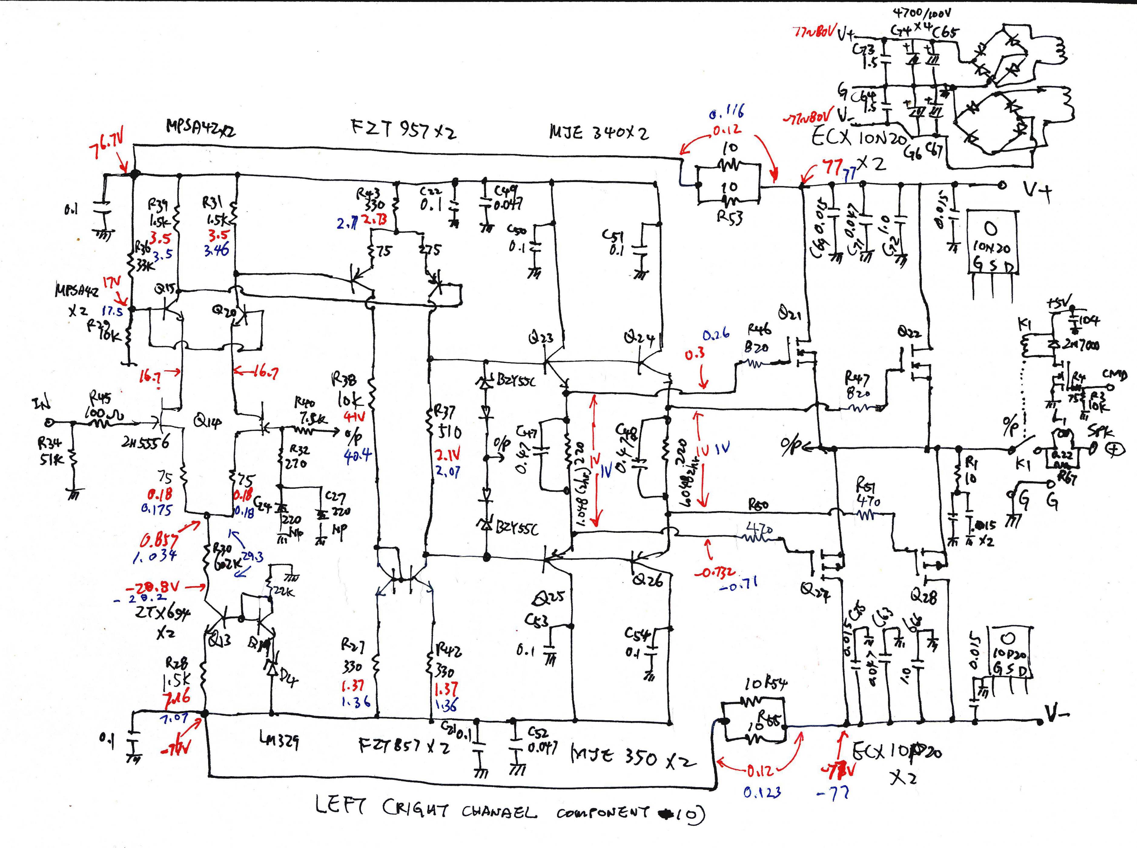

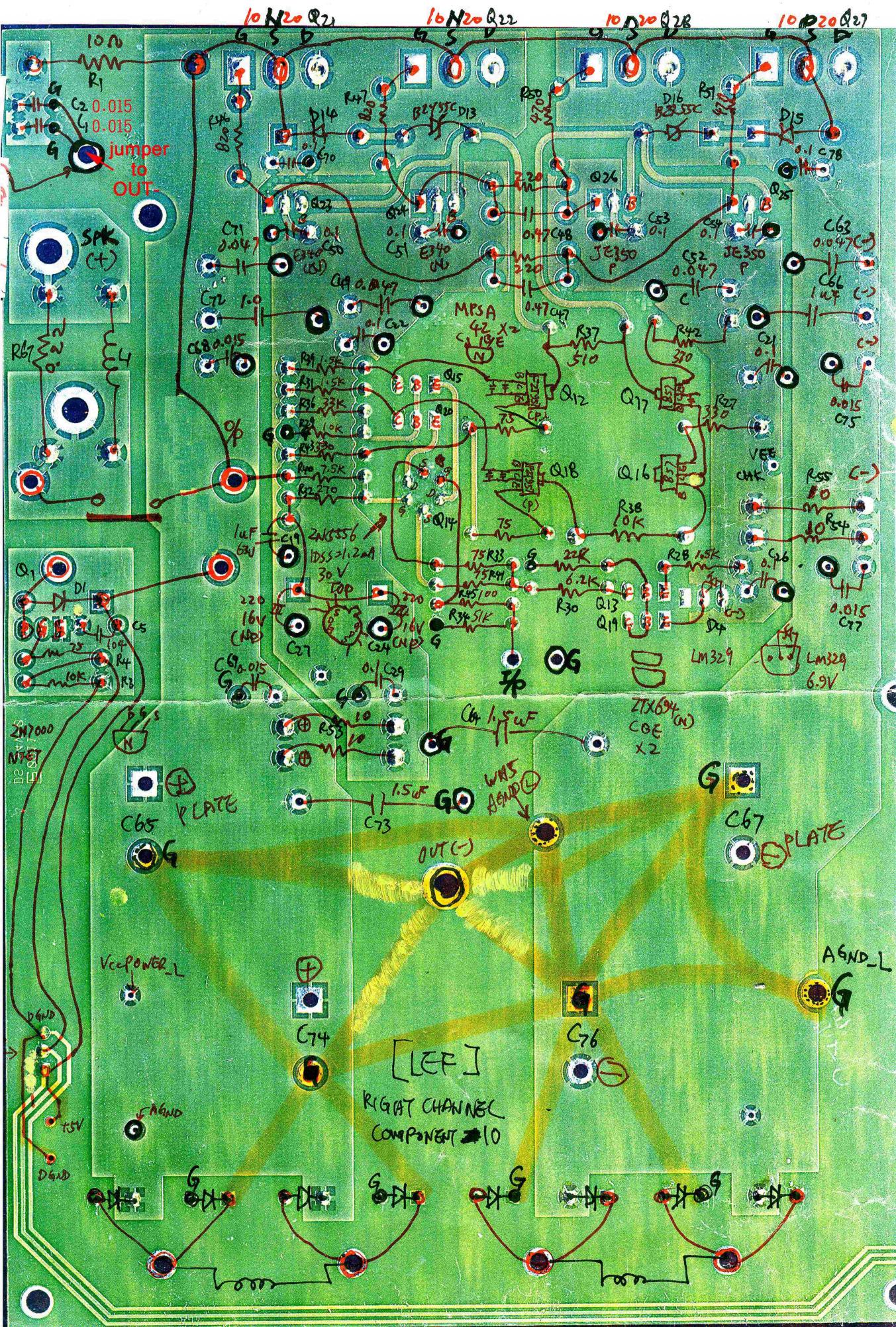

Hi all,
Got some valuable files.
Seems to be G-390D schematic and copper bottom scan.

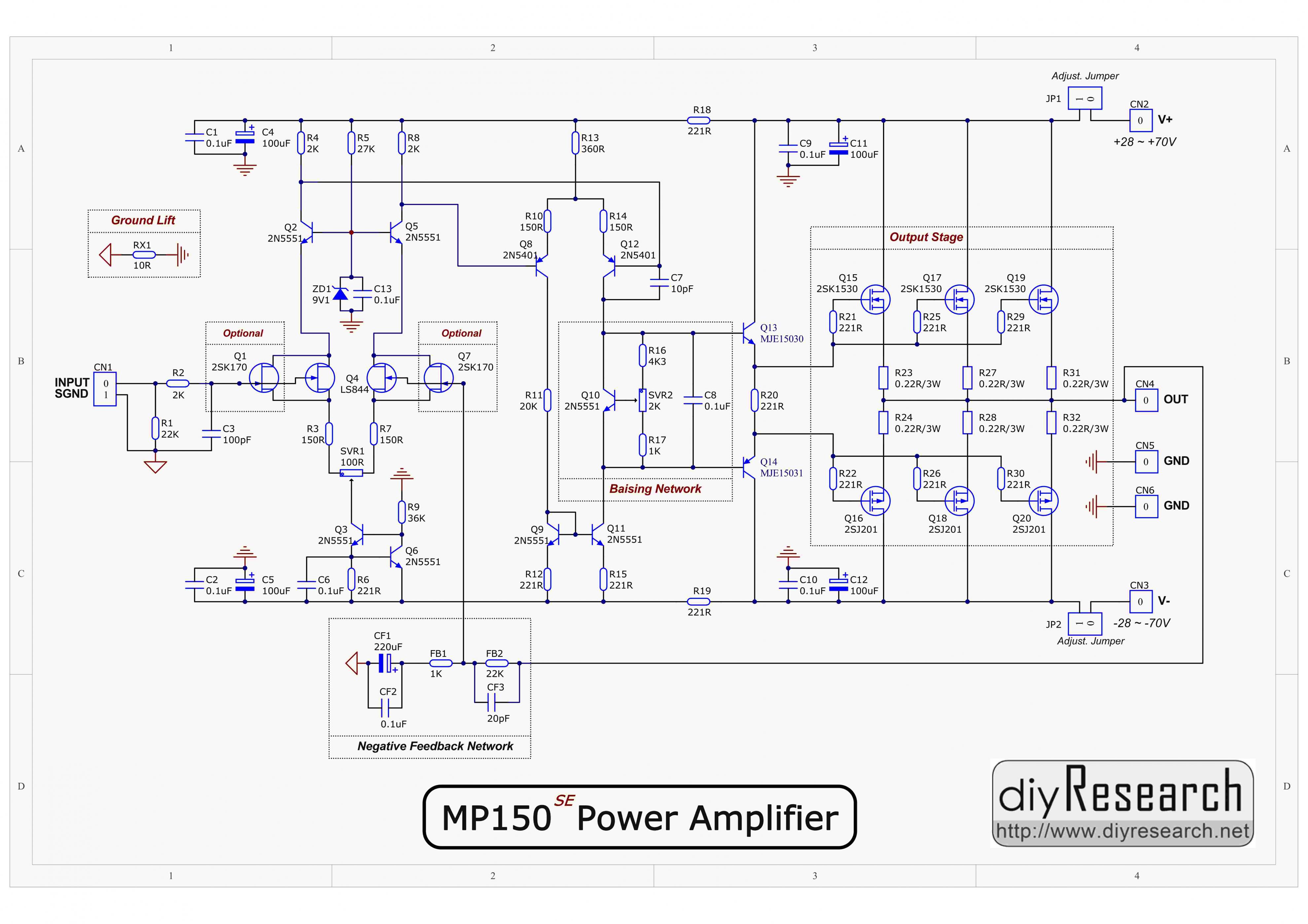

As I know, these eBay things are related to "DIYSONG MP-150", a mimesis29-based project from Taiwan.
DIY Research >> MP150後級擴大機組裝說明
Then, numerous clones were noted on Taobao/AliExpress/eBay. They use 2SK1058/J162 or even BJTs.
As I said before, GM with 2SK1058/J162 is not as good as Exicons and genuine Hitachi, but much more cheaper.
Even 2SC5200/A1943 was also noticed from these kits.
The Chinese got intelligence from Taiwan, and made many variants.
There are also some Chinese/Vietnamese guy aiming at higher class models, like Telos 250 and above. They have there own clones, which is different from the above I mentioned.

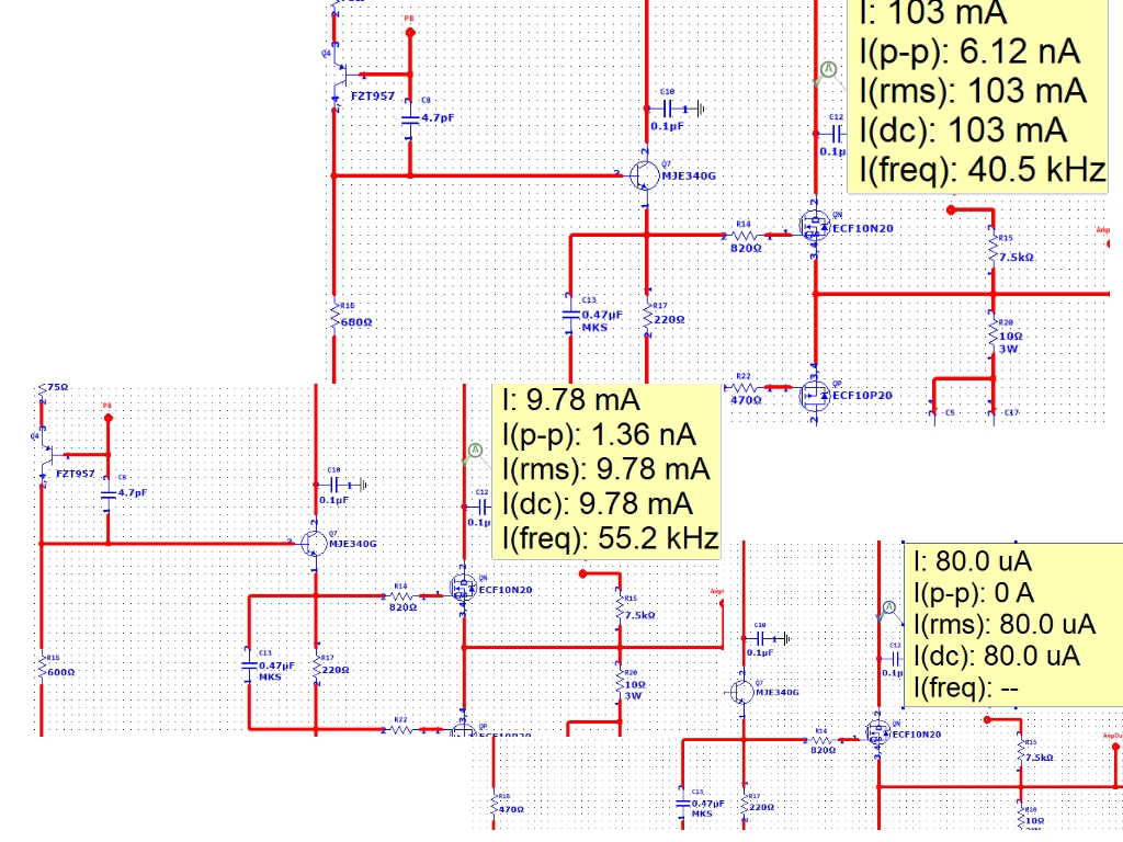

Are you serious or just joking? It's high bias...it heats like hell in idle.
Changing R16 value from 470 to 680 makes huge difference.
I think 10~100mA is OK for this amp, but uA works just fine also (in SIM).
Anybody knows exact value of idle current?

Sorry, but I didn't say it's no good. I just said the THD was high on the simulation I did.
The purpose of a simulation is just that: to try to predict how things might be.
Even the original Goldmund does have high THD on the simulation. Perhaps someone could get it to simulate with lower THD.
But that doesn't mean the amp is bad, as many people had built it or bought the original Goldmund, and find it awesome.
Ronaldo did the investigation, and got what is wrong in that kit and is missing (or faulty) on the MP150.
The 33p capacitors should be a tenth of that: 3.3p. Slightly less than what the original Goldmund used.

Two things the simulation shows that are interesting:
1) You should add the 12v zener + 1N41448 string between the driver's bases, as shown in the original GM schematic.
2) You might try lowering the 33p capacitors values to 4.7p or 3.3p, also as the original schematic. You should check with a scope for the exact value for this one.
Both improve THD considerably.
