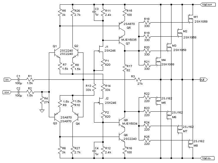

My question too , I also did find a strange scheme after.looking at it .
Maybe someone else may know thé answer . The one I used is the left one .
I think the right version is from Fab .
No, the right one it is not mine.
My GM Telos clone (clown) tweaked version is more about mainly different stages bias current and use of 2 pairs of double die laterals instead of 4 single pairs. I have also use 2sk170BL for input pair.
Fab

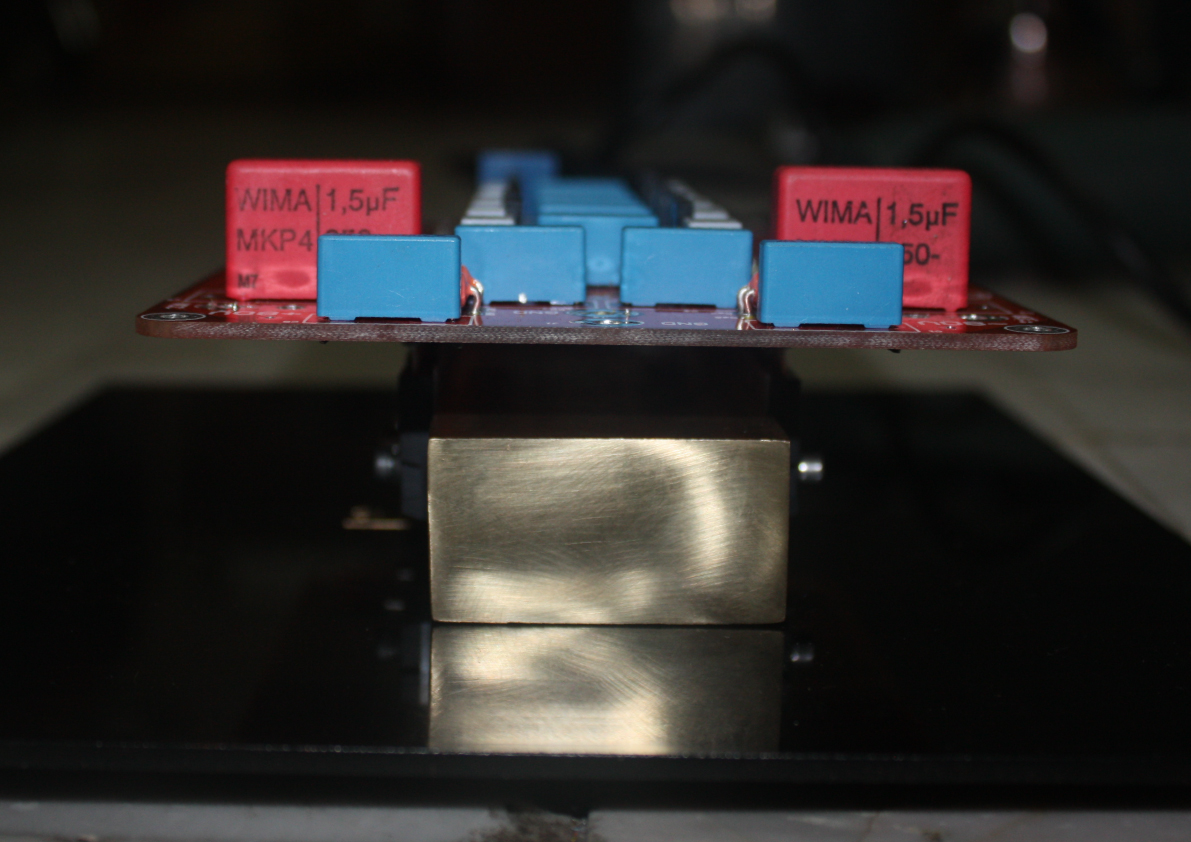

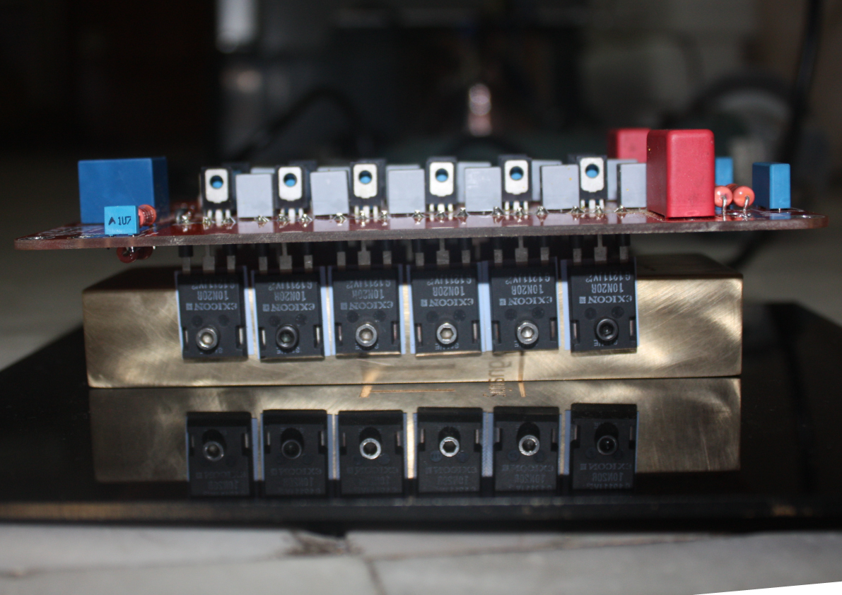

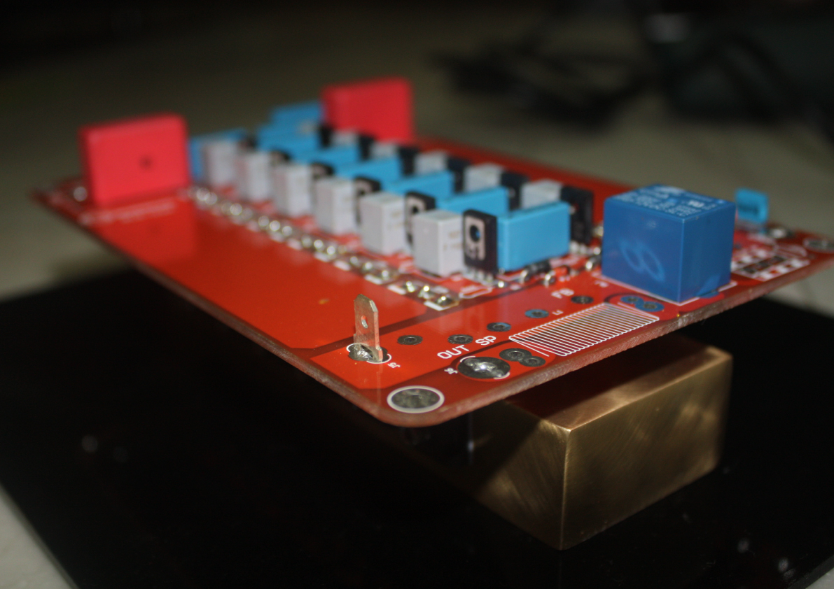

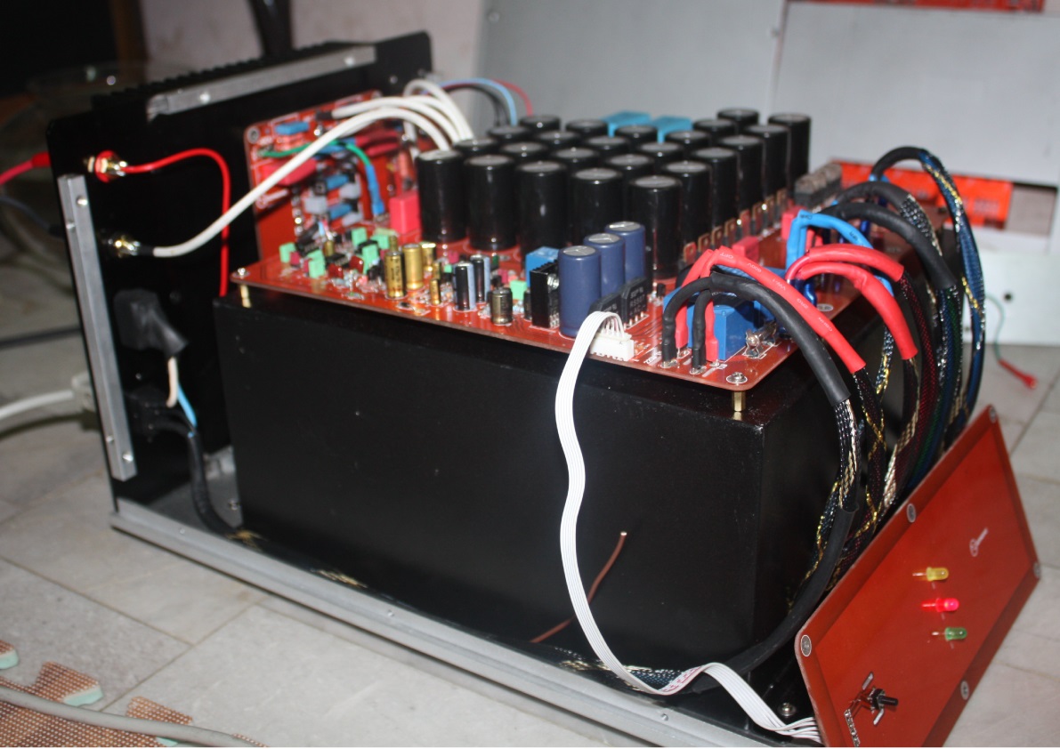

Hello friends!
I have make and clone GM many times, and failed many times. about 15 times unsuccessful. I have made PCBs up to 15 times, and success when I go about 200 km to open, view and copy 100% Golmun TL400.
After Tl400 succeeded, I continued to do Tl600 and 2500. I'm heading towards TL 5000.
And here are some pictures. I have used 5 years, This is a reference amplifier for my audio system!

What amplifier models are those you mention above? Different Goldmund types? They are kits you bought? Where are the schematics?
With the parts value of QuangHao. So, Amp can working without fire/damage. But parts value that not orignal, not exactly.
That value are mixer between TL600 and TL5000.

I have done: TL 400, and 600, TL 2500, all near the sample schematics!
Image i make TL 2500, you see
Last time i make many PCB, but in Diy i can not public it!
Thanks you advice, and can PM to me! or e-mail!

The shematic of Telos 400 from Quangho can be seen in post #262.
That is a very good and stable amplifier.
Hi koldby!
Value is not the first important issue,
Most importantly is PCB, is it running stable and great after time ??
The values you have, it's the moment I made them when not directly opening the TL 400, but it still works well. Gm has minor changes in the versions, and the schematic with the product is adjusted to match!
