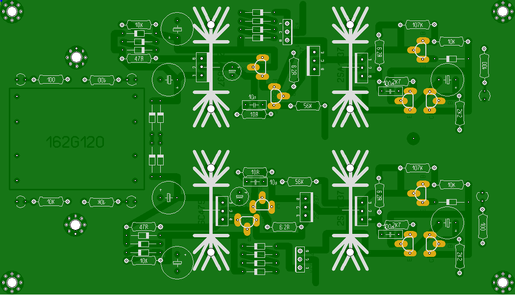

Why don't layout jumper positions, so some could only populate the capacitor multiplier part, and others the CCSed parallel reg too. So both persuasions can have it the way they like in one board, not to make a reg second board in any case and avoid extra cost. It will also be a nice opportunity to listen with or without the whole thing and compare for those curious, and Kean's reg work not to pass non evaluated.:wrench:

Hi Krisfr,
is this a double layer board, if not you have some dangling connections. If it is double layer may I suggest that you do not use vias, but change layer at the component connection, that way you have a leg connecting both layers as well as solder suck through.

Sorry Krisfr, on the other hand it looks nice and symmetrical. try avoiding right angles in tracks, rounded tracks are good but not always practical, normally 45 deg works well also.
I can attest to this aspect of design - also - where circuit paths meet a 90 degrees I would put in a radius flare to get rid of the "sharp" corner. Also done by putting in some 45 degree angle "fills" in the corner of the 90 degree corner.😎

🙂I really appreciate your input, I am just trying to get the nodes connected electrically at this juncture, I can and will go back and take out the kinks and or corners. Until this year I have NEVER laid out a board with a computer. I am old enough to have used Red and Blue tape with Black connections. So push and shove me in the right directions. I am thick skinned and not easily intimidated. This is JUST a get the job done so testing can be done project. HOPEFULLY a group buy is in the future, and Alex MM or other expert can shame me a little. It will not take much to do so. I just think of it as fun, and I am enthralled with the Global inputs, sharing and group think that would have been no more than a fantastical dream a few years ago.😀

Krisfr, nice work! The 107k resistor should be a trimmer.
