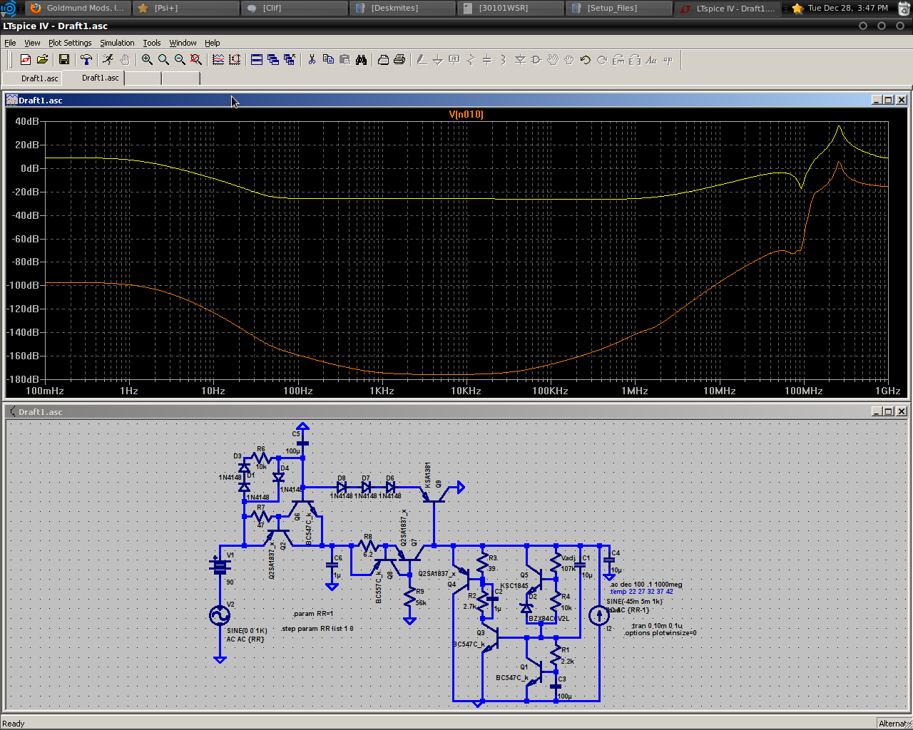

BTW, after learning much these last months, I'm working on the Kshunt again. I'm looking at a lower noise version with less drift, using the BZX55 low-noise Zener.
- keantoken
Perusing the datasheet, the LM317/337 is startlingly inferior.
Zout at 1MHz for the 317 is 1R, but the same for both my Kmultiplier and Kshunt is 60mR. It redeems itself in the audio spectrum and in the PSRR numbers, as long as you don't forget Cadj. For this reason I want to avoid the LM317.
How about this? I've discovered the perfect solution! It should beat the LM317 in speed, ripple rejection, and noise. Now the shunt is rock solid against varying mains voltage and interference. Unfortunately, it uses a lot of parts... Yellow trace is output impedance (flat to 1MHz!). Orange trace is ripple rejection, far beyond what an LM317 is capable of.

Even if the LM317 might be the better option for Zout in the audio band, the shunt should be better for noise, no? Let's err on the side of novelty for once...

Semis are not that expensive these days, if its stable and does not hurt anything, why not integrate? Its a hobby, you build to satisfy curiosity, not on economy brief. I mean why get down to this amp if it wasn't just curiosity in the first place and not build an Edmond Stuart's that would make more of a cutting edge sense? Amps will come many, each one's a toy, humans play to learn. But that's only my POV.
