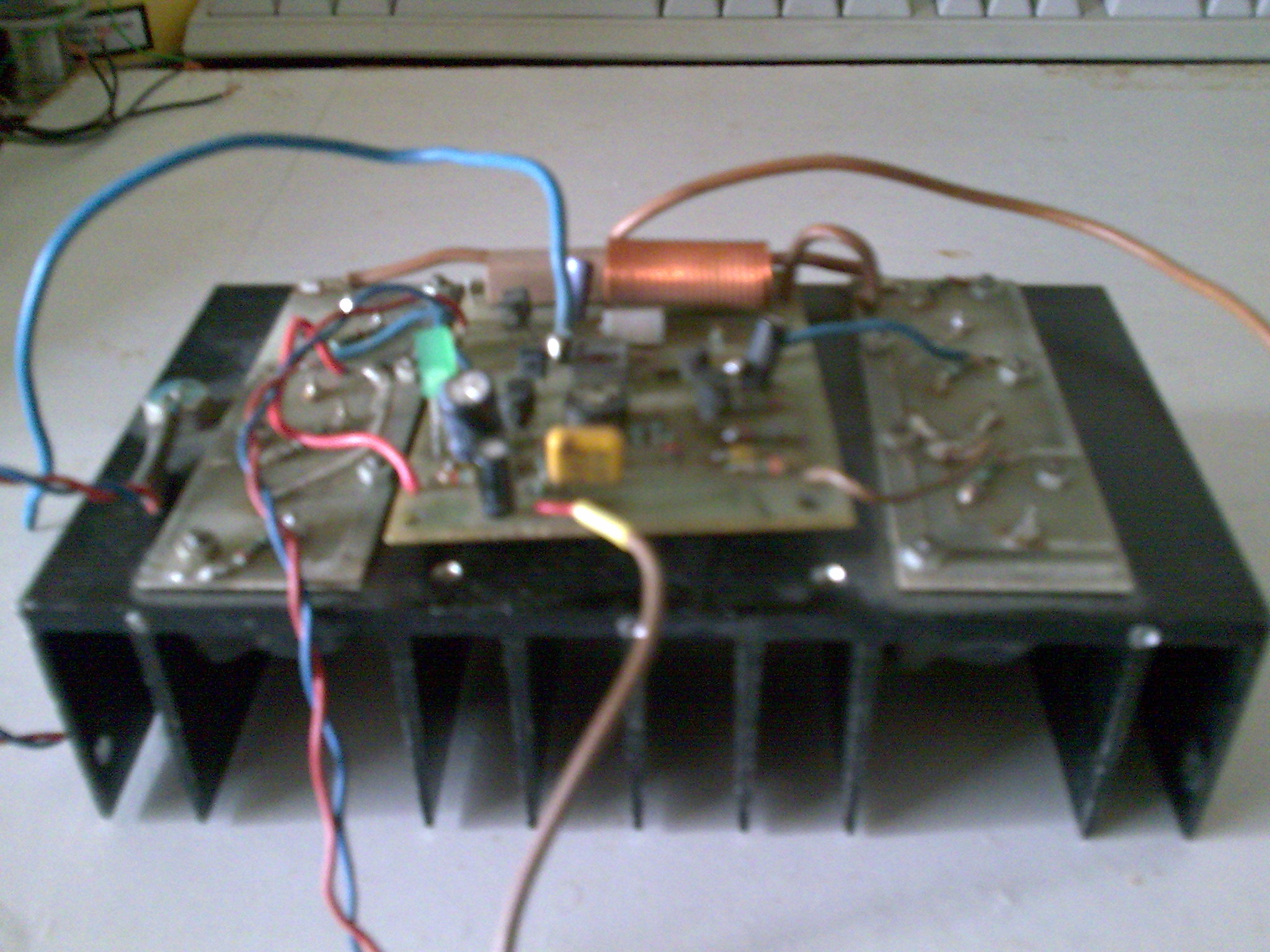

As a clue, back in 1985 or so, i did build a symetrical differential amp using
three pairs of 2SJ48/2SK133 which are the 120V lower grade of the 2SJ50/
2SK135 laterals.
Power supply was +-60V, and it happens that main voltage was increased
in France from 220 to 230V, increasing the PS to about +-63V, and i often
measured a few volt more at iddle...
Transformer was a beefy 620VA toroid along with 4X10000uF.
This amp has to endure the baddest treatements, full power on live stages,
often loaded with 4R , with ambiant as much as 40°C.
yet, it did always work, even it didn t have any current limiting circuit....

Sugden's P180 uses 2pair of Laterals running on near +-80Vdc. The PSU output depends on the bias setting and the mains voltage.I'm guessing that will depend on what you intend to use it for. For normal listening full power isn't necessary. But then again, who would need 80V rails for normal listening... Hmm...
Works well into 8ohms speakers for domestic listening.
Also rated for 4ohm speakers but when tested into 4r0 the PSU falls to ~ +-56Vdc.
I think Sugden deliberately used small smoothing caps and high regulation transformers to protect the amplifier from the effects of abuse.
The Laterals are also very robust.
I doubled the output stage to 4pair and doubled the smoothing capacitance. Sounds and measures better into 8ohms/8r0. I don't have 4ohm speakers but it can now drive 4r0 quite a bit better.
