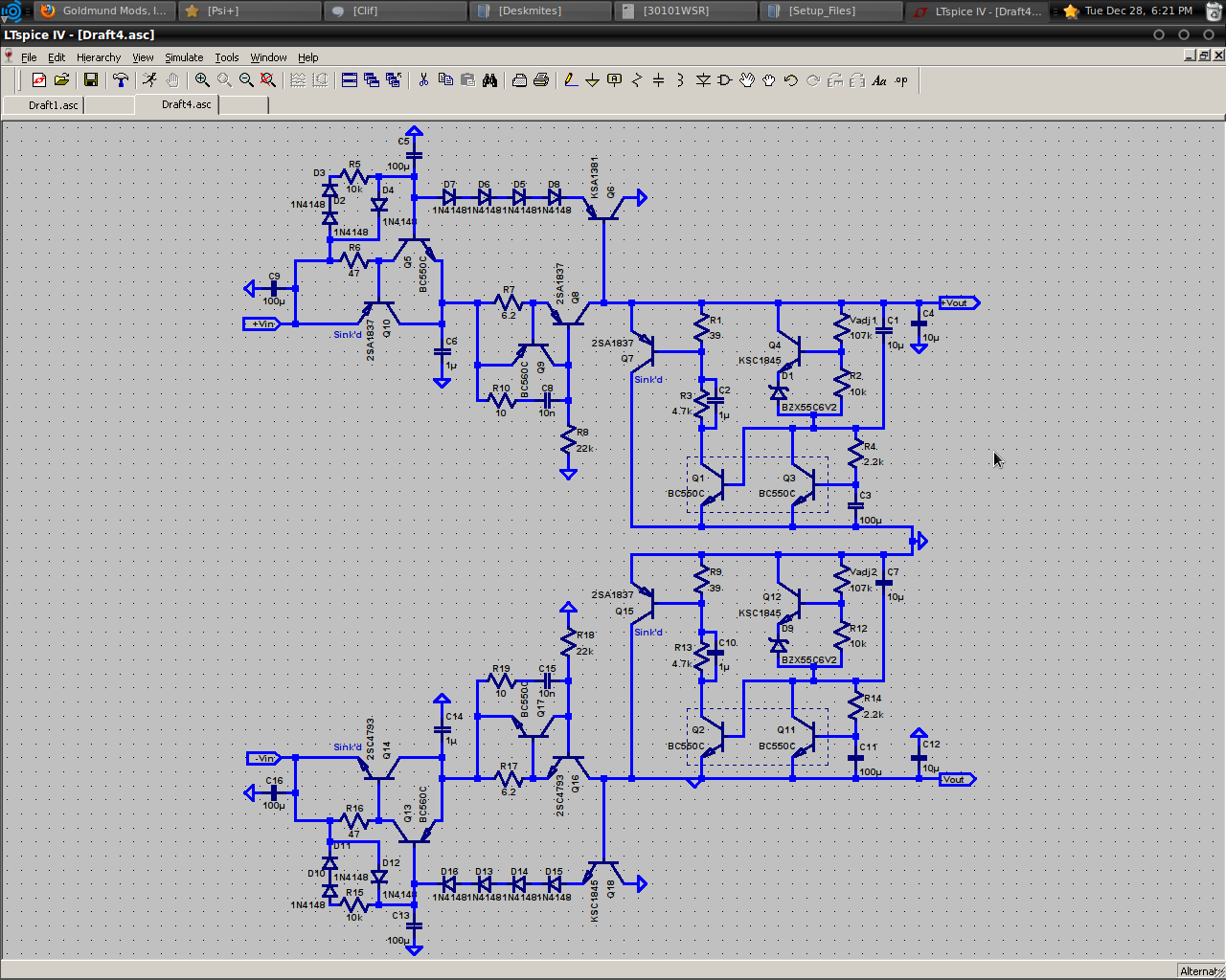

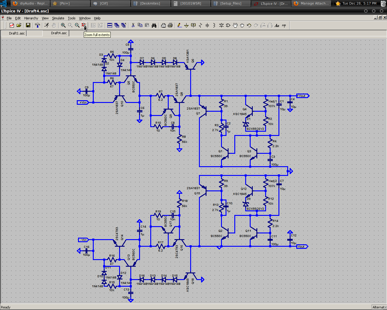

+ and - schematic for the preregulated shunt...
- keantoken
I think I get it. Problem with the caps though is that if they sit on top of the rails and we use 16V ones, the upper rails ground at HF will effectively become the power amp rails. I think this is asking for trouble.
- keantoken
Kean what makes you say that? What does HF have to do with the supply rails.
You are in effect adding a 9V battery to each rail, do you think it will become more than 9V because of some magic called HF? Who is he anyway?
keantoken,
The power supply in post 1367 is a terrible overkill. What does it do better that a simple circuit? What difference does it make? What are the specs? The PSRR of the output stage will dominate, so it doesn't make sense to use all these parts for the low voltage regulator.

Sawreyrw, beats me. They say a good CCS makes a good shunt, and cascoding it was the only thing I could do to increase performance. Dunno yet, haven't built it yet.
I haven't got the amp thermal sim up yet. That is what I'll do next.

If you want/need another view:
Use dual secondaries for the main PSU. bridge rectify each secondary.
Use dual secondaries for the little transformer. Tap the 9Vac onto the 45Vac to create 54Vac Bridge rectify this low current supply for +ve and bridge rectify the other 54Vac for -ve.
Now couple all the zero volts together.
This fits with not importing the mains PSU ripple and transient glitches into the low current supplies.

Why don't layout jumper positions, so some could only populate the capacitor multiplier part, and others the CCSed parallel reg too. So both persuasions can have it the way they like in one board, not to make a reg second board in any case and avoid extra cost. It will also be a nice opportunity to listen with or without the whole thing and compare for those curious, and Kean's reg work not to pass non evaluated.:wrench:
