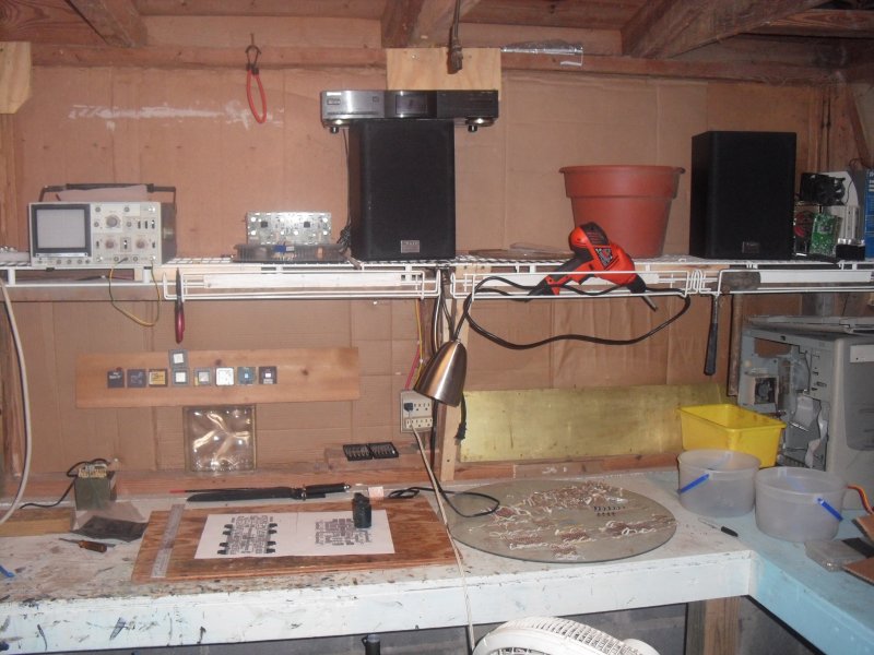

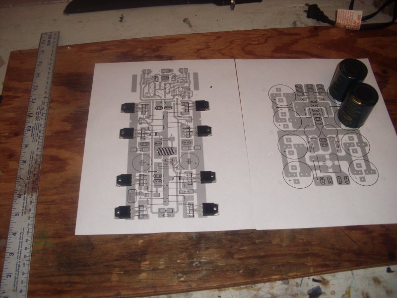

(Pix 2) is the lab I am devoting to make better amps for DIYA and of course myself (pix3) , I owe the community at least these things , if not more.
Thanks everybody!!OS
