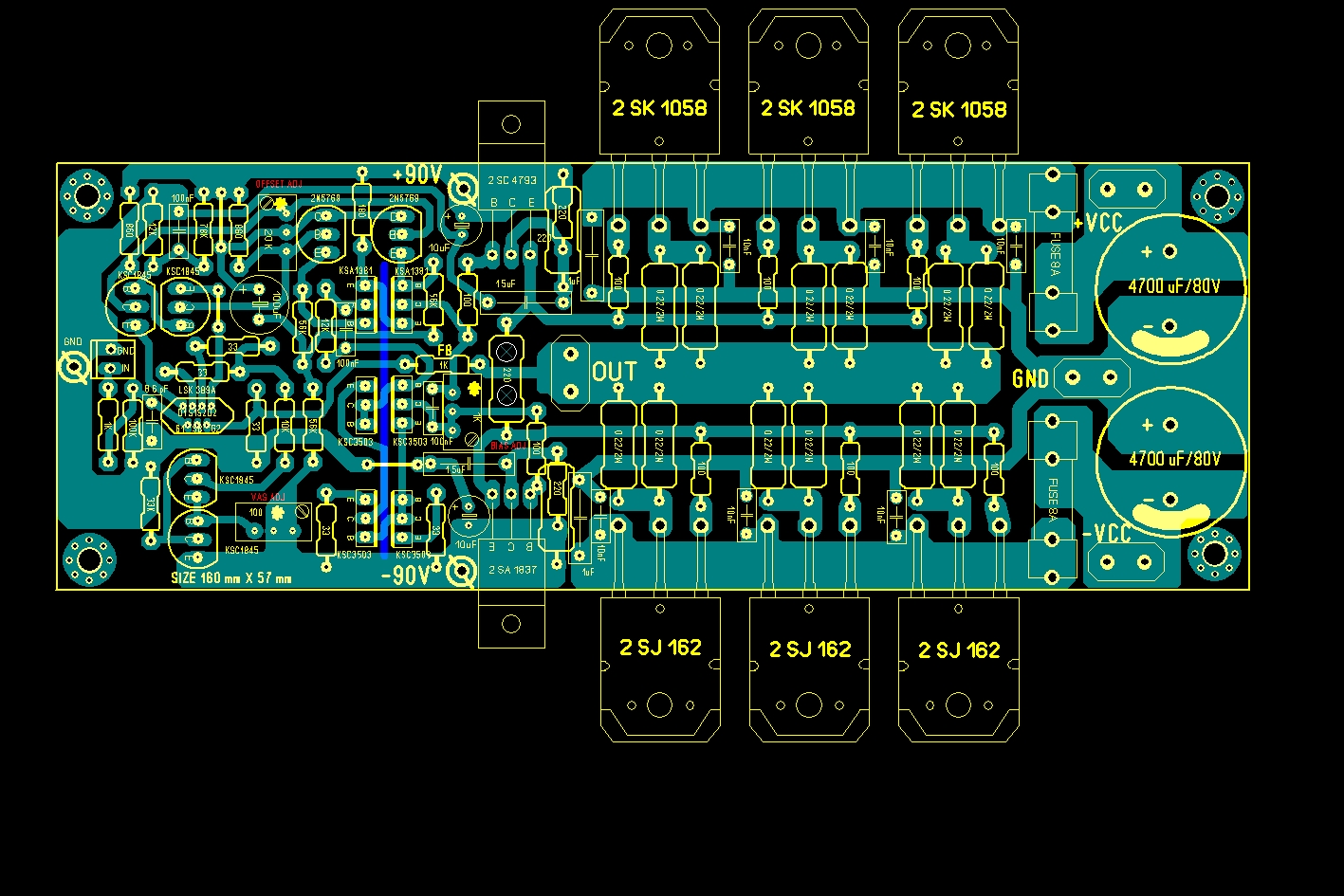

PCB revised...and schematic .....
... thanks for comments , I think this time grounding it's better ....or not ? 😕

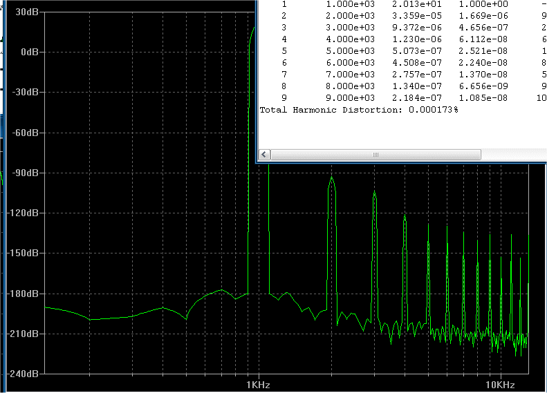

There are other enhancements in both device choices and general configuration that should come as standard , but the point is... it can be improved.. 🙂 (below) I know it is a crappy 🙄 173 PPM 1k/ 300+ @ 20k w/ stellar harmonics (FFT) ,but it is consistent up to 25khz and is very tame in any transient test. I could lessen input degeneration and get across- the -board 50ppm or less , but this is not as important as the FFT structure.

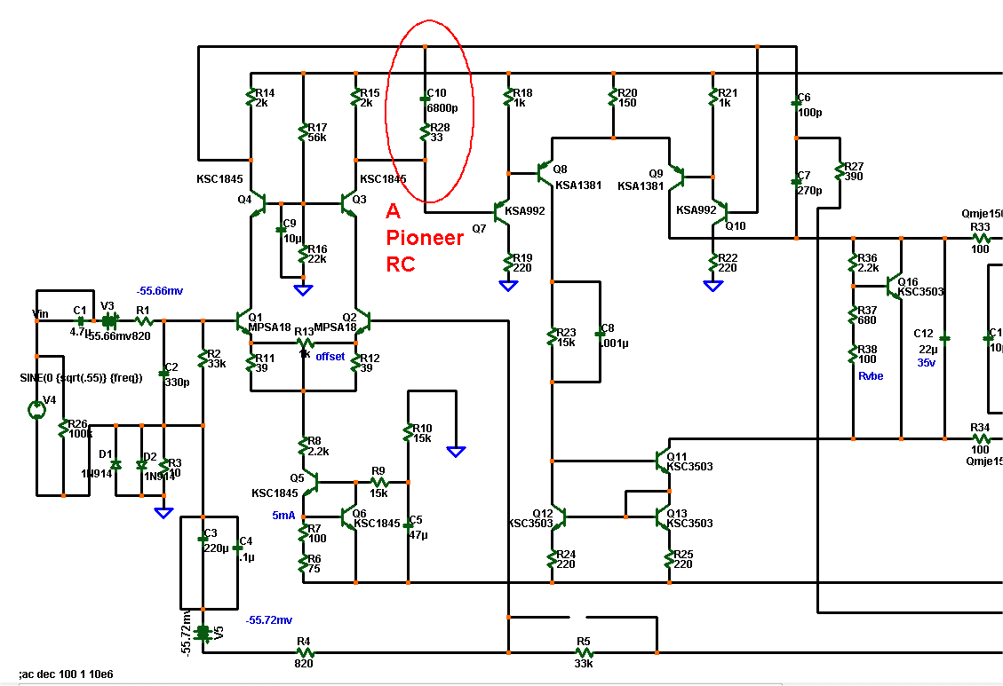

Oh , krisfr ... TMC has a "bug" with this type of topology and need a little extra compensation at the input cascode to eliminate the "TMC phase peak" at UG point which only occurs with this type amp. I solved it (pioneer mod) (below 2) , (should) work for keen's version as well.

Yes , I had to get it right before I went to FR-4 . A combination of other works (ampslab/pioneer), the wonderful "cordell NFB" thread , and some personal experiance might just get me something in the end. Luckily , I just have to make a voltage amp board to "play out" my theories. 🙂

Hi OS,
Refering to post #1133, you can use Miller cap on left leg of VAS(base Q7 to cocollector Q8) , it is simpler and it works.
dado
Tried that , no effect on the phase , also tried 5pf lead comp. at GNFB , made the phase "hump" worse. What you suggest also affects TMC , partially negating the reduction of high order switching distortions that TMC usually reduces. I will ask the Masters on the cordell thread exactly what is happening with this compensation scheme in regards to this application. I know it works well , but I must know WHY.
This errata does not happen with conventional miller comp and does not happen with any blameless based amp , but it does with any vas based on a differential. Ampslab uses the RC , and pioneer uses it with the M-90 which drives a differential with a differential . plugged in 33R/6800p .. perfect closed loop gain bode. But I still must know why .. hopefully tommorrow. 😎
OS
OS
Because you're dealing with compensation on differential signal going to next differential stage. Compensation on common GND or rail would simply not affect both sides of diff signal. It has to be done this way I mean with RC filter, cause basically it is frequency dependent load and it also rightfully follows the rule that each stage of the amp has to be properly loaded. That's exactly what I was tried to elaborate with 10-22k load on VAS. Defenitely VAS is not properly loaded with output mosfets only and this would put it on the right track. Simple as that. 😉
