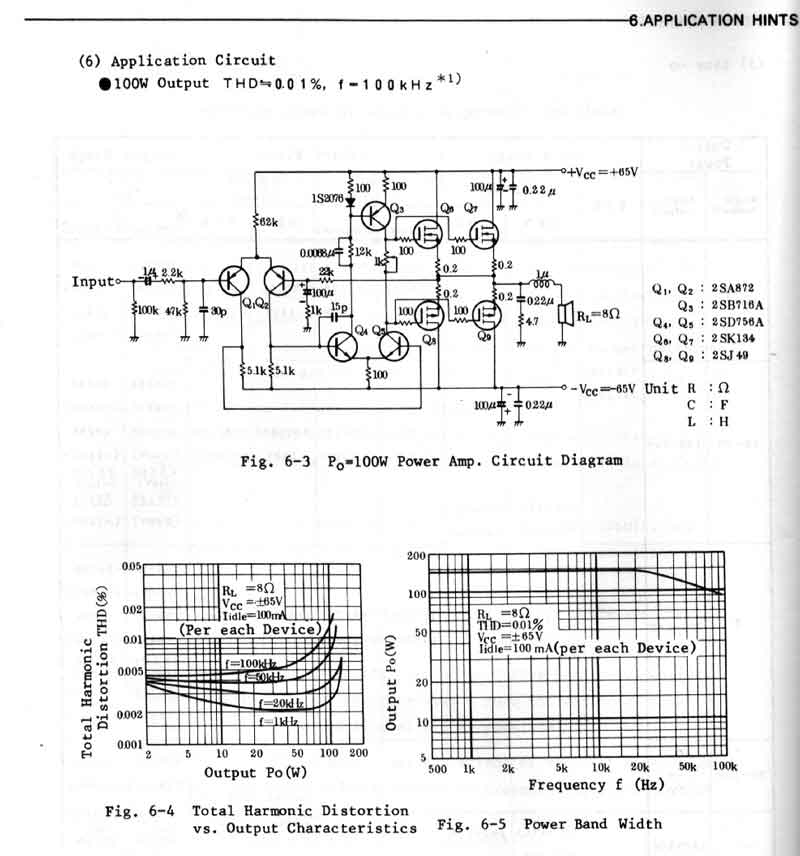

Go back to the Hitachi app note. Using that mediocre amp or the Goldmund circuit with the exact same power supply, I will be stumped if Nagys or anyone can actually tell which one is best, or even if there is a difference.
Kind regards
Nico
Actually, the first Hitachi app note, back from 1978 or so, is no worse and even better than the goldmund ,provided we correct the tiny compensation, since it s on the wrong bjt.
Adding a complementary emitter follower to drive the laterals, it let the goldmund
in the dust..

Good points Nico but I still like the idea of fet inputs because you could direct couple the amp anot have to deal with the base bias current. I don't think we need the drivers either.
Jam
Hi Jam, I would agree with you provided that the preceding stage or source has zero off-set.
Think about it if the source has a tiny off-set of just 1mV and the amp gain is 31 times then the off-set would only be 31 mV.
What if the input off-set was 100 mV? Maybe it is unimportant as many sources have capacitively coupled output.
Yes, a capacitor is said to introduce distortion, but has anyone quantified it.
