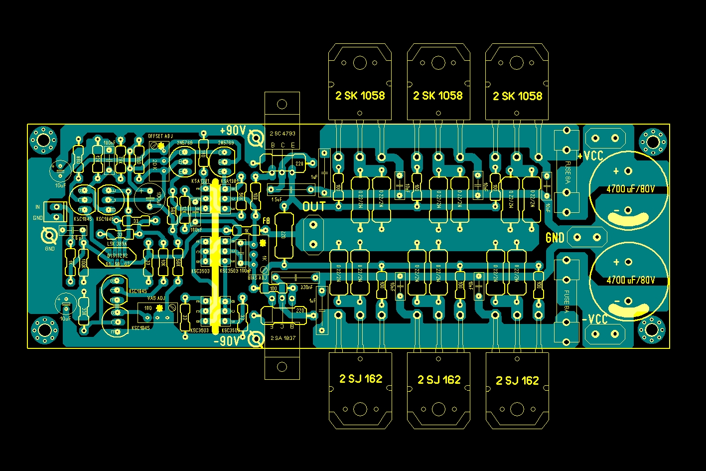

PCB .....first layout
...... I have not receive ,any feedbak from posted schematic , it's correct ?
First try to layout PCB ,see attachaments .🙂 and schematic revised.
Alex.

Sorry, I was a bit short.
Ground on the left:
The two 10uF caps might add some nasty current to the sensitive input ground plus the caps are a bit too far away from where they are needed plus this way there's a dead end going to the caps what is always bad and to be avoided.
A solution could be to place the 10uF caps directly next to the -/+90V connections and put another decoupling ground right next to it. This way the decoupling ground can't influence the sensitive signal ground plus you have the return right next to the +/-90V, can twist them together and thus have no big loop.
Power ground on the right:
The connectors are close to each other what is good. You could move the small 10nF caps much closer to the pins of the OP devices (where they are needed and have lower series resistance) and thicken the ground considerably.
C8,C9:
Why are the caps dissimilar?
Ground concept:
I suggest to have three grounds:
1. input and small signal ground
2. 90V decoupling ground
3. 80V power decoupling ground
What do you think?
Looking the keantoken's schematics only one comment I have: let's omit R36 & R39 220 ohm collector resistors and rather put VAS load resistors app. 10-22 kohm from emitters Q13 & Q14 to ground to linearized VAS load impedance and thus even more lower frequency dependent distortions. 🙂
:wave2: If you ignore proper VAS ground loading you'll have not only ringing but every imaginable oscilating problems to solve with unnecessarily compensation. Really not needed at this point ...😀
Already the circuit is shown to be unstable and prone to osculation around I meg. Layout will be tricky to avoid loss of speakers as it can make a bad design far worse. Alex wait for a signed off circuit, you are running away from time.
As it stands, the amp posted in 1`037 is seriously flawed. Let the boys fix it up first, then do a final layout.
Alex your abilities are exemplary but don't put too much effort until the design has been sanctioned. For the moment it is far too early.

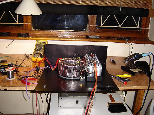

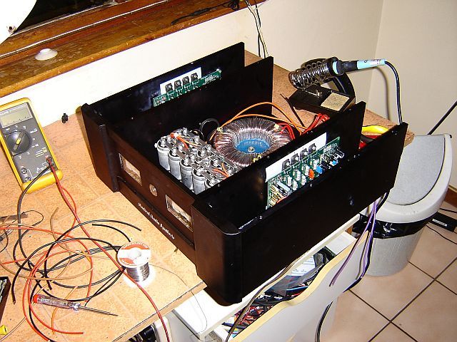

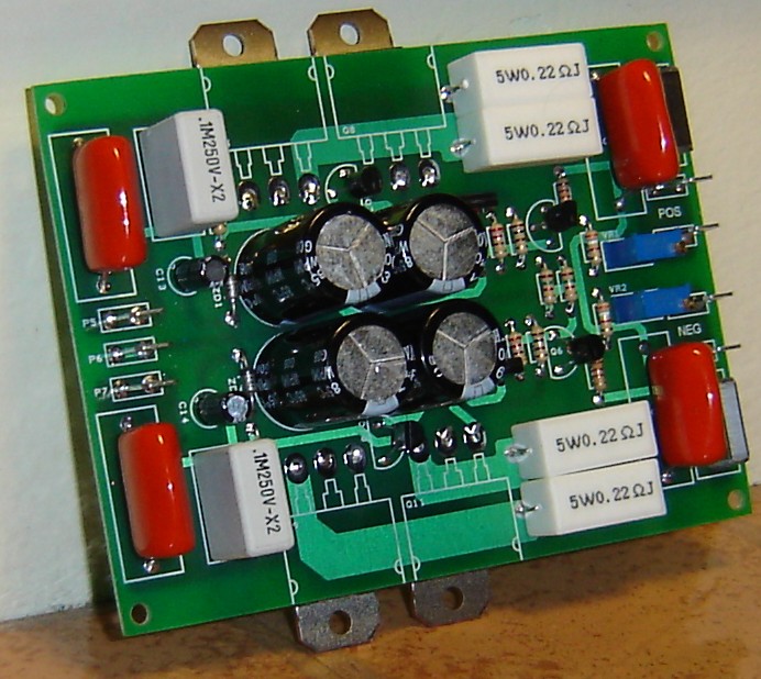

This was the prototype no 8 built early in 2007
It was a slow process to integrate such an amp that would be commercially appealing and at the right price as well as be MUCH BETTER THAN A GOLDMUND. The launch date was 12 March 2007 and it was done with the appropriate partying and sound industry guests.
It is again such time and RAS-ELD 2 which uses a mixed BJT/MOSFET configuration and undergoing severe testing for the next two months will be launched in February 2011 too distributors and in March 2011 to the public.
Because ELD1 will soon be redundant, I will offer it to DIY members to build.
Kind regards
Nico
