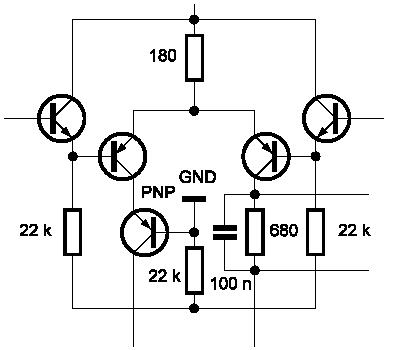

gentle reminder. the original purpose and objective is to see what twenty years of electronic research and experiences can do to this circuit. you postulate that nothing can be done, i say lets continue and see where it leads us. i For one think the journey is just as interesting as the result, and im not convinced by the argument that there has been no improvement in electronics that could improve this circuit.
Before you can improve a design you need to identify the weaknesses, reengineer around these weaknesses and then evaluate to see if you have met your objectives without adding more weakness to the overall design.
Withour trying to be funny or reading 23 pages, what are the weaknesses we are trying to fix?
Also intersting comments Nico made about the psu. I think this is one arae the Goldmund team put alot of emphasis IMO.

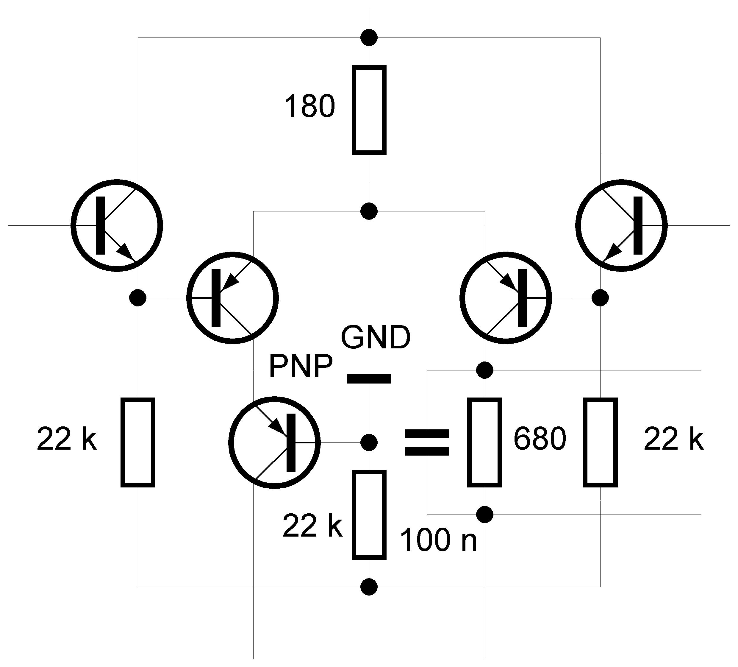

OK keantoken if you think 10-22 k VAS load would decrease performance significantly than maybe rather use this GND anchor which would do no harm to performance but only improve stability.😉
I have been honest.
I can't see the information clearly.
When it is thumbnail, it misses out too much.
When it is expanded to screen size, fine lines get missed out.
When it is expanded to full size, I cannot see what information it is trying to present. I would need about 6screens @ 1.3Mpixels to see the whole.
It's too ******g big !!!!
