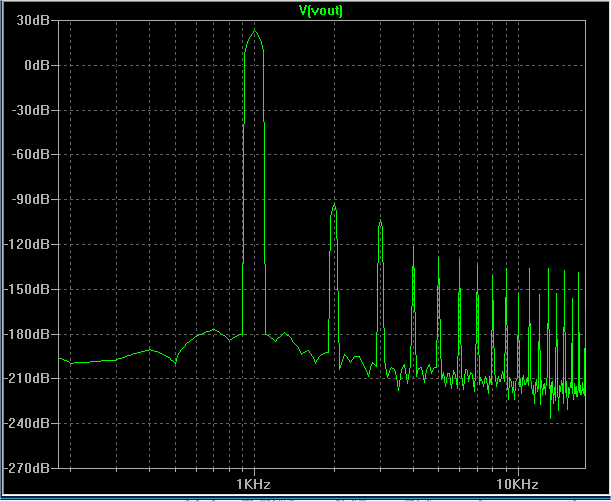

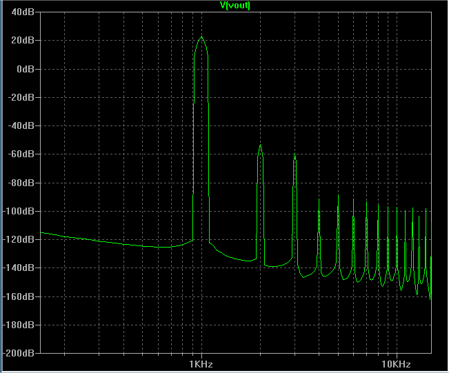

By Nagsy - What has been proposed so far could be a very stable amp potentially. And it could spec very nicely for certain parameters. But as a whole, it will not outperform the original Mimesis amplifier, not by a long shot. The fundamental theory of this new circuit and parts choice is significantly inferior.
I would believe the simulator as opposed to you . Even as it is just simulated the A/B FFT comparison of the goldmund and my MUCH improved version speakes for itself. EVEN if the simulator was "off" , it can't be that far "off".
(attachment 1) is the original , it's crude design shows itself in H2/H3 distortion , but it does have pretty low higher order harmonics ... in other words it shouldn't sound to bad. BUT , it is NOT the worlds best amplifier ... not by a long shot.
(Attachment 2) shows mine , which is CLOSE TO KEENS.. it has 20-30db !!! LESS H2/3 and practically no upper harmonics.
To interpret this into the real world is simple . one would have a sound (flavor , tone, character) and the other would be as a perfect magnifying glass adding nothing ... you would JUST hear your source and the noise of your input differential.
To all the disbelievers , such a massive reduction in distortion (in simulation) would set the two circuits apart in a living room and in the real world circuit (on a scope or distortion analyzer) .The differences would be substantial either way. One might like the distortion of a particular amp , just as the tube lovers like thier warm second harmonic (H2) good for them ... I like nothing.
And please don't worry the simulator guys will do their job, than it's up to us, guys with experience, to bring the design to higher level than you'll ever imagine. Wait and hear ...
More udder *@** , I have built 4 or 5 versions of this topology , and with my modular setup , try out 5 more variants within the hour. ALL TALK , NO WALK !!
PS. notice how the spectra of the 2 amps is so similar , the beta enhancement and the better devices (ksa/c's) are the big factors in the performance differences. Amp #2 has 120v/us slew and is quite stable into any capacitive load. I make my mouser order tonight.. 🙂
