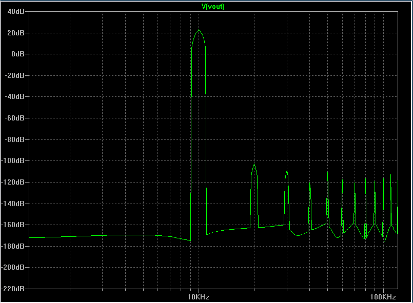

Interesting that just a 2 device VAS can whup them ALL (below- 60ppm @10k 40v p-p). To me and any who have heard it , IT is the "best sounding amplifier in the world" (Blame ES/mongrel BX). I keep this one in my house , i'm hooked 🙂🙂

If it was only for THD, certainly that i would go blameless
style, but other parameters are to be accounted for such
as symetrical slew rate or stability and so on..
True that the blameless fashion has an unbeatable
complexity/perfs ratio as pointed by your graph,
and further, by this one.

That one in the graph is the blameless with a bootstrapped VAS ,TMC, and with input cascode , low noise mpsa18/ss9014 LTP. The strait blameless ran nice and had PPM THD but did not sound as good (most likely CCS related).
