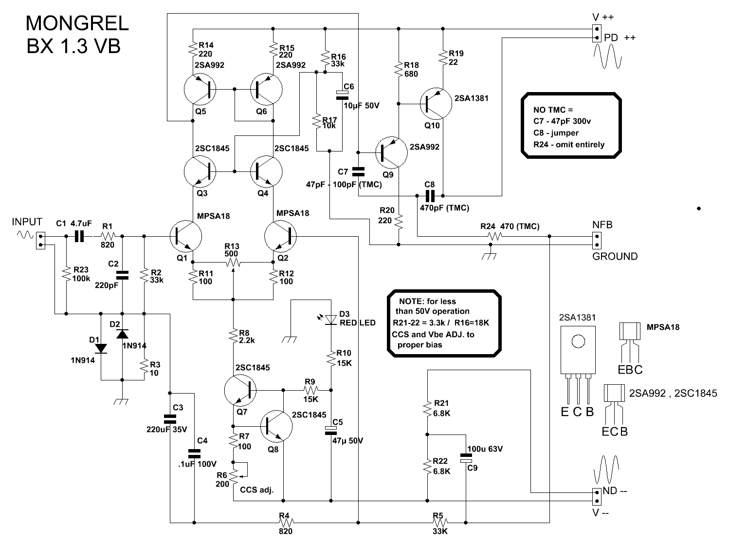

Ostripper - Can you post your schematic of what you believe to be the ultimate amplifier? I'm curious to take a look.
I didn't say that lightly , I will be able to swap the one below out with any of the others within seconds. Don't be fooled by the utter simplicity , it really does do 10 parts per million at 50w/1k. Input device noise is more of a factor than any distortion product in this case.
OS

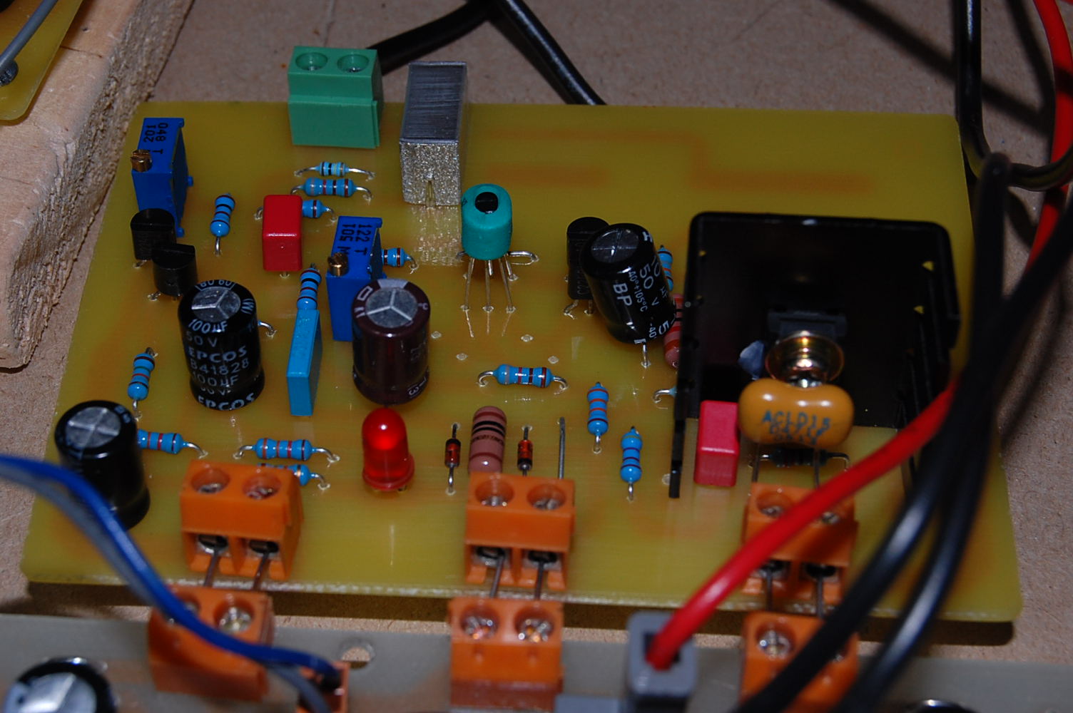

0 percent switching distortion , none of the goldmunds can pull that off. Last attachment is total cancellation of Xover dist. at miller loop ... giving class A like performance.

Ostripper,
What is the purpose of the two -46mv DC voltage sources in your Mongrel simulation files? Without them the DC offset is about -2V if TMC is applied.
/Martti

By bohrok2610 - Ostripper,
Those are to drop the noise floor in LT to -180db. without them the DC offset is just uVolts. I do the same for a fet LTP , except the bias is microvolts instead of millivolts.

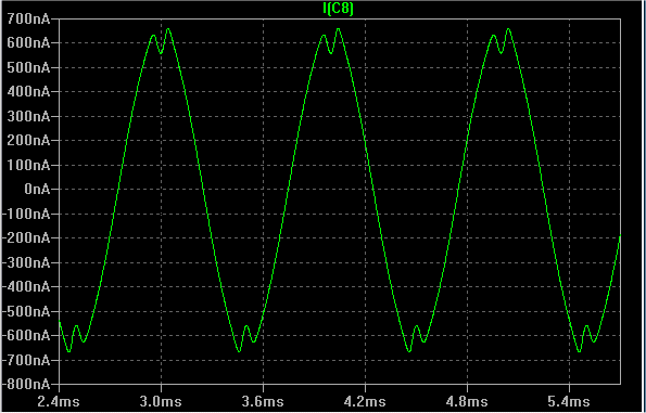

By Miib-Can anyone here tell me how this TMC feedback network works....I can see that the current through the capacitors has a glitch...at the time where the output devices turns off...but how is it balanced and how are the values chosen..??
And for the last question , TMC works as a nested feedback loop , it will take the "glitch" from the Xover region , feed that back to the VAS (into the miller loop) , cancelling out that distortion component. On a real amp , this can be experienced by scoping the OPS with less than adequate bias current. The tmc will compensate for even a 0-10ma BJT OP bias , this can be HEARD!! At the proper 70-80mA current , you approach perfection. TMC will only work with an amp that has a high loop gain (70+ db). It won't work on the original goldmund but will work on the beta enhanced version (keens/mine), and any blameless based amp with a 2 device beta enhanced VAS. (90-100db LG)
The values are chosen by calculating the 2 caps in series (100p-270 to 470p - 1:2.7 to 1:4)where they react the same (unity gain point - 875khz) as a 47-68pF conventional miller cap. I chose the feedback resistor by .step 'ing the value for the lowest THD PPM-(.step param rtmc 200 800 50). TMC works much better than the conventional 2 pole compensation as it includes the OPS in the feedback loop. 😎
Warning , these tricks might make your amp sound "sterile" , whether this is a good or bad thing would depend on your source(s).
