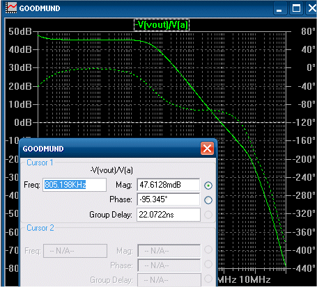

VERY stable , very linear (full wilson w/mpsa42's)
2.8mA LTP ,6ma VAS , 100mA lateral bias.
.05% thd 20- .01% 1k /40v p-p (Bode is below).
60 volts for OPS and 80 volts for LTP/VAS like Nico recommended.
all is better now. 🙂 Focused 😱😱 Have stayed true to the original.

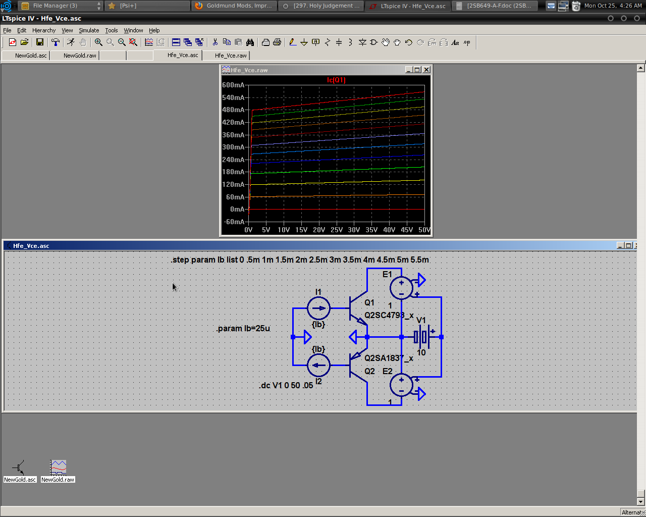

Hey OS, Hfe linearity doesn't matter much for the spectrum in simulation, as I have found, until you get really low distortion. I think Hfe-Vce characteristics are more important, and SPICE models this rather generically (at least the models do - I will check this out).

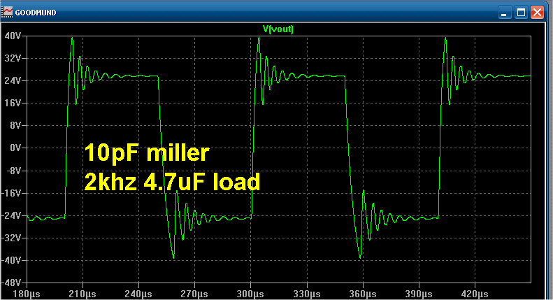

OS, youi have already modified the amp without telling us why. (I am asuming the get better phase margin). Dump the 8 ohm load and replace it with say 5uF and run another plot to check if it is shunted into oscilation. Post it so we can see.

Nico, in my experience the exponential Vbe is more responsible for distortion - just look, every transistor has to have some sort of resistance across it's Vbe to bias the preceding stages, and if not we're basing the entire circuit's linearity on one or two junctions in the differential/LTP. In my experience the nonlinearity coming from the nonlinear bias with output across this resistor is more than that of the Ib, as long as the transistor is operating in its linear range.
I was not talking about the Hfe-Ic curve, I was talking about the Hfe-Vce curve. This curve is one of the things which makes transistors unique, and it is also not modeled, and it's impact on harmonics not seen in simulation.

Below is 4.7uF load w/ 2khz SW. Damped ringing , not outright oscillation.

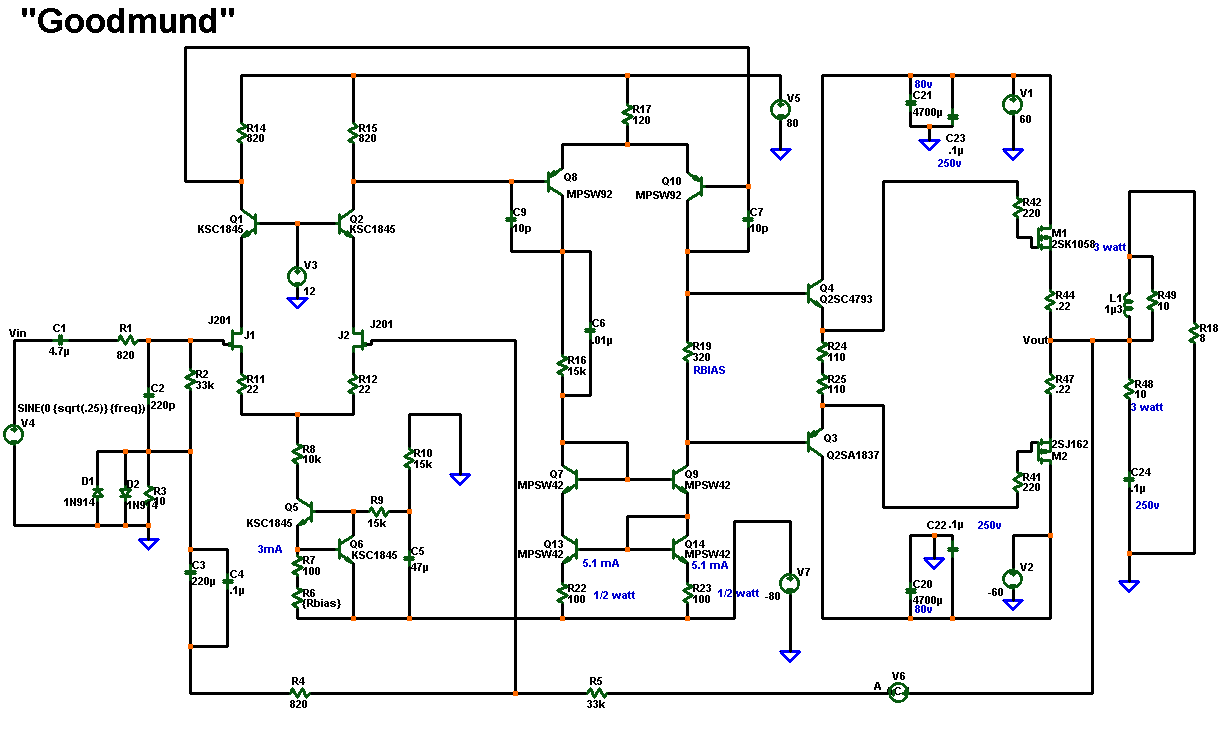

OS

Good idea lets see what we have got. Problem is going off in a tangent is to easy. OS post what you have, both original and our design. Lets discuss the merits and disadvantages then settle on an outcome.

OS this is already pretty pleasing, that means there is no instability per say, ringing is underdamping, this can be fixed, but not now.
Worse case is about 2uF in series with one ohm. We are okay. Lets move on. OS publish the current schematic so all are on the same page.
Kean now it is time for your comments regarding the VAS.
