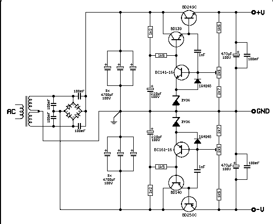

Can you post your regulator schematic that includes input power transformer, rectifiers, caps, transistors, diodes, Zeners, and resistors for both plus and minus. I want to make a schematic diagram for Alex to go by or maybe layout one too.

good work , Keen . I like "octoposts". We HAVE to agree on something. I personally like the beta enhancement , it reduces THD by a factor of X100. I went back to the original at Nico's request both to see how good that design could be "tweaked" and to see what all the "fuss" was about (goldmund thread / untested groupbuys). What I got was just about the same amp as the original plus the better wilson mirror on the VAS. I am satified with .01% and H2/3 dominant distortion. Adding the 2 beta enhancement trannies is interesting to me and I would add this to the voltage board as an OPTION (jumperable) ,... why not? Purist's obliviously would go with the groupbuy and build something fully untested , I am not that dumb. 😱 This is why the separate voltage stage with all the OPTIONS is the only way.
Bandwidth - I KNOW my input filter restricts BW. when I stated over 500K BW.. that was without any cap !!!
I was wondering whether someone would notice my omission of the basestoppers ... you did. I did this for the sake of the transient tests. In my exploration with OPS stability , (trouble with triples) leaving them out sometimes will be the factor that will "make or break" the stability of the OPS.
Below is the simple goldmund (goodmund) LT file which is set to 100w/10khz (.02%) with the new 2sk389 fet's and 2SK/J LFET OP models. as far as C6 (yammer , yammer) #1 . it is included in EVERY other commercial design with a similar topology (Why ???😕 ). I have found you can omit it with NO effect on the REAL amp (supersym 1). just another OPTION. (leave it out,dang!!)
PS.. Goodman device models are in included "mongrelmodels.txt" Also , consider the "ease of construction" factor. The original is a "nobrainer" , good for an easy , flawless build. (my supersym worked first time, 2mv offset - ran it for 15 months afterwards)

Umm... As far as I can figure out, the logic here goes something like:... as far as C6 (yammer , yammer) #1 . it is included in EVERY other commercial design with a similar topology (Why ???😕 ). I have found you can omit it with NO effect on the REAL amp (supersym 1). just another OPTION. (leave it out,dang!!) ...
A) The Goldmund does not have a cap there.
B) Adding a cap there serves no purpose.
but C) We're going to put one there anyway because some other amp with a similar (but different) topology had a cap in a similar (but different) position.
Am I missing something here? I don't see how adding a random extra part that serves no purpose counts as an improvement.😕

As I said , leave it out ! I Have(had) the real amp ,It makes no difference. Not "some other amp" , but all of them.
What's different is Goldmund's compensation at the VAS. I will leave the extra pads for ALL the compensations , but I know from actually having this amp in my house for 15 months what comp. I will use. Who is to say , Goldmund ... a company that uses an outdated grounding strategy and sells overpriced amps , just added those 4 - 4.7pF caps to shunt the VAS as to prevent catastrophic oscillation ( a freakin' "bandaid"). Trust not the goldmund , a company founded by a snake-oil salesman marketer , not a designer.
PS , my personal choice is just 1 - 15-22pF silver mica for C7. Compensation is an "art"... 🙂

I suggest that you simulate these regulators with small and equal input and output capacitors to see which one provides the lowest output impedance vs. frequency. Might also want to look at line and load transients for obvious reasons. I'm not expecting the best results here.
Definitely bigger than that hammond. 20va or bigger ,PCB mount is OK, each voltage stage will draw @ 20ma max. I measured my REAL working voltage stages - 16mA V+ and 19mA V- goodmund is biased at the same 6.5mA VAS , should have similar current requirement.
Wait ...philtron has just the one .... 30VA Power Transformer
30VA/ 250mA/ 120V CT will give 88V rails , enough to negotiate the losses of Nico's "shuntaplyer" regulator circuit. 😎😎
PB , we don't have to use Nico's .. we have the whole salas thread , and a million other shunt's out there. i was just doing the preliminary and sourcing a trafo. Me and Keen will sim the "bejeezes" out of the best contenders.
