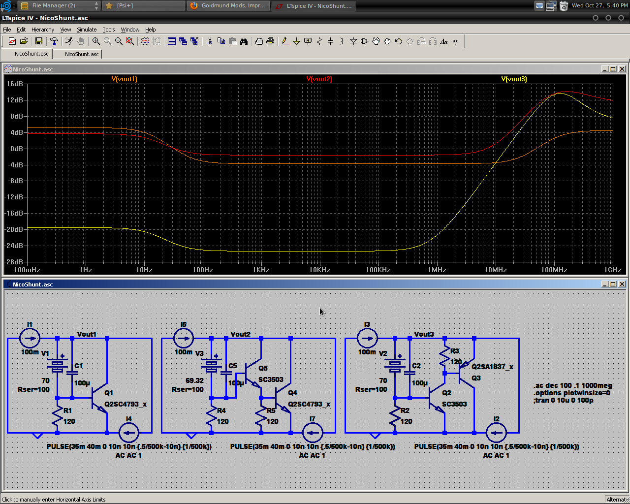

Krisfr, usually when I see something as simple as Nico's shunt I consider it a conceptual schematic for learning. I wouldn't use it in real life when a few more components would greatly improve specs. I don't doubt it still sounds good, but I think we could do better.
For instance, look at the huge improvement from just adding one transistor. Zout goes from .6ohms to 54mohms, comparable to good electrolytics. How about a challenge? Who can get the biggest performance increase only by adding one transistor to this new arrangement?

Jam, Increasing C1/C2 by a factor of 10 will improve bass performance, but now that I think about it, if one can suitably bias the Zener, increasing R1/R2 will have the same effect without needing a larger cap.
At HF, the cap's own resonances will show up in the shunt's output impedance. Bypassing, especially with a film cap, is likely to cause ringing if the large cap has low ESR. It is best therefore to not use a low-ESR electrolytic, if you are going to bypass it. I know others here have more experience than me with this, they should be able to elaborate on the best options.
Nico, LTSpice calculates the AC characteristics automatically after performing an operating point solution. It's not like DOS, man. 🙂
However the single-transistor version will have approximately the impedance of a diode (which changes with current), and the second will have the same impedance divided by the current gain of the PNP/resistor combo. Am I right?

To elaborate, Nico, LTSpice's AC analysis is a graph of the response of the circuit's output to the stimulus of the load, which is either I2 or I4. The AC stimulates in units of 1A (calculated from the theoretical AC response of the circuit based on the modeled reactances, excluding nonlinear transfer changes not included in the operating point solution), so because 1A is assumed the voltage measured at the output tells us the exact impedance in ohms.
- keantoken
Here it is.
Performance actually decreases, because the Gm of the master transistor is added to that of the slave.
However less drive is required, meaning less requirement placed on the cap. I will simulate next with a 22nH, 70mR cap (realistically ESR for a high voltage cap like this will be much higher, but this is worst case).
- keantoken
