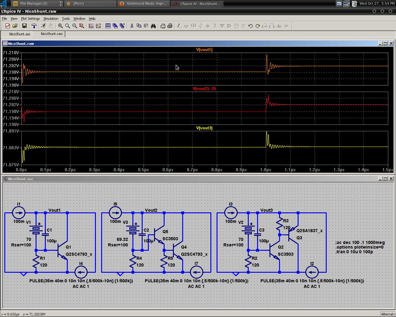

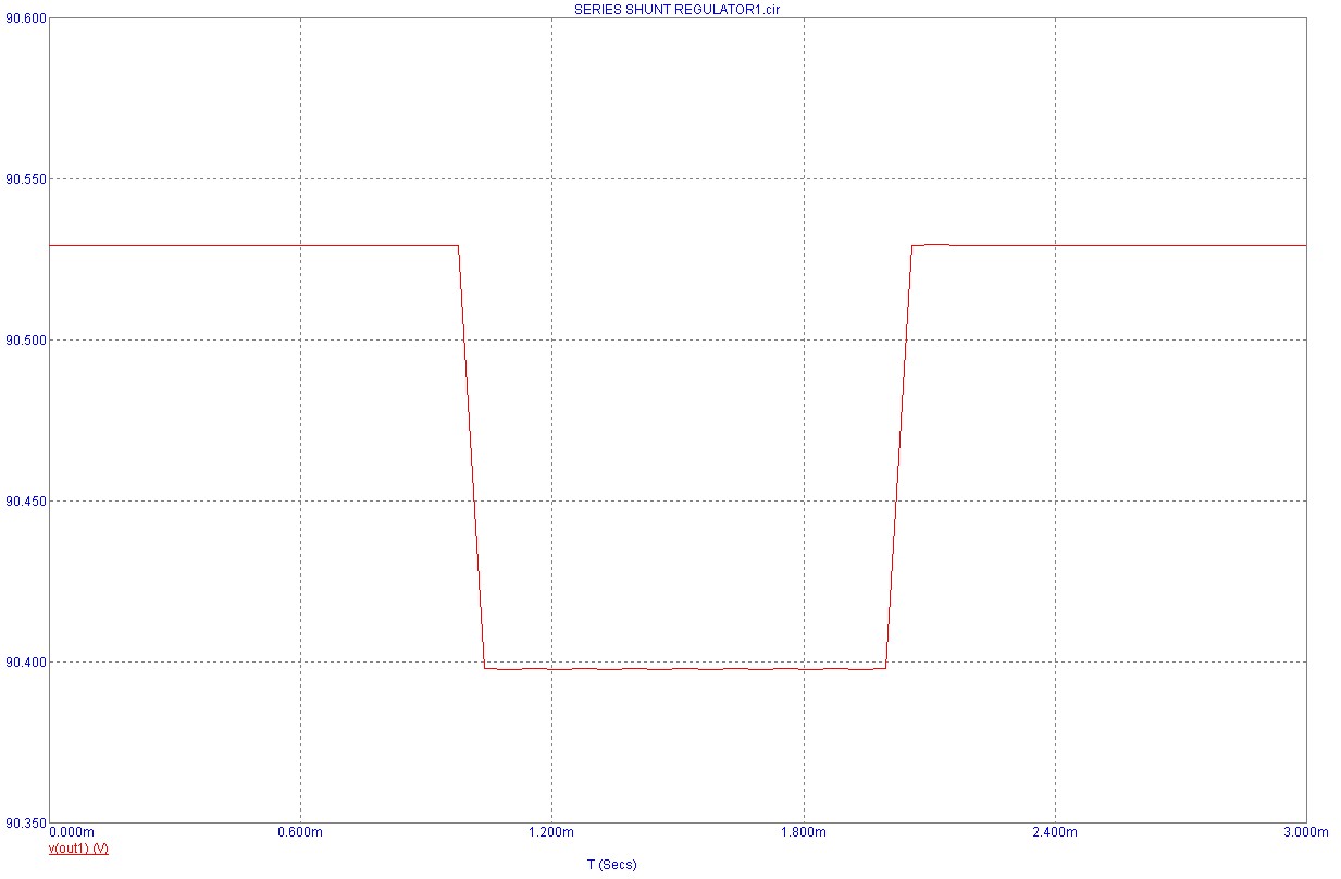

Here are two plots. The first is the output impedance plot using the reactive capacitor, make of it what you will. The second plot is a somewhat more useful pulse behavior plot.
- keantoken

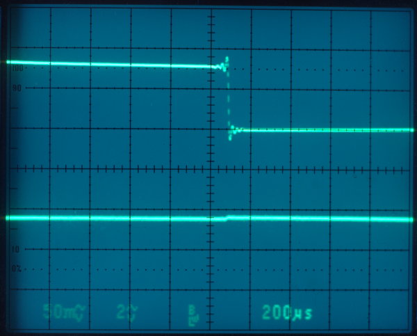

Gotta make and measure. There are many layout, passive parts, and cabling imperfections stuff that will affect step response. Models, hmm, gotta prove their varying quality of accuracy when time subtleties are examined. Here is one pic from an early V1 LV reg of mine as measured by an American member. Top is a transient pulse load, bottom is the DC output reaction. This one is very near to the SSHV as a configuration BTW.

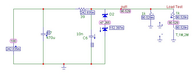

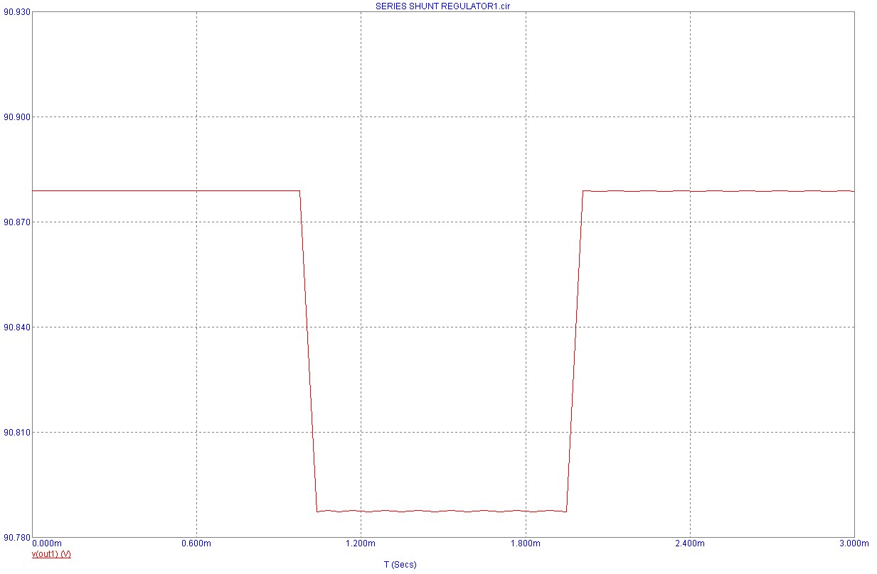

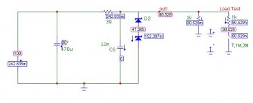

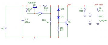

So what does this prove? Circuit 1 is as good. Here you can see a schematic closer to the real world and load switching between 1 x load and 2 x load. You still have not given an indication of how you derive the impedance looking into the circuit. If you do not know how then why is it important?
I get the feeling that the more complex the better it be.

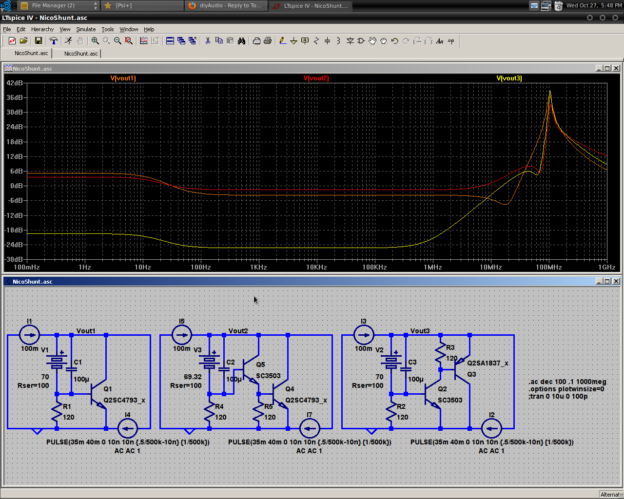

Nico, impedance charts and response graphs emphasize different things to the mind. You can see that the pulse response for all three is about 20mV, nearly all the same in this respect. This is because of the dependence of operation on the cap, which is the primary cause of resonance. The cap has the same response in all 3 circuits. What you may not have noticed is that version 3 has much better DC regulation.
BTW, I use a pulse source with a 10nS risetime, pretty darn fast. Salas, your scope is set to 200uS/div. That makes your risetime several tens of uS? Any reasonably fast circuit won't look bad in this test. Nico, your risetime must be in the hundreds of uS, even easier.

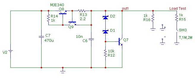

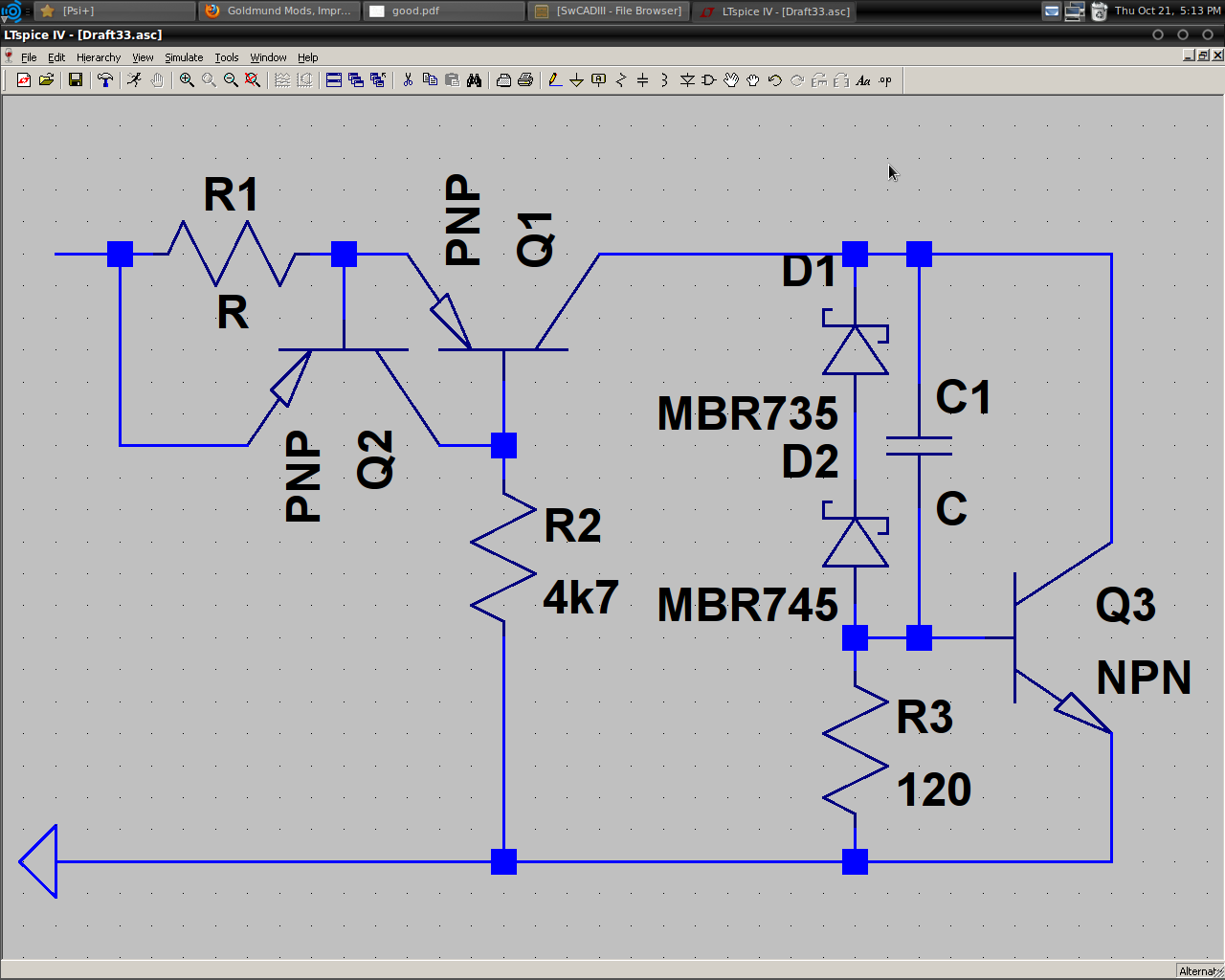

Also, your CCS is sub-optimal. Current will vary with input voltage. Use the CCS arrangement attached.
I don't know what you mean by "derive impedance". Is it more complex than Ohm's law?
For HF behavior, I think number 2 looks the best. However consider that this is the circuit with the highest impedance. It is easy to make a bad regulator with excellent pulse response - it's a resistor!
If we want to improve pulse response, we need to find a way to dampen the capacitor. After that if more is desired, we would need to cascode something or otherwise thwart Cob/Miller parasitics of the transistors. I think the shunt is already pretty good, and minimal enough to go on the board without much complaint. If we make it complex, it may take up too much board space for those who want to use something different.

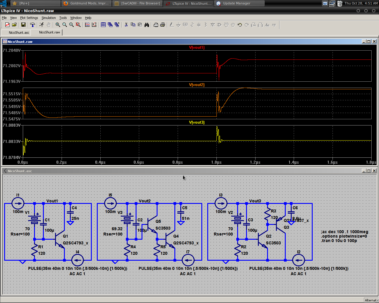

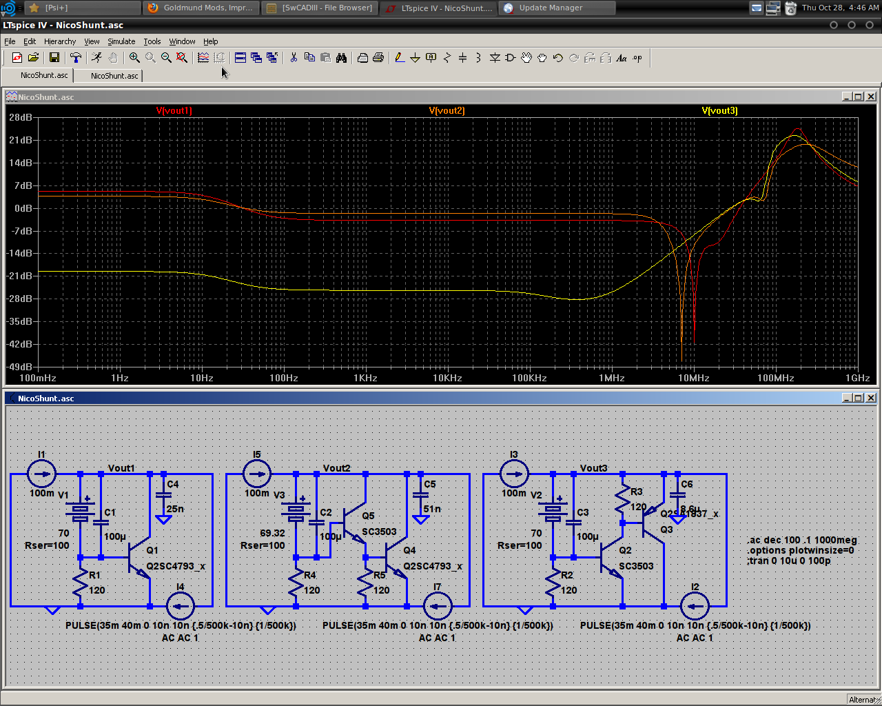

Godfrey, I intentionally simulated without this capacitor to reveal the circuit's true behavior that no cap can fix. Here are simulations with appropriate decoupling.
For the first two regulators, requiring minimal decoupling, the caps used are 10nH, 2mR. The third regulator is decoupled with an electrolytic (15nH, 100mR).
Now that HF behavior is more controlled, we can see in what ways circuit 3 stands out.
- keantoken
- keantoken
That test was done by member jwb on March 2009 on a breadboard. He mentioned ''Transient performance isn't bad either. The top trace is the load signal into a 62R load (about a 25mA load step), and the bottom trace is the regulator output.''. More I don't know.
I don't doubt the circuit has good performance if it is related to SSHV. But to see the circuit's response better you need a faster source risetime.
