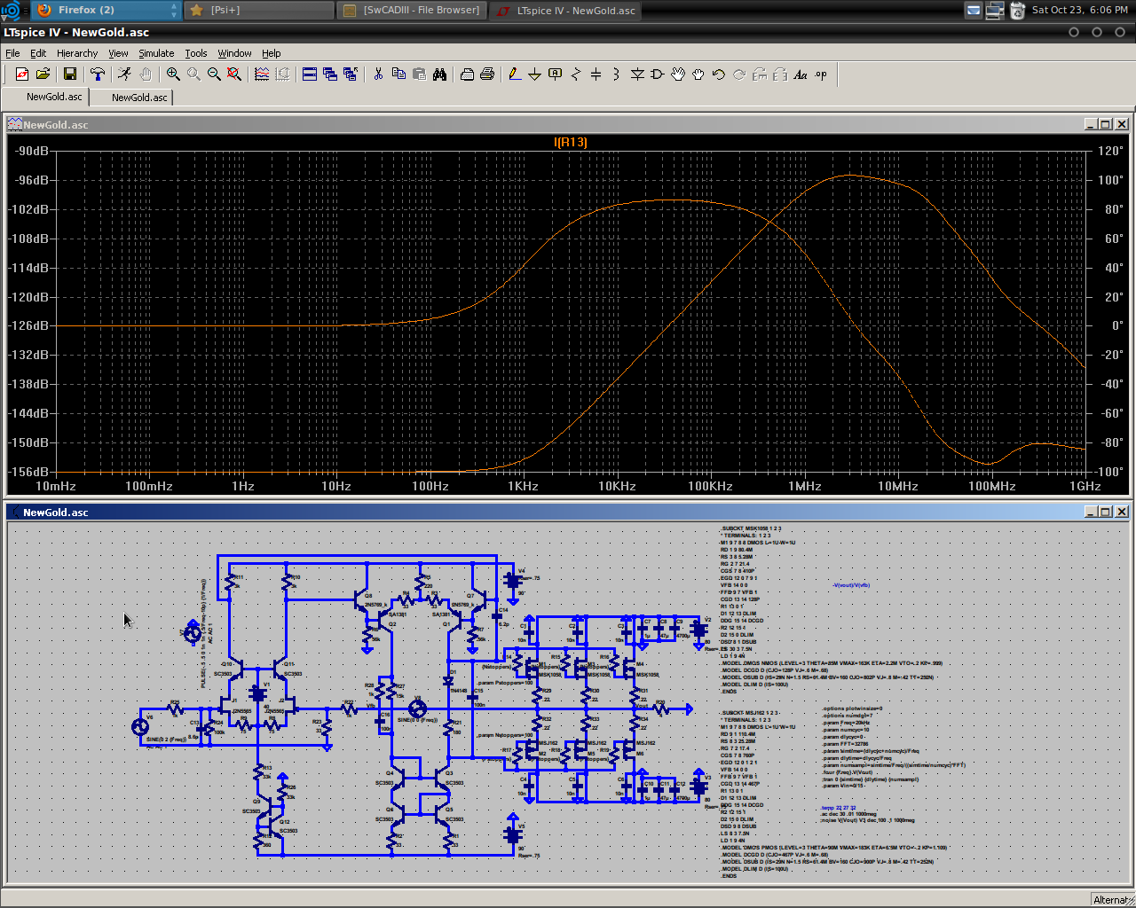

in what way does the bootstrap outperform the CCS. What were the design objectives against which performance was measured. I cannot even figure out what is being simulated, let alone compare to see how and why there is such a discrepency in preformance, what performance?
My personal feeling is this thread will soon just die, instead of going forward it goes backward a few steps, then everything starts again. Why don't we place the circuit right side up it outperforms up side down.
Get some direction guys and come to a definitive conclusion. The guys next door came and see what we are talking about and already implemented it on the PCB.
The AC current of the tail is measured, and the lower wins. That is what was plotted

Why does the lower one win. Make it zero then it wins hands down. Why is a lower tail current important. For extended bandwidth and low distortion you need a high tail current. So I take it that you run the diff pair at nano amps instead of several milli amps. Can you tell me why?

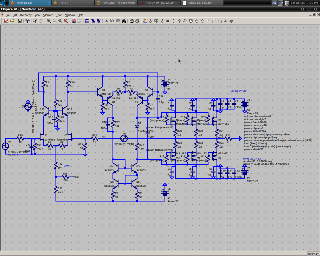

The circuit can be scaled down, as follows:
1: Adjust R6 and R7 to keep <2mA through Q8 and Q7.
2: Nevermind, keep tail current at 2mA, if you want to change it then ask.
3: Normally in the Goldmund the Jfets are at about 30V. This can be adjusted by changing R35.
Nico, the bootstrap performs better than the CCS, if you use precision resistors in the feedback and bootstrap networks. Some would prefer it.

Nico, I'm not sure what you mean about changing LTP current. In both CCS and bootstrap simulations, CCS current was almost exactly 2mA.

I don't think 2ml is enough for fet differentials. Why don't you up it to 4ml and see. I think we re making a big mistake removing thr current source as Nico says and at this point would probably hurt this thread.Also the current source as impledmented can be vastly improved quite simply.
I think we should go back to Krsfr's circuit and decide drivers or no drivers but does not matt much if we design the board with drivers as they can be bypassed if necessary.

Jam, if that's what it takes, I'll bring back the CCS. However, the bootstrap if used with precision resistors is more than adequate, and quite possibly better than a CCS, especially for a high-speed amp.
What Jfets should I use? I'll try MiiB's suggestion for the SK170's, 6mA 12V.

I would use the 2sk170's at 6ml I have used as much as 8 cascoded at between 10 to 15v.
