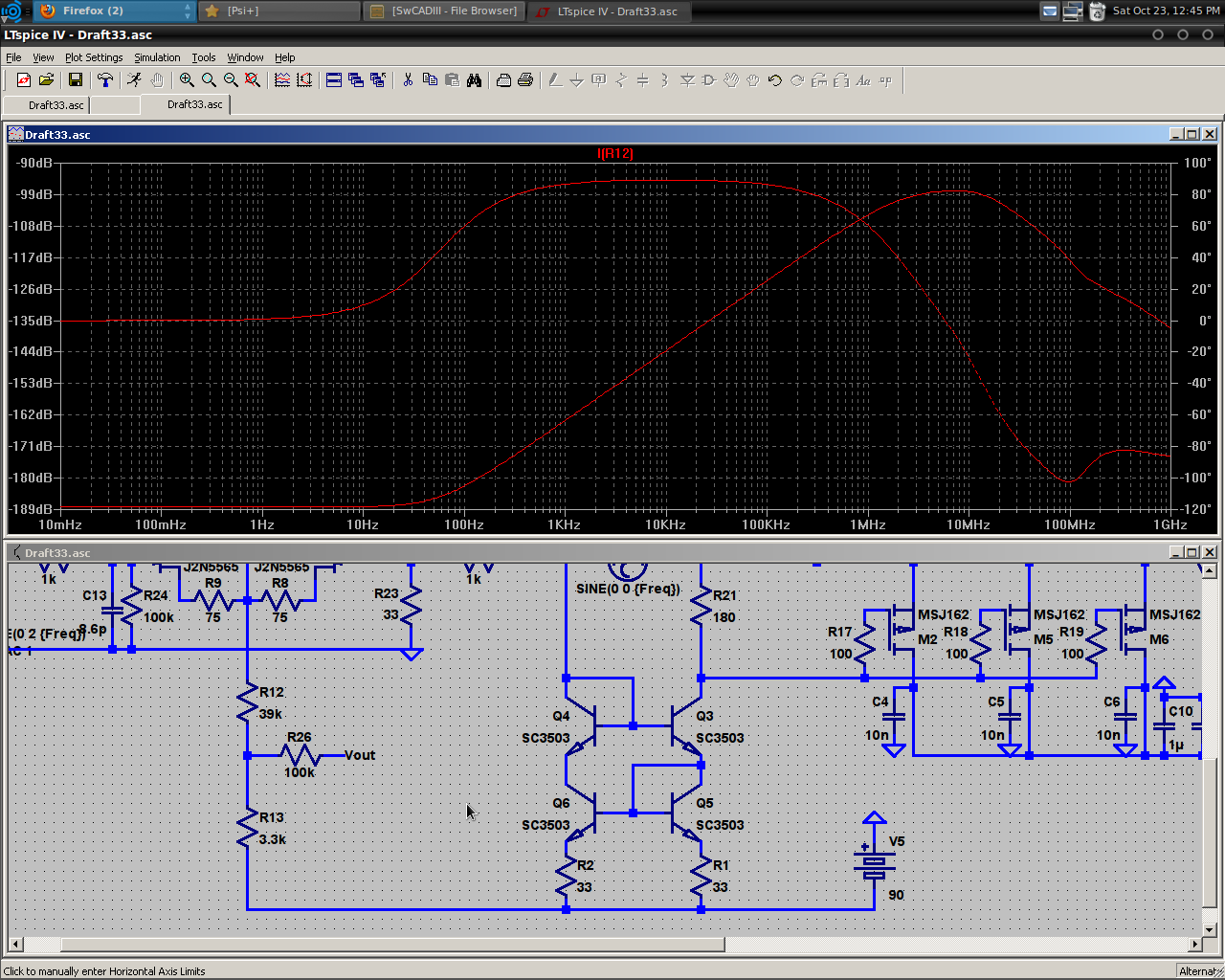

Actually, using a Jfet CCS decreases slew rate, because it keeps the VAS balanced, meaning one side can't draw current through the tail to compensate for the other being slow. Symmetrical slewing isn't improved either, contrary to my thoughts.
Next, not using drivers means that at max slew behavior the VAS will be saturating into the FETs. This does not bode well for TIMD. Can someone speak of how the sound changes when using drivers or not?

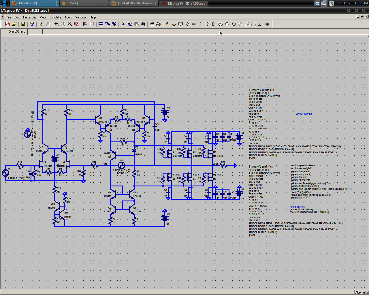

What are you simulating????? Have you read anything?
I have read every post up until now, what am I missing?
Here is the schematic I'm simulating. I tried replacing R5 (tail resistor) with a Jfet CCS. The Cdom connection is... Experimental.
- keantoken

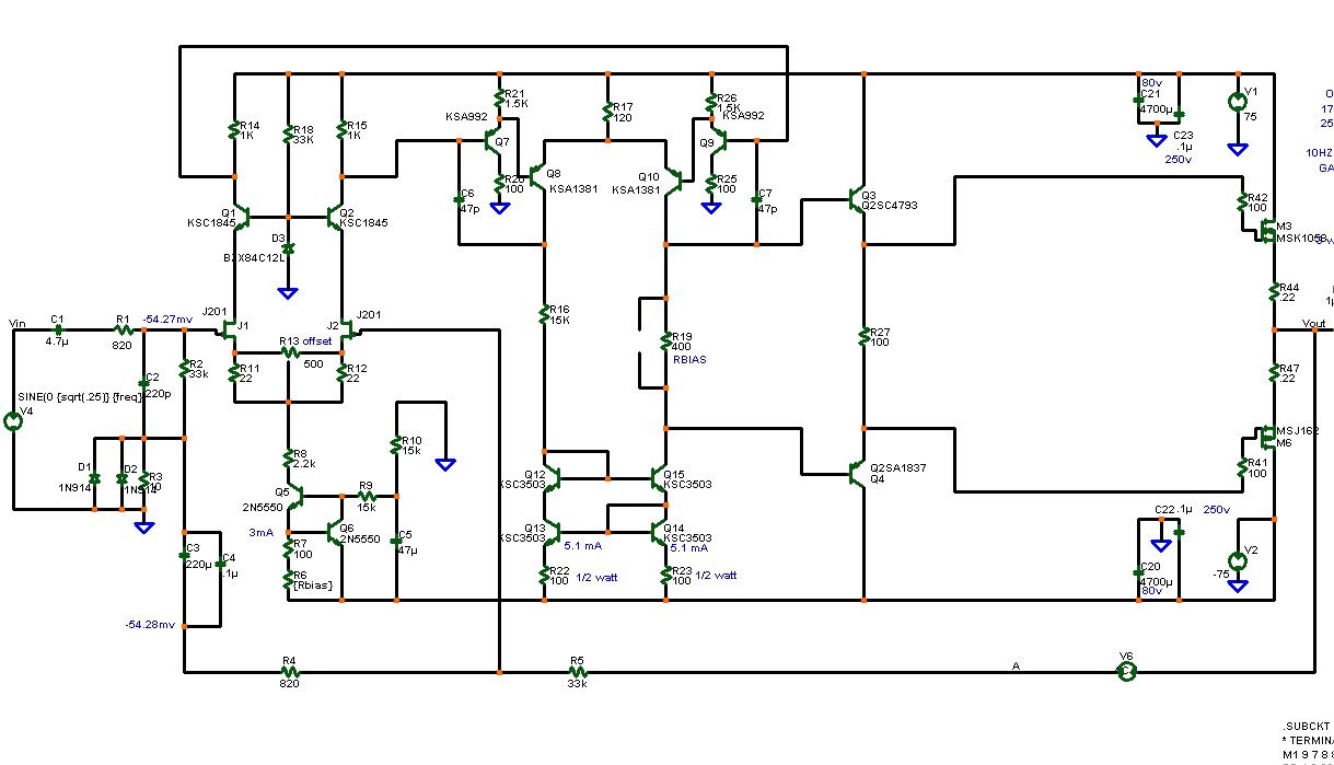

I successfully pasted the lateral models but they bias "funny". V mosfets (irf's) need several volts to be forward biased ... these L fets .. I can't get to stop conducting. Here is what I have below. Works good , but the bias is "screwy". 🙁
