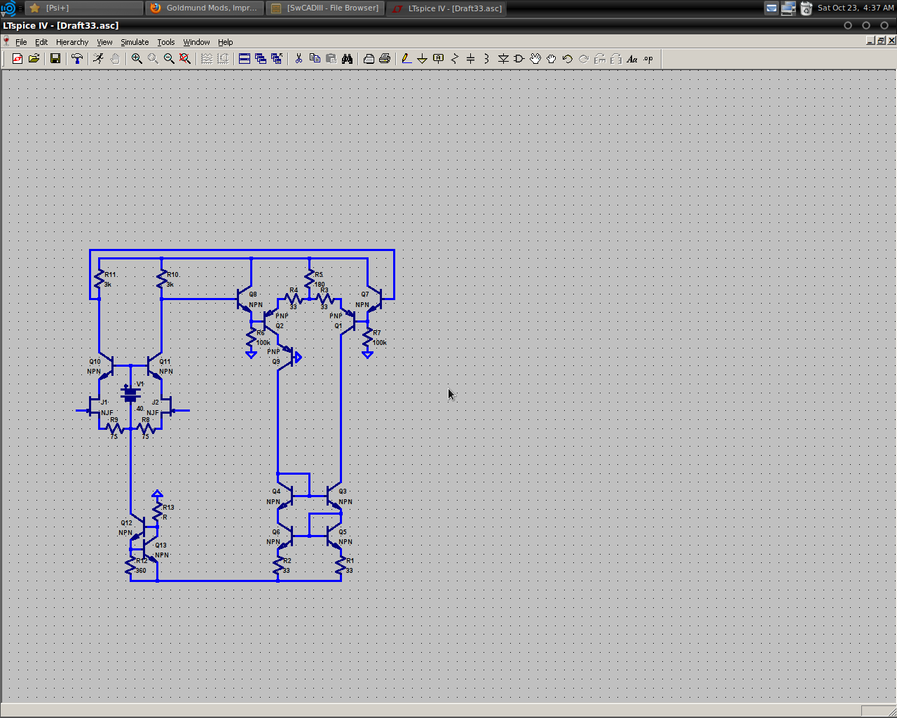

I will be more than happy to update the schematic. Can we run a simulation?
IF I can get all the right parts in the Schematic, I "THINK" KiCad will run LTSpice. NOT sure but I will give it all a try.

Kris, that schematic is very unfinished. Where do Q8 and Q9 connect to the input LTP?
Q1, Q2, Q36, Q37, and Q38 are all wrong. C4 and C34 should be across the diodes, not the resistor, and D17 and D3 should be zeners. Shouldn't input ground go to the top of D7/D8, not the bottom?
Attached is how the shunt reg should look, pay attention! *cracks whip*
- keantoken
Kean:
Please Flesh out these regulators, I am not sure of how the both should be laid out.
I need a little hand holding on this, never seen this configuration and therefore am a little uneasy.
Give me the values of all parts you say are not right...and anybody else got some values, lay um on me. I am here for the next 4-5 hours and I want to put this to bed tonight. I aint Russian but YOU know what I mean...
Thanks...

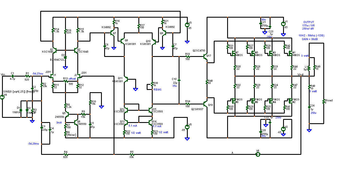

I just got KICAD (learning it), What have we decided on a final circuit ... one like this ?? (below).
I am all for the drivers on the main HS. a small heatsink for the VAS (all 7 devices thermally coupled ). any other ideas.... I am about to create a 6" X 4" (150 X 100mm) draft.

Absolutely stunning , Nico. That is like my PB250 BJT type layout .. it works well and is easy to implement. 😱😱

With or without , no difference to speak of ..THD/FFT. In the real world , the laterals gate capacitances would interact with the Cob of the VAS devices. This is where you would actually have to build it to find out. I have seen this with my first amp kit in the 90's .. it worked and sounded good but the VAS was VERY HOT (20+ ma).

Here are my final comments regarding the amplifier, and no I don't think we are cloning ELD, I think we are developing an amplifier that uses the best of the two designs in order to achieve a performance that will be better than each on their own.
Front End.
Although you have made the right decision on the front end I would like to throw in another two pennies worth.
I have a feeling that using the DC coupling and FETs stands Goldmund in good stead regarding to sound. If one considers that there is no phase change in the bass region (unlike capacitor coupling of input and NFB) may just be why their amp sounds good. At low frequencies our phase perception is much more acute than at higher frequencies.
VAS
The ELD driver using medium power transistors and double Wilson performs better than small signal transistors followed by a driver. It is more linear, easier to compensate.
Output
I would insist that those wanting the most out of the amp uses four pairs of devices with source resistors. Those wanting 100-120 watt can omit two pairs.

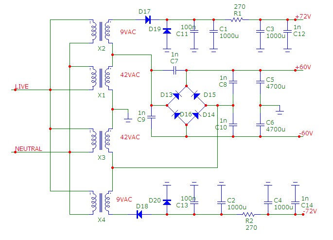

Power supply Front end
I have done some listening on my class A headphone amp and HD800 cans, using both a shunt and a series regulator. The shunt regulator sounds healthier, don't ask what that means, it just does.
The front end should be run at 10 -15 V higher than the output stage. For this we need a small transformer of 0-9, 0-9 V (two secondaries) and about 10 VA or so feeding a full wave bridge and followed by at least 1000 uF series resistor (filtering) and another 1000uF cap rated at the operating voltage you choose, followed by the shunt regulator.
The secondaries of the small transformer would be connected in series with the secondaries of the main transformer, thus would always be be 9VAC higher, no matter what main transformer size you choose.
Main power supply
We know that lateral mosfets will only swing around 10V from rails, unlike BJTs therefor the need to run the driver stage at 10 or so voltage higher so that we can get close to rail swing on the outputs.
This has the advantage that we do not have to use an 80V supply to the output devices and it can be dropped to a more manageable and available 65V rails (or lower if you like) The transformer will be more cost effective and if you choose correctly 63V capacitors will do.
Interestingly enough and you can go try it practically, the reservoir caps used for the output stage does not have to be mega farad, you need enough energy to cater for the loudest and lowest signal, hence a 4700 uF capacitor sounded nicer and more fluid than the 40 800 uF that I was using.
I hate hacking equipment that I am using, but I did it for the sake of offering advice. The front end is regulated and that is where it matters most. The amp also sounds more dynamic. Much better than using a regulator on the whole amp as I have been doing.
I hate adjectives but unfortunately thats how we communicate. Therefore dump my use of a regulated amp, it is a waste of money.
I would further use two toroidal transformers with a single secondary for each amp. and mount them on top of each other. Feed the primaries anti phase so that any stray magnetic fields cancel. I do this always else you will have problems with these large transformers near the circuitry.
I have never done this, but it may be possible to fit the transformers into a cut-off coffee tin and pot them which will reduce mechanical vibration and the mount them onto the chassis using a rubber insulator or something similar to decouple them from the rest of the amp, maybe even another box.
