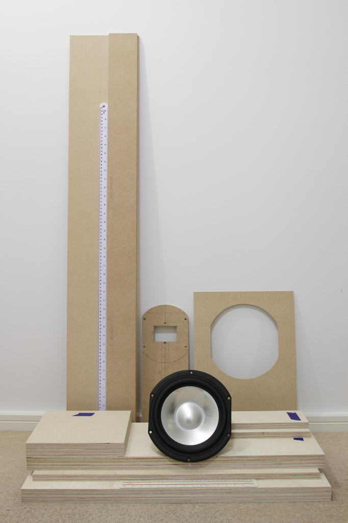

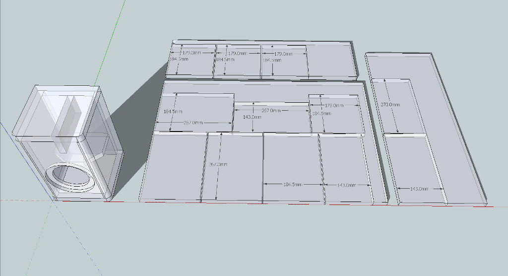

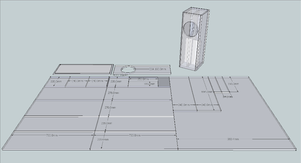

The decision was made to first build a helper woofer for my FH3 with A7.3s, utilising WinISD beta & Sketch-up arrived at a basic box design for a pair of 8" Peerless P835026.

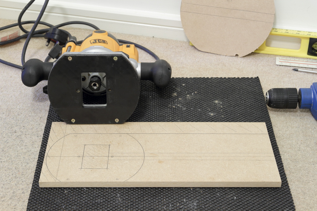

I've personally never been very adept at working with wood, but wished to build these from scratch. A few You Tube tutorial vids latter, I had a straight edge for the circler saw and the basics of the cabinet cut from the 18mm BB ply...
I've slowly collected various tools & router bits to help with the build, been given a 1500Watt Router and am currently working on making various jigs and templates to help finish the speaker build.

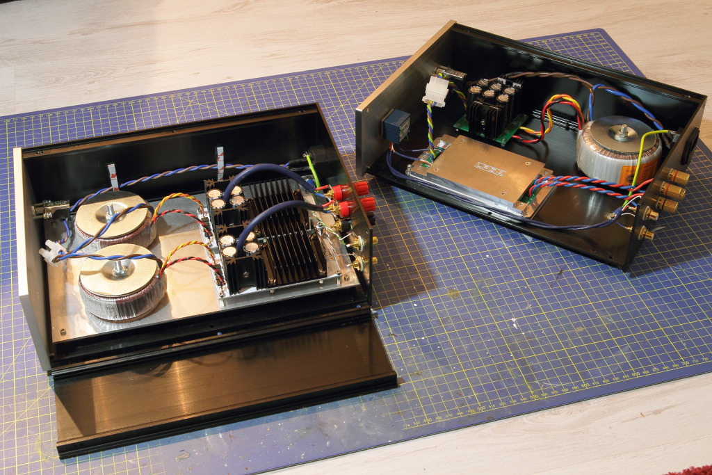

To add to this, I've just finished building a second amp and am waiting on an order from miniDSP for the active 2-way... Once this is all set up I hope to make a pair of mMarS for A7.3 with the left over BB ply 🙂

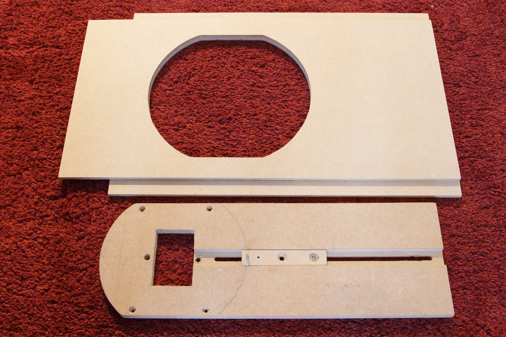

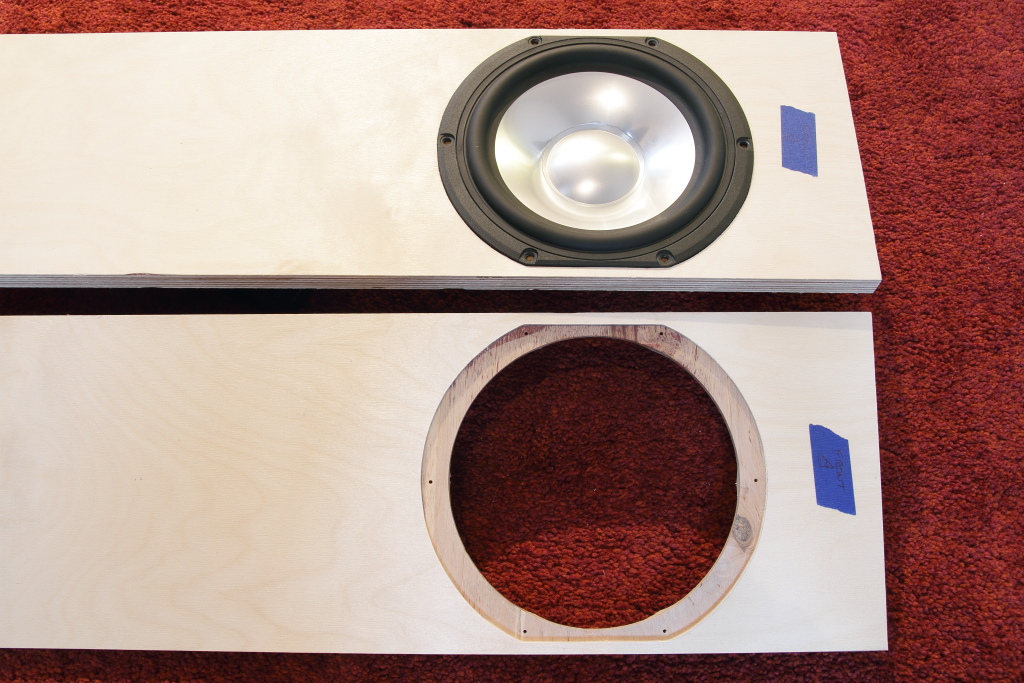

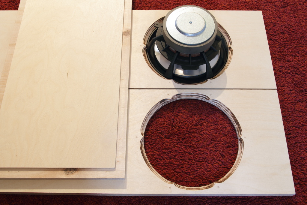

Over the last couple of mornings I've been able to make some progress once more. Last of the components needed to finish making the jigs arrived and cutting commenced ... I'd like to add this is the first time I've used a router & am quite pleased with the results 🙂
1, adjustable circle jig & speaker rebate template
2, 3mm rebate and a nice fit
3, chamfered backs and rebated side panel

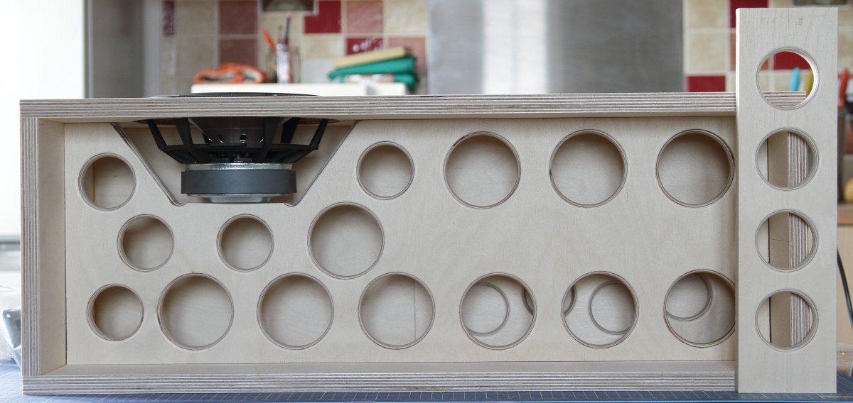

A touch more progress on this first build... Saturday & Sunday gluing things together. Sunday and today marking centre points, drilling holes and routing, just about to start gluing again.
Internal bracing is a snug fit with ~1mm gap behind the driver before it's fastened down. One full length front-to-back brace and two smaller side braces, all will be set off-centre...
