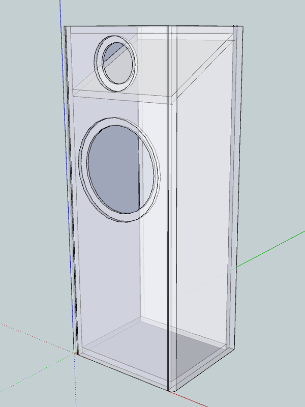

Hi guys and thanks all for the responses ...
I'd previously thought about separate enclosures for the FR & woofer. Apart from being able to face them in different directions I wouldn't have much space to play about with placement within the room. So, two drivers in one cabinet.
After reading your comments, I realised two things; 1, The side mounted woofer isn't the best way forward. 2, Unintentionally, I'd got my thinking the wrong way round regarding the use of the woofer. I wanted to get a higher XO point, offloading some of the work to the woofer. Instead I was forcing myself to use a lower XO, gaining little.
Didn't fully appreciate that the woofer acts as the BSC ...
So switching tacks... Both drivers on the front baffle, same sealed box volumes [6.41L & 70.64L] and aim for an XO around 250 ~ 300Hz. Again, it'll be active XO & EQ.
Will load a sketchup when the add attachment & my internet connection allows it 🙁
Sketchup with both drivers on the front baffle ... Baffle width is 14", f3~320Hz. The woofer would allow a minimum 12" baffle on the front, any larger than 14" the FR enclosure would need to be made cubic or as a separate box entirely.
Paul.

Apologies for side-tracking this thread, but I have a question that probably doesn't warrant a separate thread:
Does the term FAST only apply to a full-range driver in a larger cabinet, with a helper woofer in the same cabinet, or can it also be applied to small full range speakers with an external subwoofer, i.e. a sub/sat configuration?

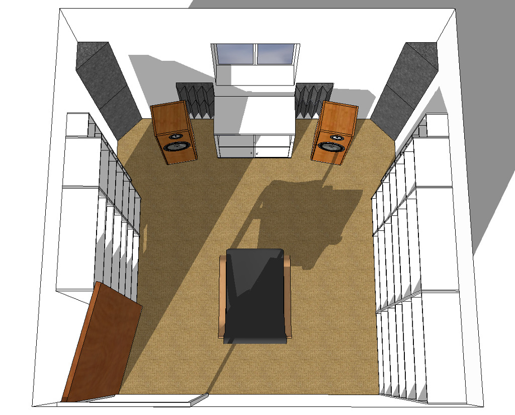

Brief Update
It gets pretty boring saving money, loads of ideas but just have to be patient and wait... Plus prioritising which bits & pieces to get first.
Seen a few tantalising bits about the new FHXL and can imagine them to be amazing sounding speakers, but think this route may be more suitable to my needs.
Whilst waiting I've been playing with Sketch Up a little more and thought it'd be nice to see how the proposed enclosures would sit in my room ...
Paul
