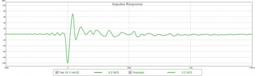

Wired one of the 8" woofers last night & this morning did a quick set-up & measure with REW and the miniSharc. Measured woofer & FH3, XO ~250Hz... this was done in my livingroom, which is 3.4m x 6m. PEQ was implemented on the input side only.

impulse response
Only listened in mono for about 1 hour, but does sound a lot better than the FH3 by itself, everything sounds clearer and bass has greater extension 🙂

impulse response

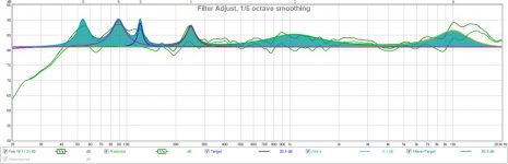

I'll do a screen grab of the filters created by REW. Something like 98% of the speakers' output was above my target SPL, so all the filters were negative IIRC. I've not listened in stereo as yet, so don't know if imaging etc has been effected.

Had a fairly good starting point, with the woofer giving the poorer response. Measures were taken so the room had [hopefully] little impact on the results... Set target level to 81dB, ~89% of the response fell above this so all the filters were negative gain. Max combined gain on the peaks is -9dB.
Before & after. XO in place on both measure...Woofer XO 200Hz BW 12dB/oct, A7.3 FH3 XO 270Hz BW 18dB/oct.
From the initial results, set REW for max individual gain 6dB, max overall gain 3dB and match level 3dB.
And then transferred the resulting filters to the miniSharc

I think your EQ looks very good with nothing extreme in the telephone band. The broad negative EQ at 1.1kHz is probably fine as it is so wide and needed for baffle step it looks like. I am surprised how much zing the A7 has above 10kHz that needed to be tamed. If you measure the A7 in nearfield (12 in) you can see if there are any funny things going with phase wraps from 500 Hz to 5 kHz that might alter the imaging when in stereo.

I wouldn't kill the 10k peak. It is required for the overall power response. You are looking at this on-axis, but you will listen off axis. Go back and do your EQ 10-15* off axis.

This was an initial EQ, trying to just level the response from the two speakers without countering any room interaction.
They're loud when played in the main room, but will live in a room roughly half it's size. I'll look at re-doing the initial measure off-axis as Bob has suggested, furthermore, I'll use a lower target level [80dB] and a tighter level match [2dB]. Once they're in the room and if needed, a second measure will be done to help with room correction.
