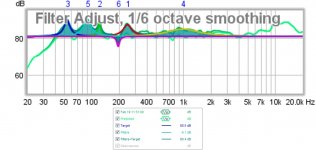

Re-done the initial EQ so it only covered 30 to 1,000Hz... Then applied a second EQ based on readings taken at the listening position & speakers in place. So this one counters room effects. Concentrated on the bass region only 30 to 200Hz. Unfortunately I set the target level roughly 3dB to low ... However, getting a very nice response, with the A7.3 being largely untouched.
Levels shown are at -9dBFS so should be getting ~85dB peak which is roughly what I was aiming for 🙂

Not getting peaks quite like those shown, highest I've EQ'ed now is 1000Hz. The measure was taken 1.9 meters out, mic was same level as A7's and roughly 10* off-axis.
Within the bass region, I'm getting audible box resonance through those 40 & 60Hz peaks. These two areas have the highest level of EQ applied, countering room modes and maybe a slightly too powerful amp. The resonance only really became pronounced with this last EQ, probably overdone it. I'll try lifting the woofer's EQ target level back to ~80dB which will bring it more inline with the A7's and hopefully lower those resonances a little.
After that, I can drop the power of the woofer's amp and re-EQ the whole lot. They're not yet in my listening room, which is to have bass traps & panel absorbers fitted. I hope to get a nice level response without to much EQ.

Am using the miniSharc... both amps are at full power all the time & built without volume controls. FR amp is 4Watt peak output, bass amp is 9Watt peak output. Full signal attenuation is done using the miniSharc's add-on volume/selector board.
I've been measuring in two stages. First, on axis <60cm & used PEQ to match woofer & FR levels. Second, at listening position PEQ for room correction at -9dBFS [roughly max listening level].
With the speakers in an open position, the woofer & FR levels match fairly well. Once they're in place, it looks like there's about 6dB room gain through most of the bass region... I should be able to counter this by dropping the bass amp from 9Watt to 4Watt.
All new stuff & a bit of a learning curve as to correct mic position and measuring levels... went through the same cycle when I learnt how to colour & greyscale calibrate projectors & TV's a few years ago.

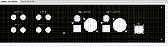

Last few days I've been working on the layout for the front & rear panels of the miniSharc enclosure... I asked for help on the miniDSP site regarding layout measurements for the DIGI-FP and VOL-FP boards. Been a little disappointed that the devteam, or anyone else hasn't replied.
I've been able to find product drawings for the units used on the DIGI-FP and am confident my centre to centre measures are spot on, same with the VOL-FP... Still, a properly marked up drawing from the miniDSP team would be useful.
