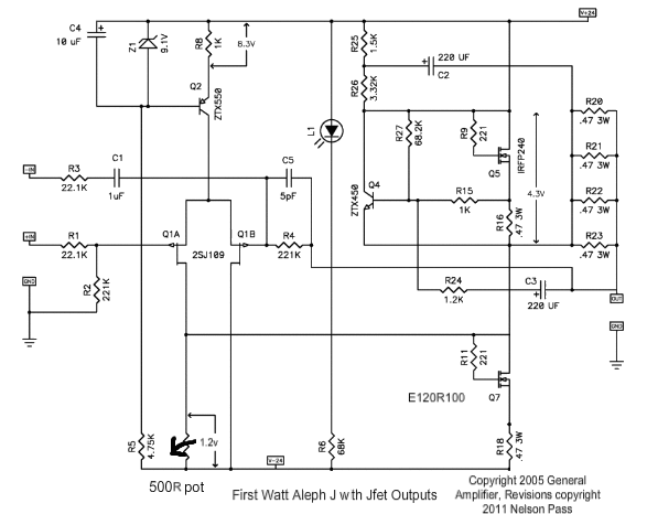

It is a pair of SS.
One SS for one chanel in a stereo Amp.
So I did edit a bit old Aleph Jango schm picture.
Everything correct?
Look here: Semisouth Aleph J?
Ok so Aleph J with SS and irfp150 it will be !

IRFP150 works great. Right now, I just have a single IRFP240 in the upper position. I figured if the F8 can do it, I’ll give it a try 🙂
Hi Codyt, if I’m understanding you and the schematic you posted below
Semisouth Aleph J?
The SS goes on the neg side (right side of Diy Aleph J board) and the IRFP240 or 150 goes on the pos side (left side of Diy Aleph J board)?
Semisouth Aleph J?
That’s correct. I still owe you a PM too. I’m behind! 🙂
