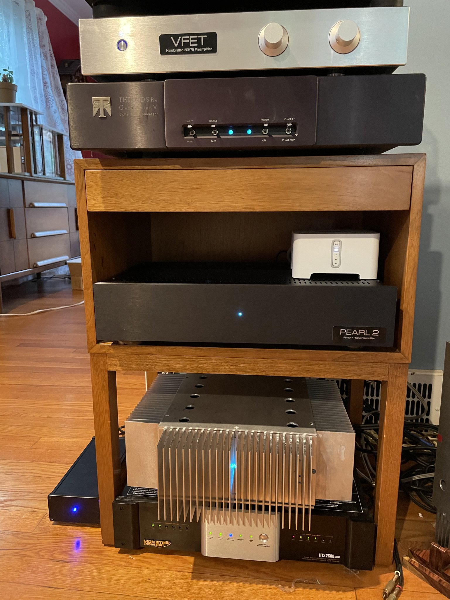

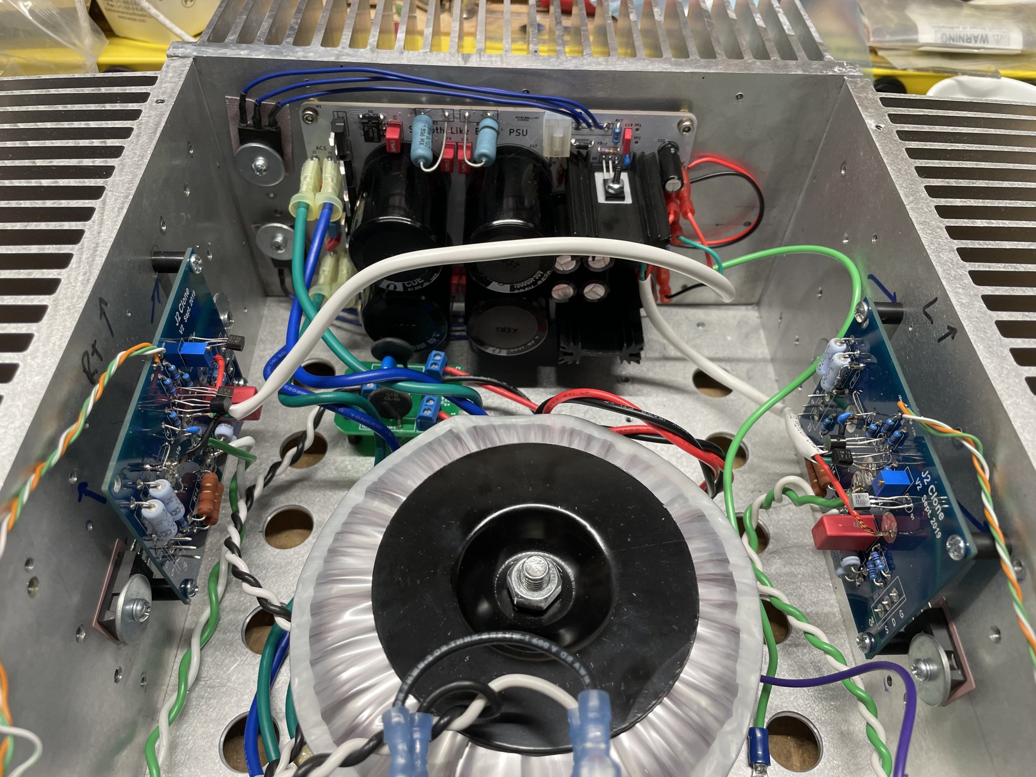

I finally got the opportunity to transplant my J2 clone boards into a chassis that can take the heat. This is an “upcycled” rawson Aleph 5 chassis. Now it’s a J2 clone with SLB power supply. The amp is running at 26.3V rails using a 400VA 22+22 Antek donut. Sound is fantastic!!! My Aleph 30 monos can take a break for a while.
Great build! What did you use for Q4? 2sk2497?I finally got the opportunity to transplant my J2 clone boards into a chassis that can take the heat. This is an “upcycled” rawson Aleph 5 chassis. Now it’s a J2 clone with SLB power supply. The amp is running at 26.3V rails using a 400VA 22+22 Antek donut. Sound is fantastic!!! My Aleph 30 monos can take a break for a while.
IRFP240.Great build! What did you use for Q4? 2sk2497?
Prior build details are in Post #376. Amp boards are the same.
The difference now is chassis with bigger heatsinks and PSU. I wanted to try the SLB PSU. The SLB requires a higher voltage donut, so that's new, too.
