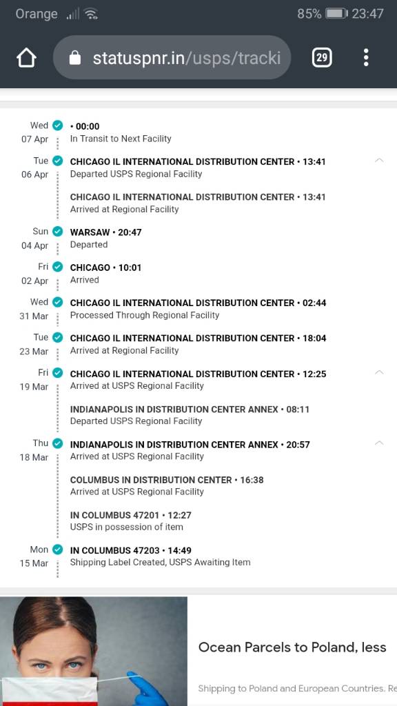

One other person had an issue with a Covid-related suspension of all imported goods to their country. Their package was set to return to sender, buts its stuck in limbo just like yours. Fingers crossed for you both.
Do you have information why they returned from Poland? There are no antycovid restrictions related to shipments from the USA to Poland.

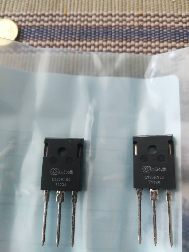

And the jfets arrived 🙂 The journey took a long time, but it ended happily. I was in no rush, as I will be waiting anyway when our benefactor Mr Pass decides (I hope so) to share the J2 diagram. So I will collect further missing parts. I already have Toshiba from group purchase in the lack of a second pair of semisouths.

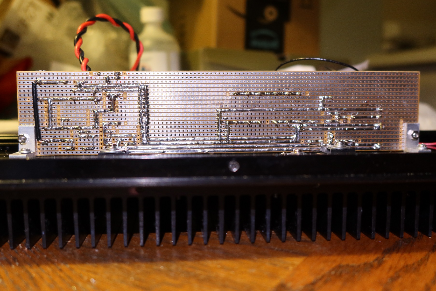

My F2J is finished and making very fine music.
I did the circuit on strip board. This is my first attempt with strip board and I am thrilled with the results.

Wow! That's impressive. There's a lot going on there....

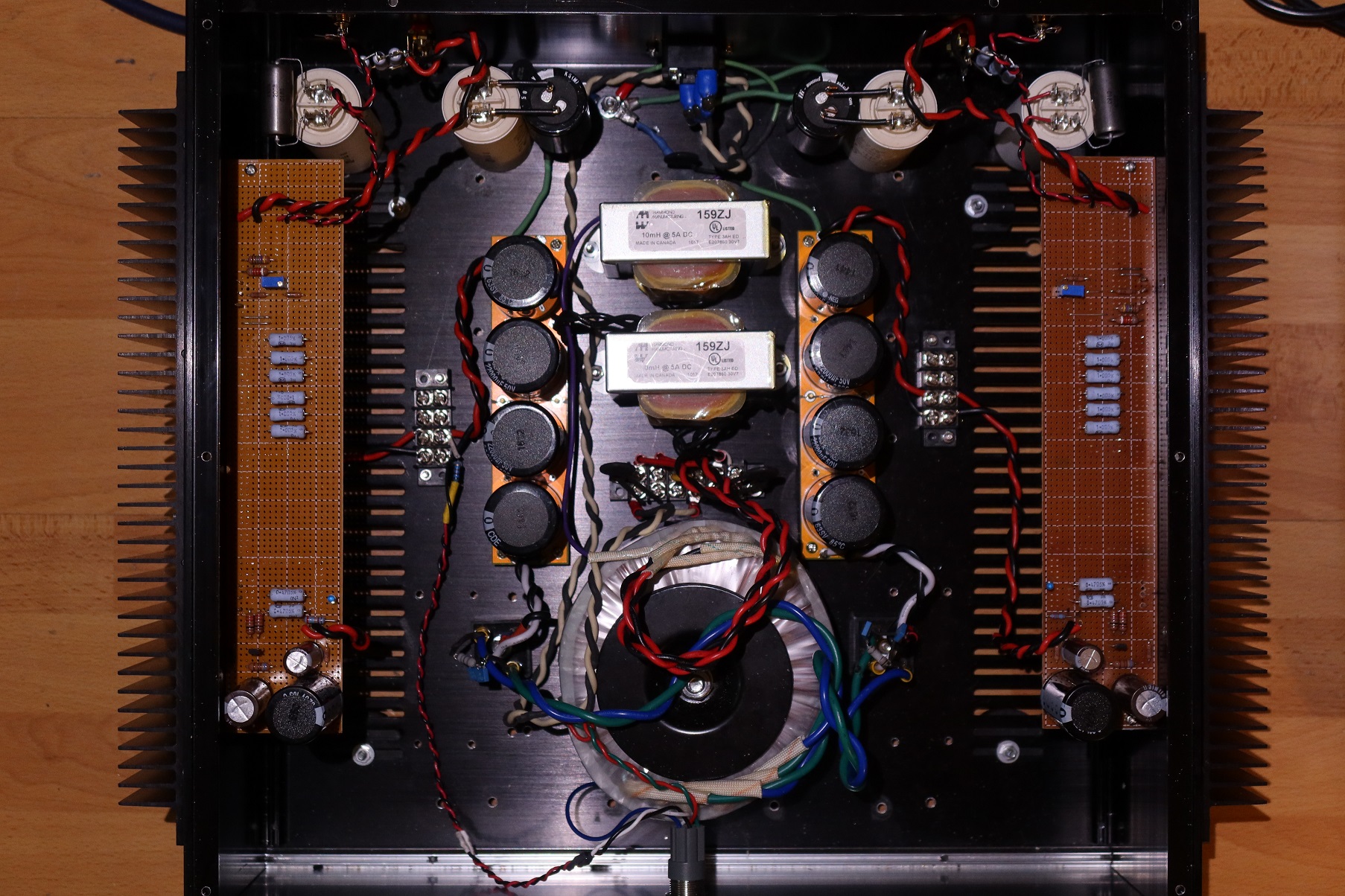

maximax77, the chokes are quiet. In fact the amplifier is quiet. Connected to my 102dB speakers, there is no hum or noise. I always do a CLC supply for my single ended amps.
This may become my primary summer amp as so far I like its sound, and it dissipates the least amount of heat of all my amps.

Very interesting build, Ben! what are the the runcaps for? I also see two K40...
Ben, I know you do a lot of listening and building of SIT amps - how do you like the F2J compared to some of those?

peppennino, the 10uF motor run caps are used as coupling caps. The input cap is bypassed with a Russian cap and the output cap bypasses the 10mF electrolytic coupling cap.
Cody, in my system the F2J sounds quite similar to my single ended 2SK180 follower amp. The distortion profile and levels are probably very similar. The single ended common source SIT amps are a bit different, with much higher distortion. The 2SK180 follower amp changed my outlook on levels of harmonic distortion. I still prefer some harmonic distortion with the second harmonic dominant, but not at the levels that I used to listen to. The F2J is keeper for me. It will be my summer amp, for use during the hottest months.
