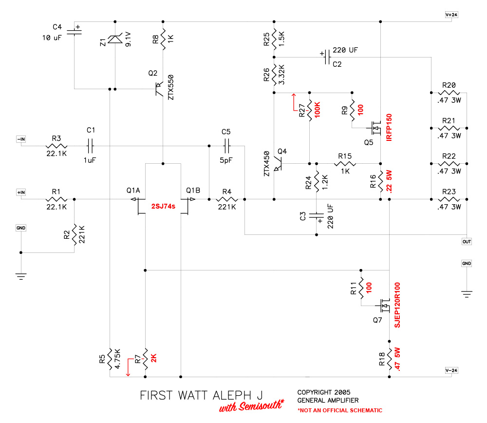

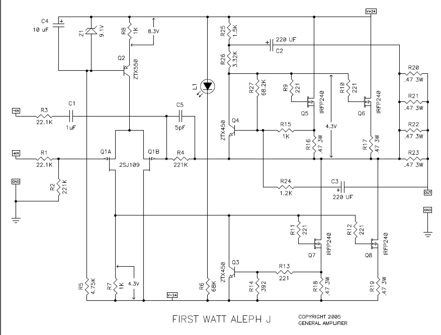

For those who’ve already built (or plan to build) an Aleph J with the store boards, the modification can be as simple as replacing the two output mosfets (bottom half / negative rail) with a single SJEP. Having the offset and bias pots installed give you the necessary flexibility to adapt to differences in Vgs, etc. I did a lot of playing around with sources resistors, but the ‘stock’ values are a sure bet.
IRFP150 works great. Right now, I just have a single IRFP240 in the upper position. I figured if the F8 can do it, I’ll give it a try 🙂
Great than Irfp240 it will be. Is my understanding correct that you want to keep Q5 because Q6 source pin is not connected directly to the Aleph CS ?
I believe that’s correct, or at least that’s how I’ve built mine.
It’s also worth mentioning that it’s perfectly fine (even preferred) to leave the current limiting portion in the circuit (Q3, R13 and 14.) In some cases you may have to adjust the voltage divider of R13 and R14 to keep the circuit from limiting too low, but I’d bet most will be just fine with the standard values.
So just removing them both sounds easy enough. Does it matter which position (inner most or outer) the SS gets put in? Also, is it safe to assume that the associated resistors for the removed output mosfet can stay in if one were to just use an already populated J board?

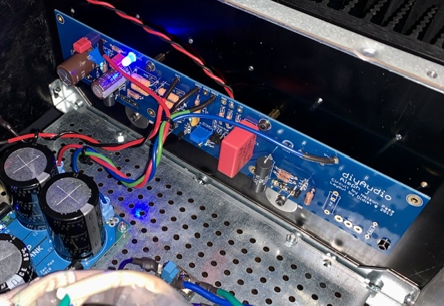

JSA1971, Here’s a picture of mine for reference. No issue to leave in the source resistors, etc for the mosfets you remove. I used some big 5W resistors, but that’s not necessary. The standard 3W are fine (that’s what I use now).
