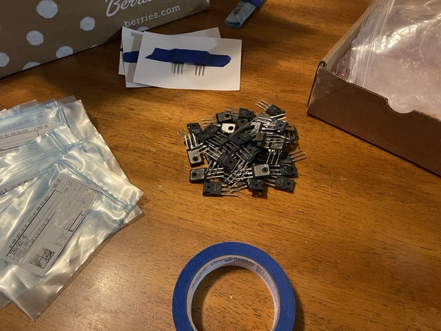

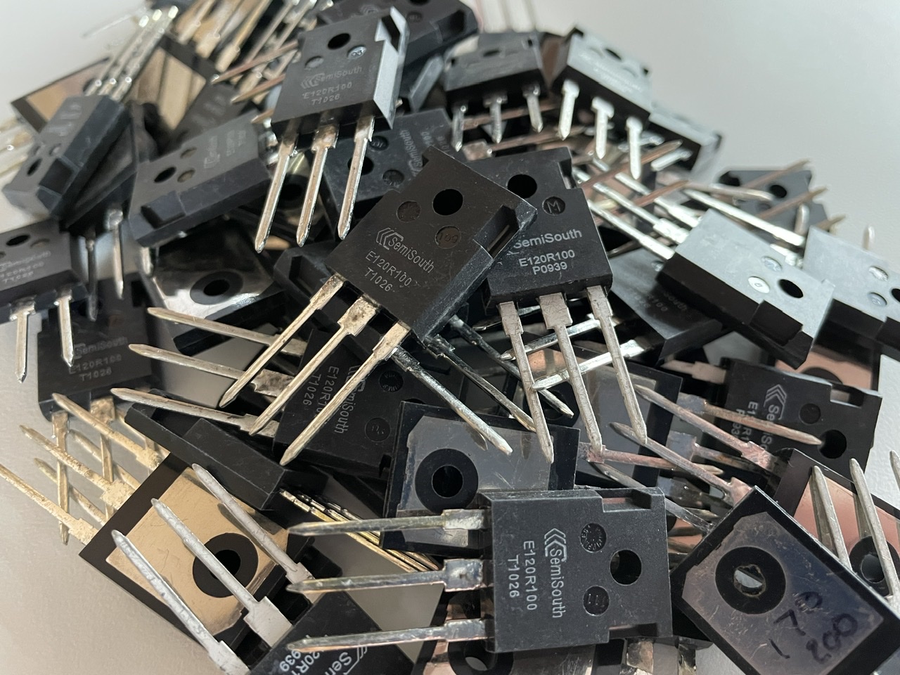

The parts have arrived, have been packaged, and I’m en route to the post office now. All eligible persons who’ve paid for shipping (everyone) have a package going out today. All parts have been spoken for.
Enjoy! And thanks again to Nelson for your generosity!

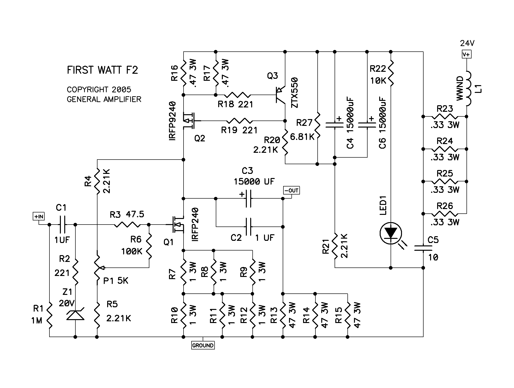

I have the speakers, not sure about the preamp. I’m using a VTA SP14 tube preamp and it usually likes to see a higher impedance. It has a 1uF coupling cap on one of the output, so I’m hoping that will be enough and I don’t have any noticeable low end roll off.
ZM,
Thanks.
I was looking at the manual and it stated that it was 10k. But looking at the diagram I see it is 47k.
Thanks.
Probably a second cup of coffee is a good idea. 🙂
yes, I admit, not enough coffee these days 🙂
though, I've read this (saved in my old trusty personal can), and looked at enclosed schm:
The F2's that I have updated with the JFETs need the
following changes:
R6 = 47k
C1 = 10 uF
Z1 removed
The potentiometer must be re-adjusted for minimum
distortion at 4.5 watts (symmetric clipping) and readjusted
after an hour.
The distortion results are typically a reduction from about 1%
at 1 watt to .25%.
