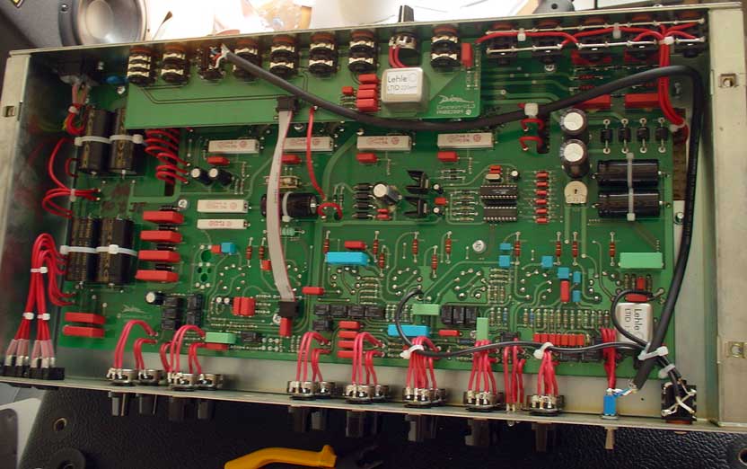

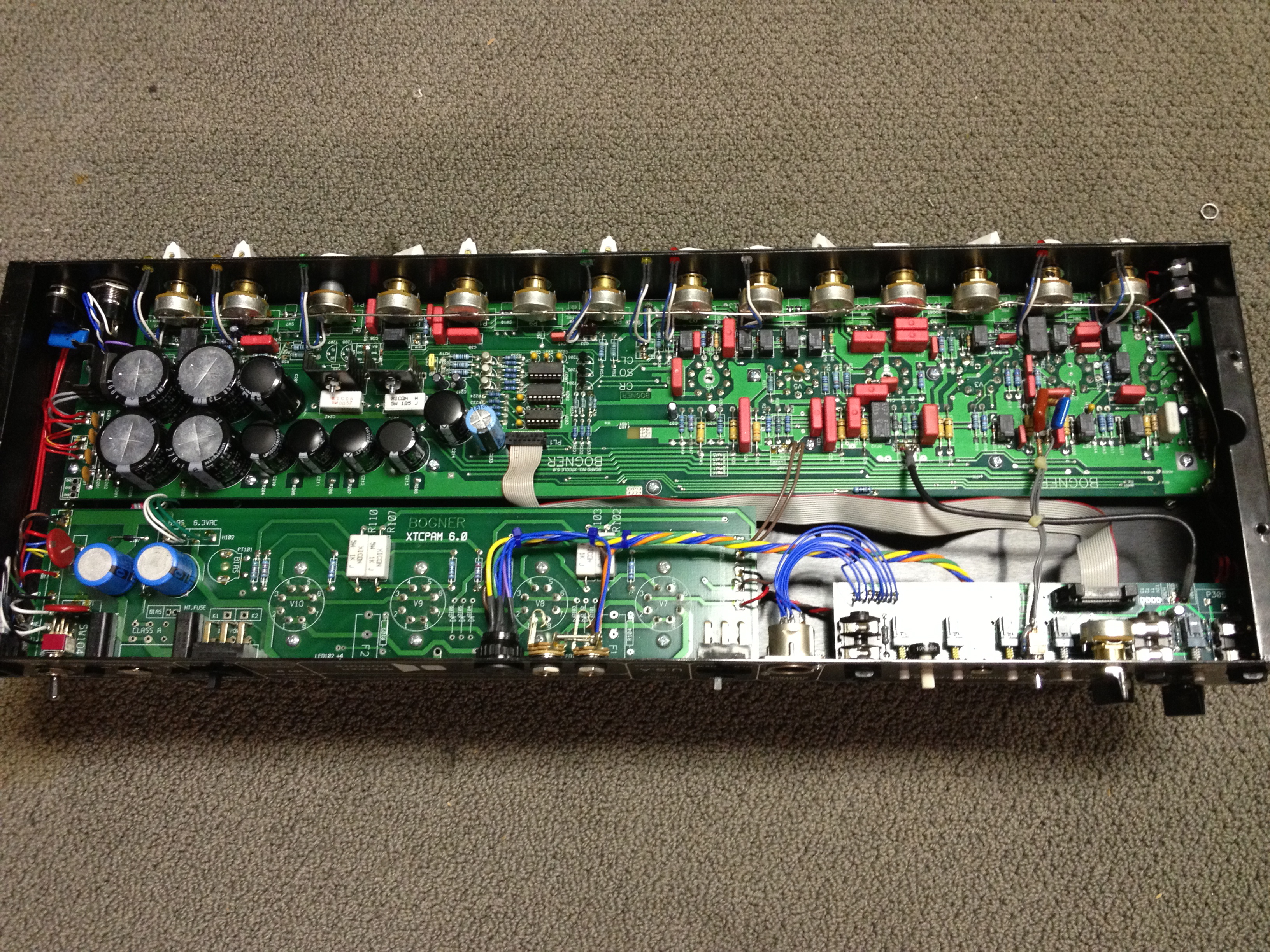

They also are a service nightmare. Things go noisy and now you have hundreds of solder joints to check. I don't think most of these PCB-based guitar amps will still be in service 50 years from now like blackface Fenders are.
The first one seems the Bogner XTC and the second a Diezel Heinstein (I guess from the layout of the pots), those amp will be still serviced in 50 years just because they cost some thousand euros even when used, and because are considered a status symbol in the guitarist niche.
Other cheaper amps (think about the Laney VH100R) that mix smd and hole through, crowding the chassis with pcbs, will be trashed or gutted and rebuilt with something else.

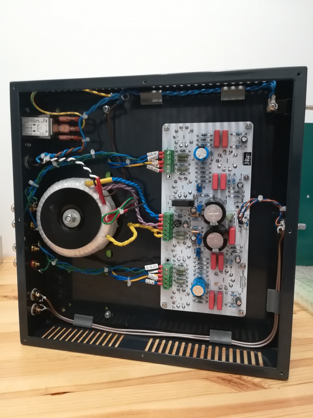

One of my pcb design and final amplifier build in photo bellow 🙂
Still.. if they get low THD figures they can wave..

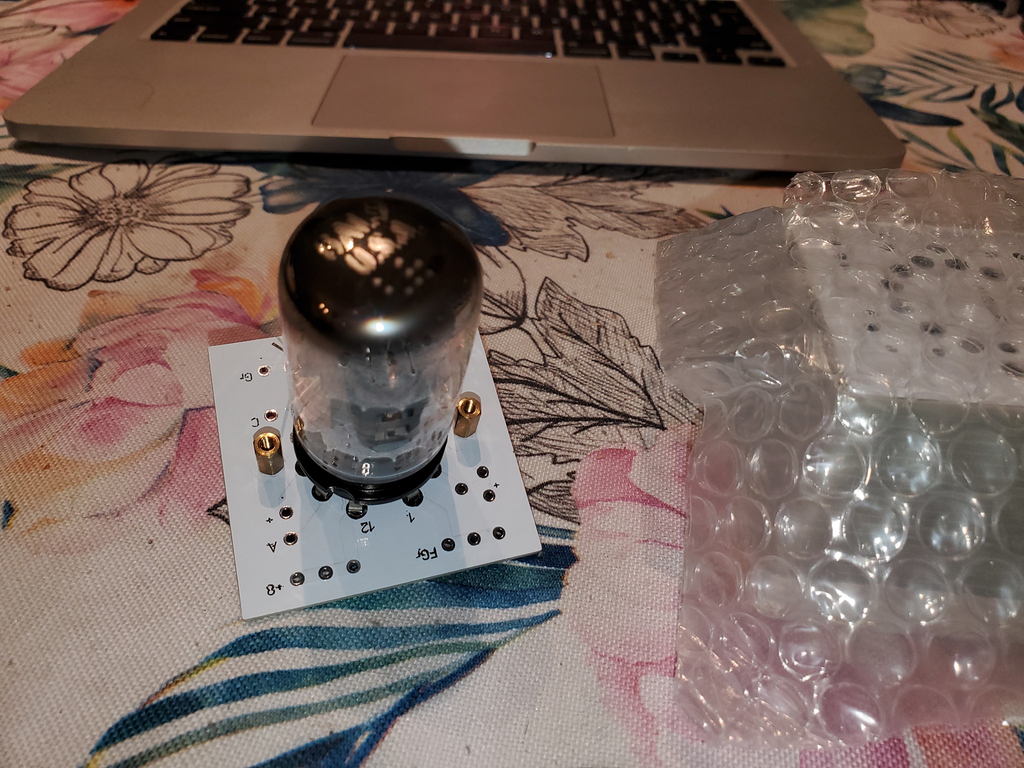

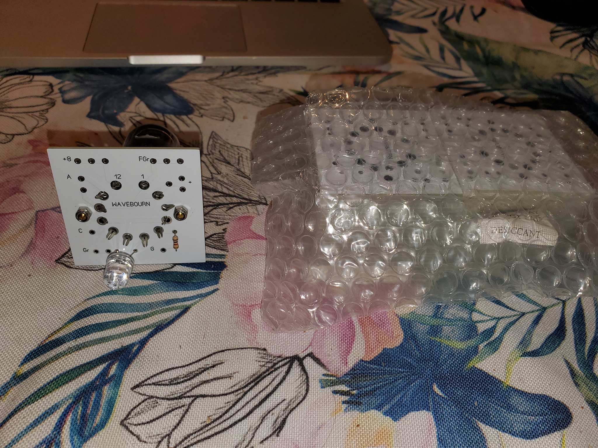

Something like this? I could see how this construction method would conduct far less heat down the tube pins, into the traces and needlessly heat up the other parts. Also it offers flexibility in alternative wiring for different bases and pin outs, positioning the grid stoppers, in future servicing of the amp, etc.
Looks good to me. The boards are narrow, good for convection. I prefer to mount boards vertically, so resistors are open to convection too. But since I bought helluva Compactron PCB mount vintage sockets, I made small boards for them, with proper connections and few components that is better to keep closer to tubes.

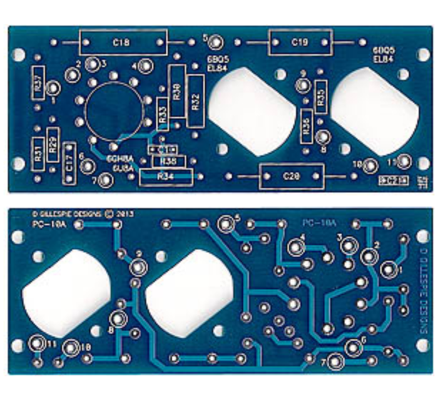

Does it make sense to make PCBs to hold the passive parts and other support circuitry (e.g., plate CCS, coupling RC, cathode RC or LED, , while chassis mounting the tube sockets off the PCBs? I'm assuming the tube sockets would be located as close as possible to the PCBs holding each tube's supporting circuitry. Maybe leave a cutout in the PCB for each tube socket, expanding on what the photos show in post #75?
I don't like the idea of putting traces on the PCB for the heater supply. I leave pads on the PCB for running twisted pair wiring from the heater transformer secondary or a regulated DC heater supply straight to the heater pins on the tube(s). You're just using a bit longer run of hookup wire, and it helps keep heater currents from coupling into audio signal traces.
