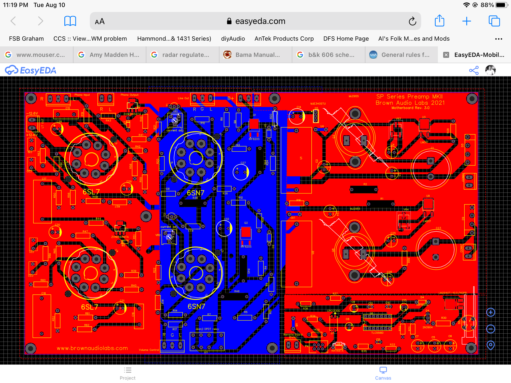

Ground planes do makes sense in audio, but not so much in tube circuits due to the high voltage.
Auto-routing makes no sense anywhere, especially in audio. At least I've yet to see one create a good layout.
Don't go crazy with star grounding. Recall that the point of star grounding (and ground planes) is to keep large currents away from quiet circuits. So you can have the "quiet grounds" come together and the power grounds come together and join the two at one spot. Routing each component that's connected to ground via its own trace to a ground star gets really unwieldy.
Note that the power supply lines often have the same problem as grounds. Make sure to feed sensitive circuits from a supply line that is not bouncing around due to the current draw of a heavy load (like the output tubes).
Oversize the pads for hand soldering. You'll thank yourself if you ever need to de-solder anything.
Make the traces wider than minimum width. 15-20 mil (0.4-0.5 mm) is usually good for low currents. You definitely want to go beefier on higher currents (like the heater traces).
Watch the trace spacing - including on connectors. Note that connectors and resistors have maximum voltage specs. Stay below them.
I would probably route the heater traces first. Then the signal path. Then everything else.
Spend lots of time on the component placement. Layout is easy (or easier) if the components are placed well.
The Saturn PCB Toolkit is a good resource for trace width, spacing, etc.: Saturn PCB Toolkit - Saturn PCB Design | Saturn PCB Design
Regular 1.6 mm FR-4 with 1 oz (35 um) copper is plenty. If you're concerned about the board flexing from inserting tubes into sockets, place mounting holes on either side of the tube socket or have a large cutout in the board and wire through it to a chassis-mounted tube socket.

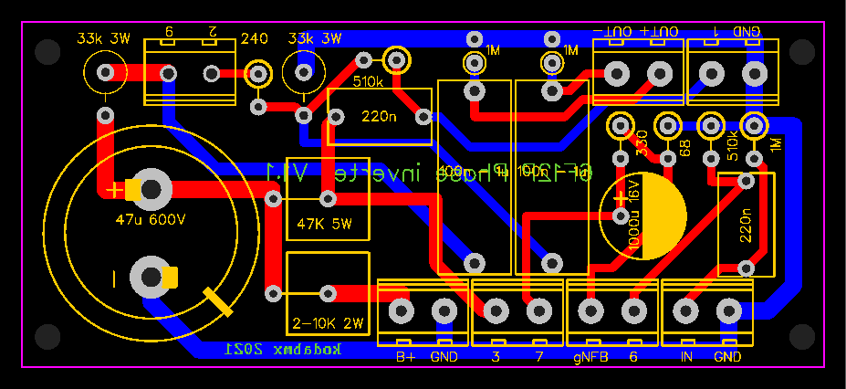

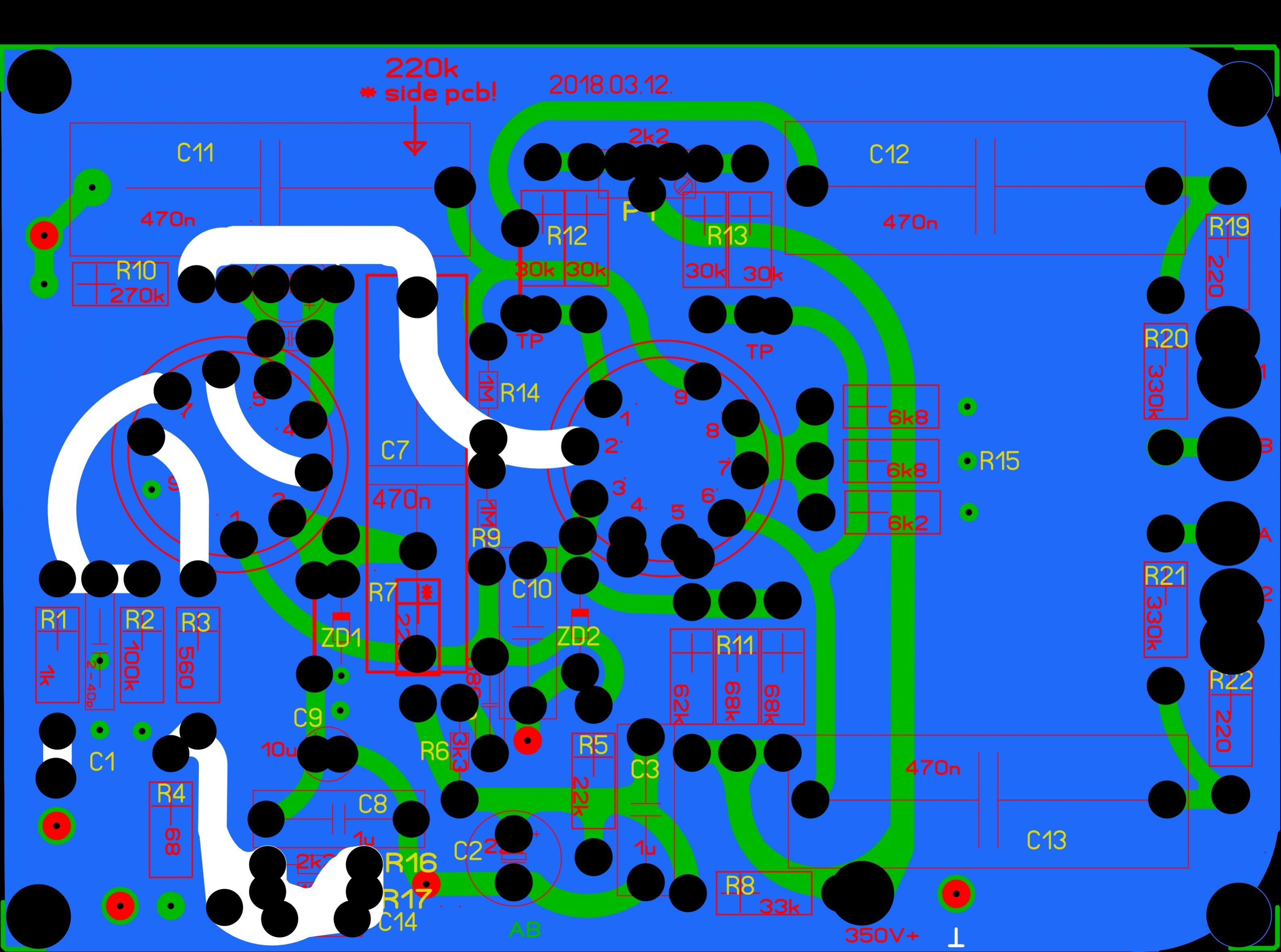

Not sure if it's been discussed- but I think tube socket pin holes in PCB's should all be vias... Pads both side of PCB and metal thru the hole.
I used the Newark trace width calc also- finding there's important tradeoff of amperage/width V thermal gradient.
Something I considered was to unmask filament traces & fill w/ solder during assembly to augment current capability.

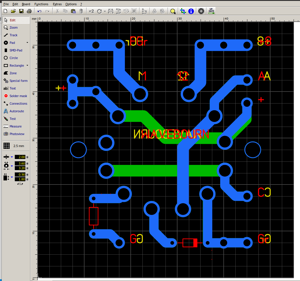

The other thing is how to solder the 9/8 pin socket so that it does not shake or move. You can bolt down the socket to pcb through the socket hole in the middle and hole in pcb, then solder all the pins to pcb. You can the try to plug it a tube to see it fits, insert an old tube to test or use rivet pin of a little smaller diameter than the tube pins

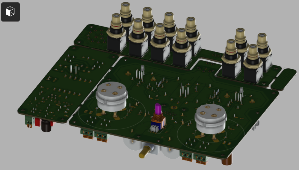

Three thing to consider when using PCB:
- as pointed by @Wavebourn, thermal management; applies for tube sockets and also for heat generating components like plate or cathode power resistors (if possible out of the case then generally they´re some electrolytics used); I´m using HQ noval, octal or UX4 sockets from CMC (PCB definition for noval allows only creepage up to 200V); I´m also using Beltron ones or custom ones (loctal); I´m mounting Jumbo sockets using metal spacer
- heater supplies routing on PCB is tricky: personally I prefer twisted cable and connector (MicroMatch are nice for low current applications); twisted routing is also possible using alternate layer swapping
- respect creepage and clearance; use slots, or put HV in inner layer (if you´re using multilayer PCB) to increase creepage; don´t forget to calculate this values at no load
I´m always trying to replace electrolytic with film capacitors (KEMET, WIMA, PANASONIC).
I´m using KEYSTONE 500x testpoints.
I´m mounting sockets and heating components (if possible) on top side and all the rest on bottom side.
I´m mounting the PCB on a custom aluminium plate (Schaeffer Apparentbau), so testing and measurements only on bottom side and very easing.
My two cents.
PS: find 3D view of Ale (Bartola) 300B preamplifier (if I remain correctly, only 250VDC max.) attached.
JP

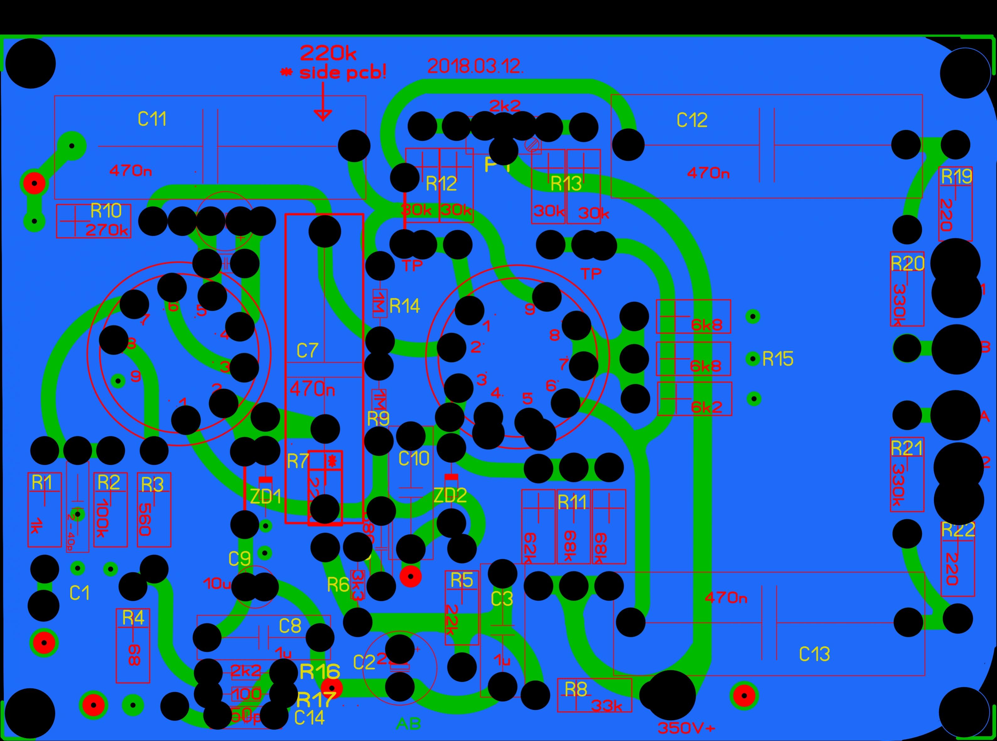

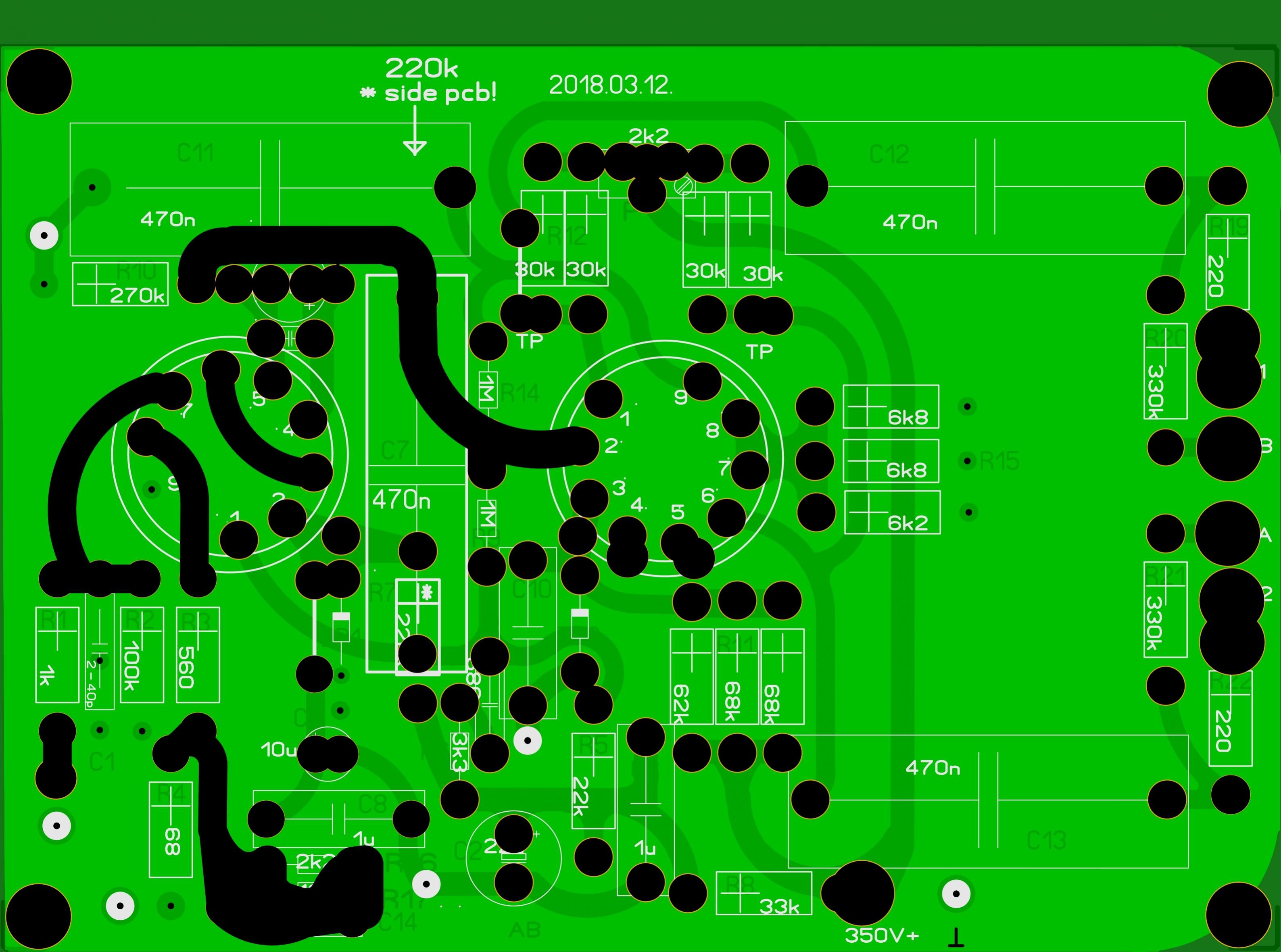

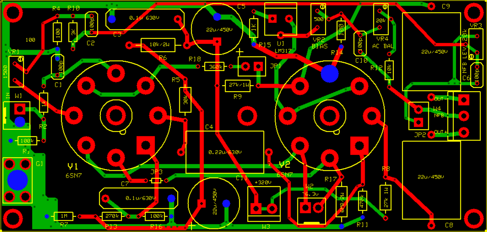

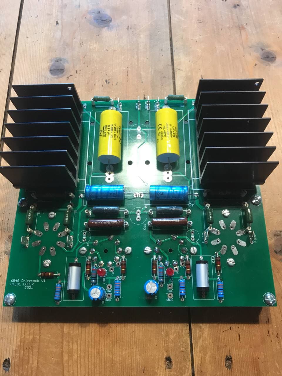

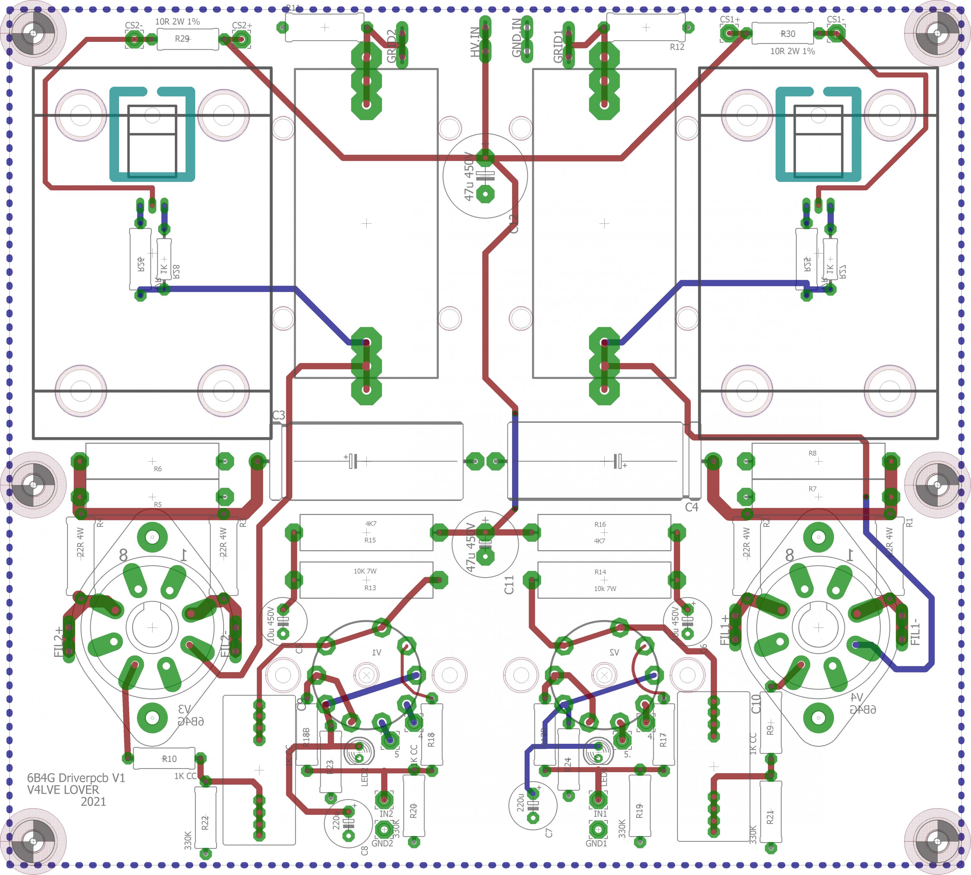

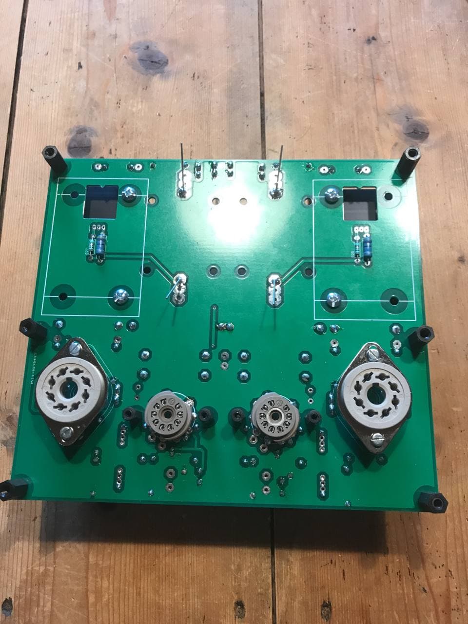

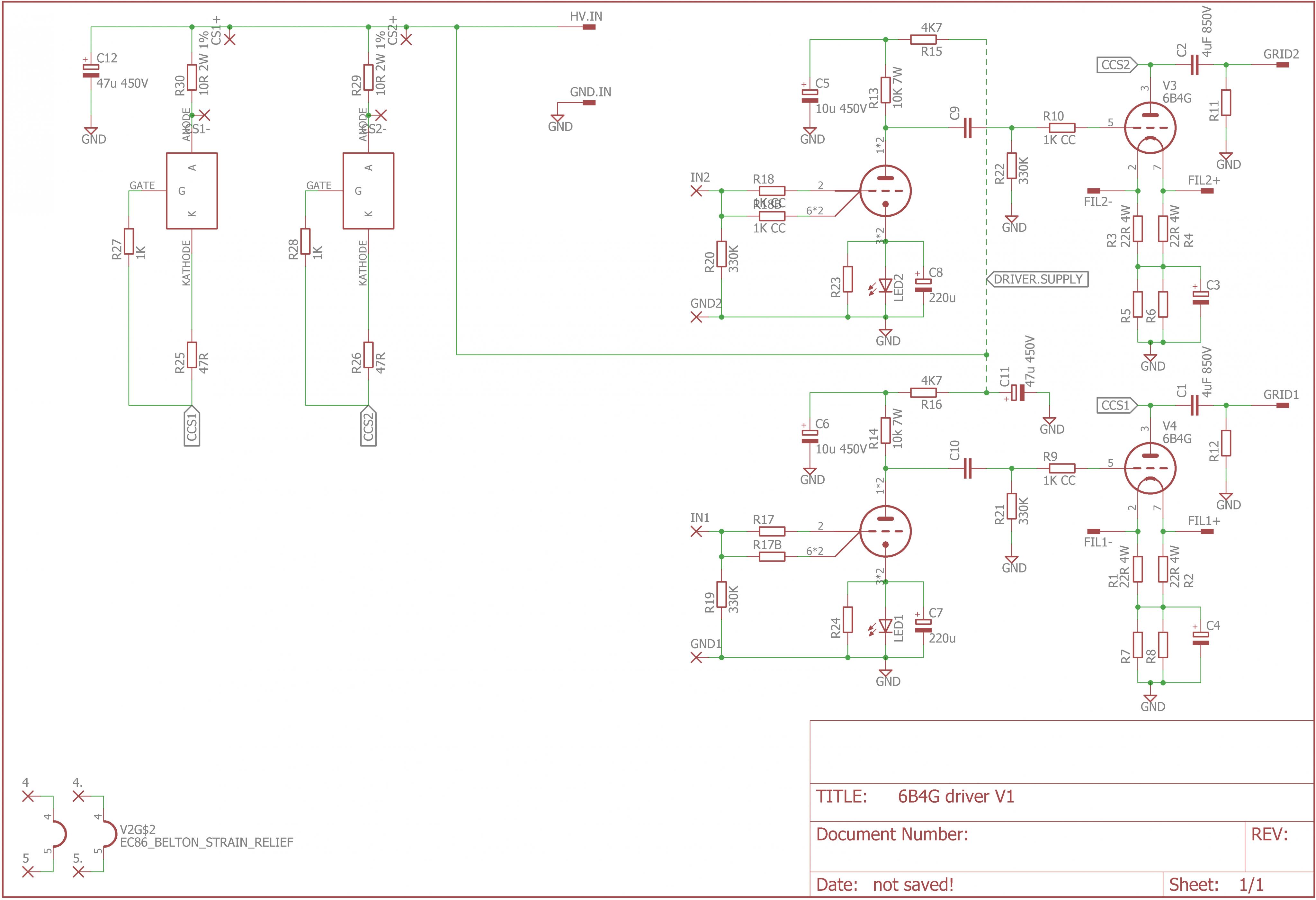

My E86C 6B4G driver PCB- Make a PCB phototread?
As long as we are posting examples. Perhaps make a sticky for diy PCB artwork?
Heres a board i did for a forum member, E86C RC stage, feeding into a CCS loaded 6B4G for driving a GM70.
Mind you i used grid stoppers on every grid connection of the E86C to curb oscillation.
Belton sockets for everything, i forgot to put drill holes in the center of the 6B4G, stupid mistake.
All resistors are mounted slightly off board by means of ceramic tubes that slide over the leads.
Note that i use plastic standoffs near the tube sockets nowadays, this is experimental, i dont know if they stand up to the heat.
