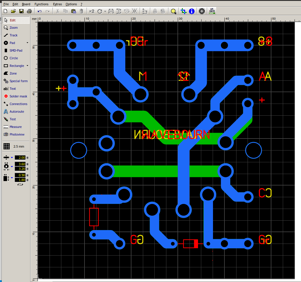

I don't mean to throw the thread off the point, but can anyone share a known-good symbol for a standard 9-pin miniature (B9A, etc.) tube socket for Sprint Layout?
I'm just getting started with it, waiting on my first batch of pcbs. I don't know yet if the socket symbol I made will come out right.

Theres no such thing as standard, Belton allone makes three variants, and the chinese make three noval 9 pin variants that i know of. Then there is CMC which makes one and a couple of others.
Belton VT9PT? is the nicest 9 pin noval around, CMC is just too tight on the tube pins and prohibitively expensive. These are good quality, but three times the price of the Chinese ones.
If you want easy, look up the belton collars for tube shields, and add two holes in the footprint for a m3 spacer that indexes with the tube shield collar. I dont know how sprint works exactly but its best to draw a circle around the spacers akin to the "Keepout" or "Restrict" layer in Eagle so it doesnt short anything to the top plate.
A 3.2mm hole in the center of every tube footprint is a good idea, i like the idea previously mentioned of slotting between G1

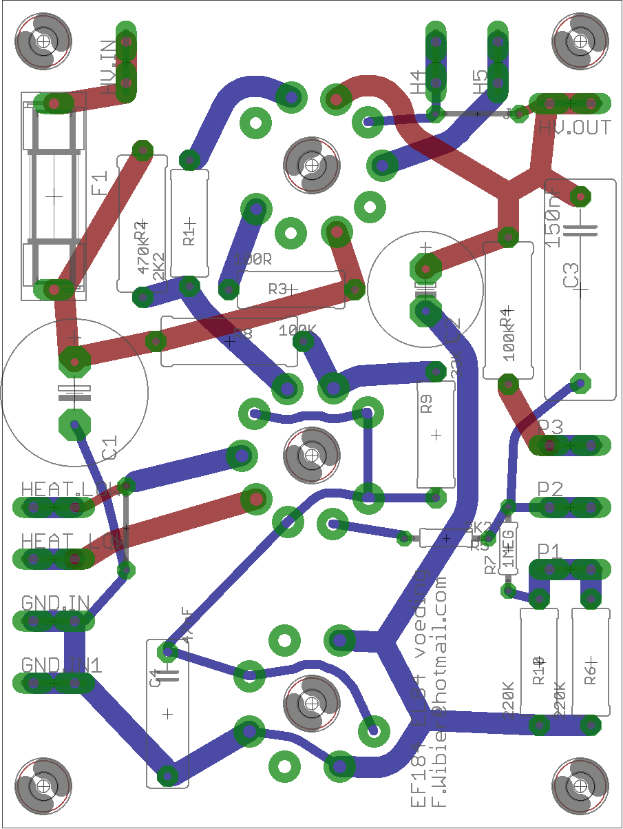

There is a Russian autorouter by the name of TopoR, that can eat some of the most common board file formats, and autoroute the board with those very nice looking curved traces. See attached for an example, it eats EAGLE and a couple of other EDA files as input, and you can export back again when you are done. The major benefit of this, is that this autorouter will bend over backwards to accommodate a solution that fits the clearance requirements. and you can be very specific, and specify any clearance between any pair or group of nets manually, this is tedious, but a tube amp board does not require a uniform 0.1'' clearance.

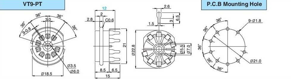

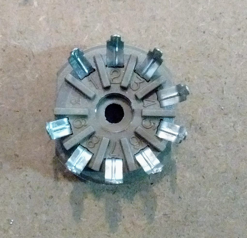

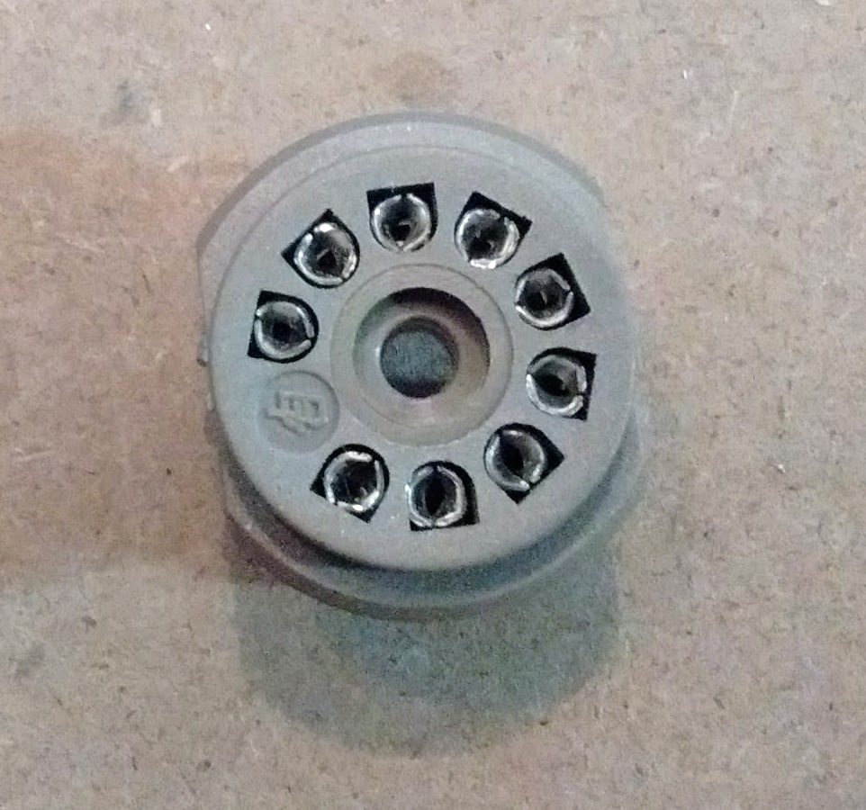

I have a symbol for CMC 9pin socket, but I agree that those are hideously expensive. I bought some sockets that are supposed to be Belton micalex but I don't know exactly which version. The diameter of the circle described by the pins is about 21mm. I've attached photos.

Those are VT9PT from the diagram i posted earlier, best sockets for the job i think. Hole diameter is 1.2mm i think.
Perfect That's what I have been looking for. I searched online but they gave me another one has only 1 end. 🙂

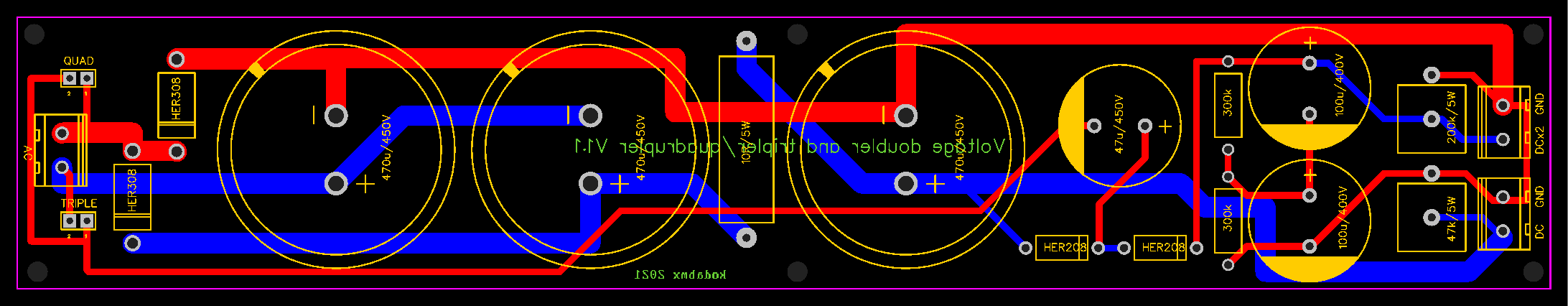

I re-read the thread. Here is an example of a PSU board. Input 120VAC, output 320V/640V however, DCx2 is ~700V unloaded.
I have many of these in service. I've never had any board I've designed arc.
Side note - the jumper for triple doesn't work.
