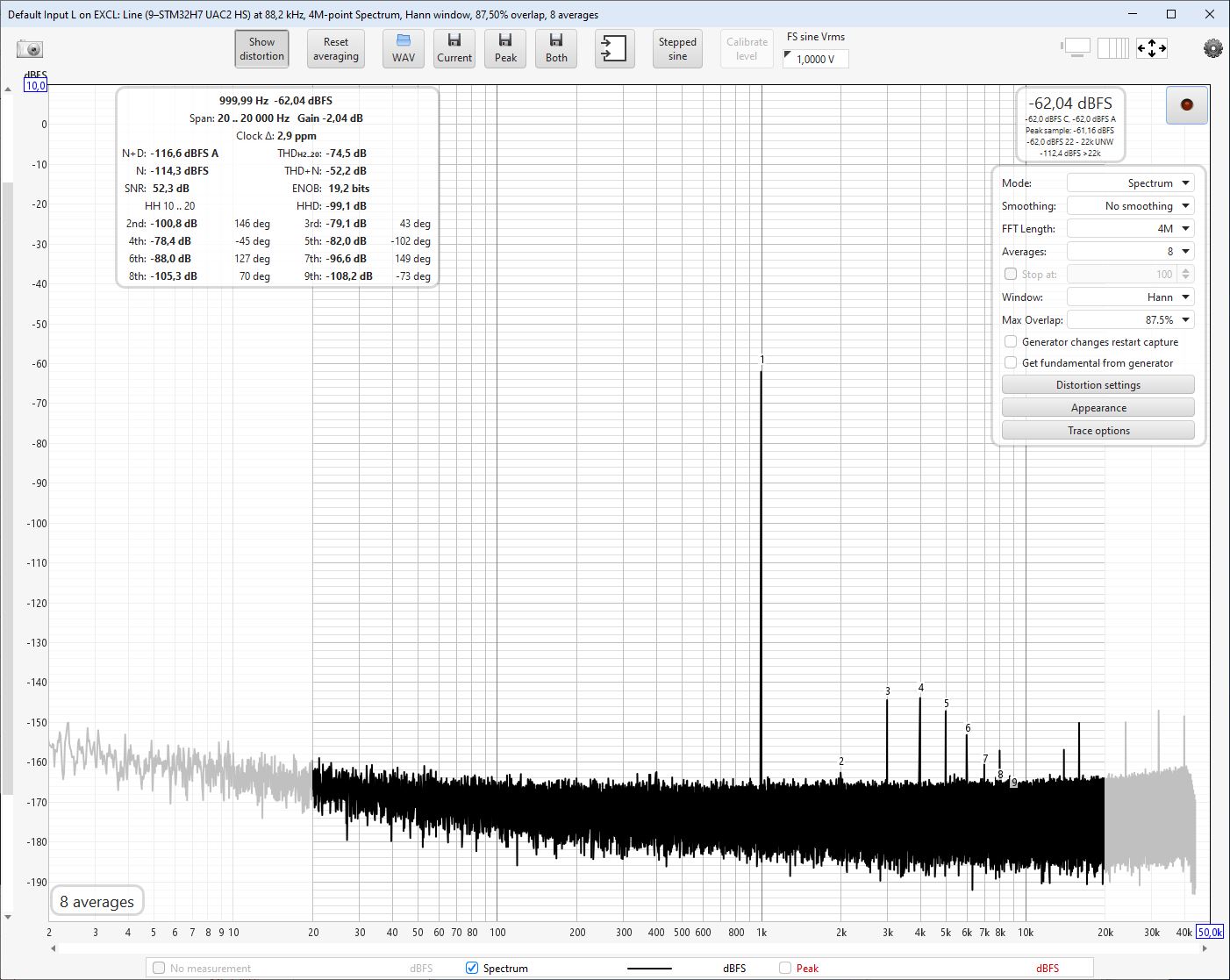

Does the low-level not-quite-harmonic distortion issue (which is really a frequency-modulated idle tone) still occur with my latest configuration file?
https://www.diyaudio.com/community/threads/return-to-zero-shift-register-firdac.379406/post-7895559
I don't know if anybody has measured it with your latest configuration file. Anyhow IIUC Markw4 is not using it for some reason.
Regarding the supposed low-level of this not-quite-harmonic distortion issue it seems to be audible:
https://www.diyaudio.com/community/threads/general-purpose-dac-clock-board.413001/post-7757408
@PJotr25 has measured it with versions 1.2 and 1.3, so before the DSD remodulating bug was fixed. Using a PCM input signal, he got a second harmonic of about -138 dBFS to -141 dBFS when the signal was -60 dBFS, 1 kHz, and the higher harmonics (or peaks close to harmonics) drowned in his -150 dBFS noise floor. The typical Bessel sideband shape that you saw (as in post #353 of this thread) was nowhere to be found.
Ok. Let's hope somebody measures your latest version with a more performant ADC.

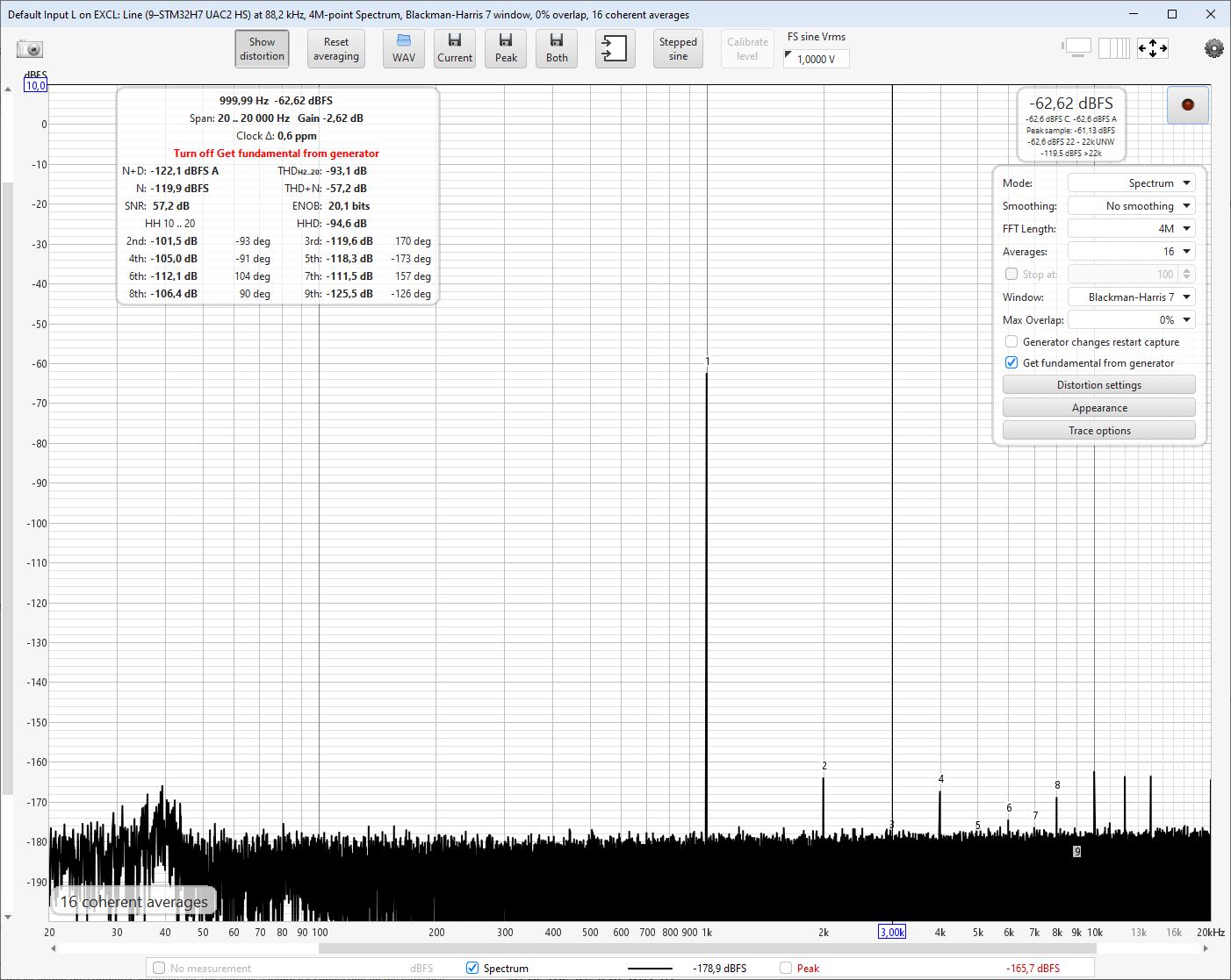

Just as a comparison here is PCM2DSD v03 (i.e. higher level not-quite-harmonic distortions) with AK4493 measured with coherent averaging. Note the level of noise floor. Highest "harmonics" are lower than -160dBFS.
