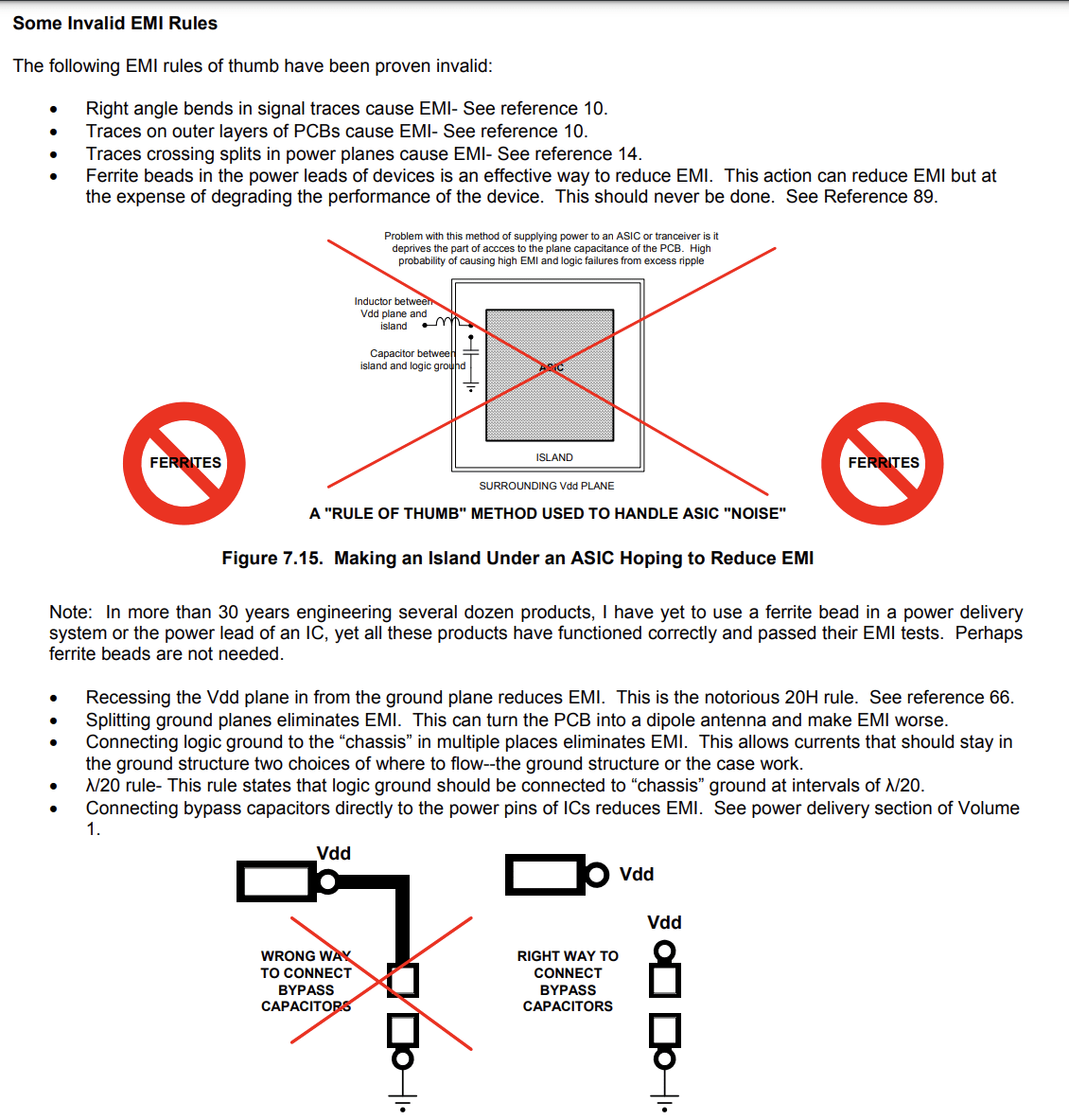

BTW, someone mentioned to me about this High Speed PCB Design place: https://speedingedge.com/
They have published some books and newsletters. Here is a little snippet from one book:
Turns out they don't like ferrites.
I guess this is from people interested in very-high-speed digital circuitry, rather than in controlling crosstalk in a mixed-signal design. Ferrite beads can be quite effective when you want to control crosstalk via magnetic coupling or common-impedance coupling, and a bit of extra ripple on the aggressor supply domain is often no problem.
Yes, probably so. Still, for audio dacs there is something about ferrites that seems to make the sound brittle. Maybe it is the hysteresis distortion. Also, I still maintain that phase noise plots do not tell everything about time jitter. RMS jitter can only be estimated from such plots. Peak time jitter, not so much.
