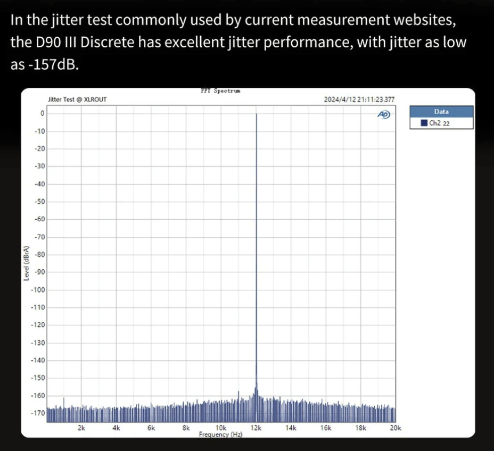

Noticed this bit of promotional work from Topping for their now D90 III Discrete dac.
Interesting qualification they make about jitter measurement according the jitter test commonly used by current "measurement websites." Its J-Test if anyone doesn't already know.
Suggests to me at least, they know about noise skirts and possibly about other phase and amplitude measurement methods.
They also appear to choose far-out phase noise (type of jitter) to use as their spec'ed performance number.
Hi Mark,
not sure how to interpret this graph without knowing the FS this FFT was made and FFT length. So knowing the bin width of the FFT?
No details about the FFT settings were given. Its from Topping marketing stuff at: https://apos.audio/products/topping...JmEw-PWUXldahqDy-ZKFRiuAZ1KnVrong6hG27QiTHtoI

Hi Mark,No details about the FFT settings were given. Its from Topping marketing stuff at: https://apos.audio/products/topping...JmEw-PWUXldahqDy-ZKFRiuAZ1KnVrong6hG27QiTHtoI
Very impressive figures for this Topping Dac, not automatically leading to impressive sound, but nevertheless.
Would be interesting to compare this Dac to your extended Firdac setup.

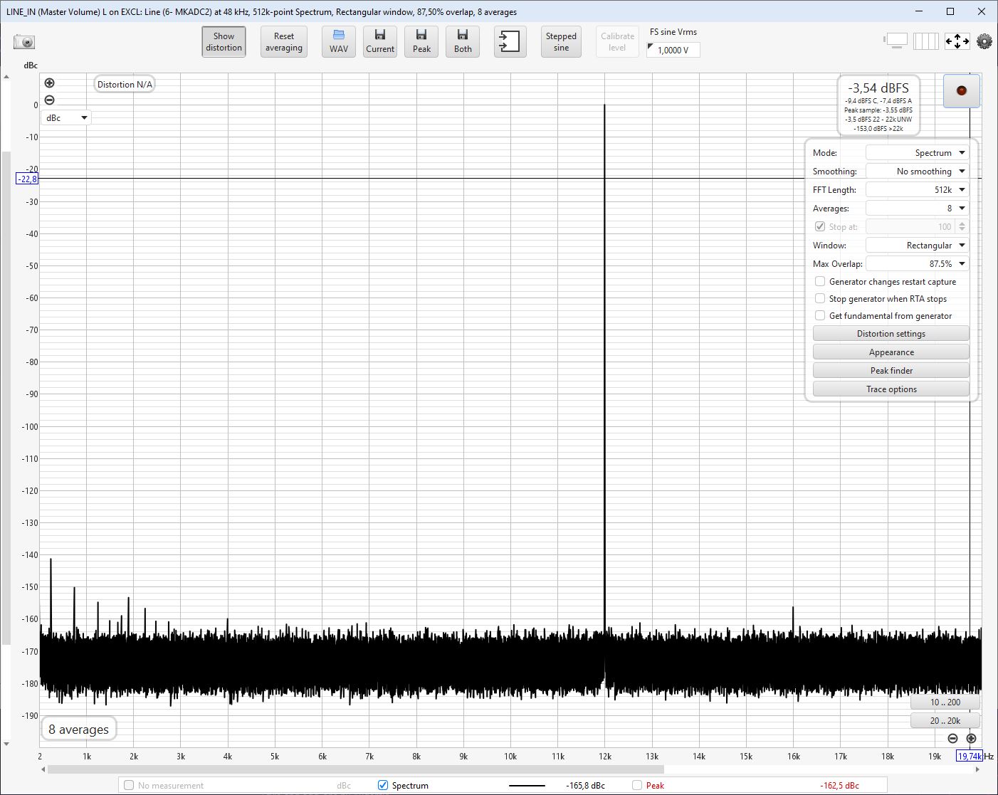

What’s “this”.How about this?
A distortion test or a jitter spectrum ?
Hans
Same 12kHz J-Test jitter spectrum as in Topping (post #327) although in that picture FFT details are not shown.
