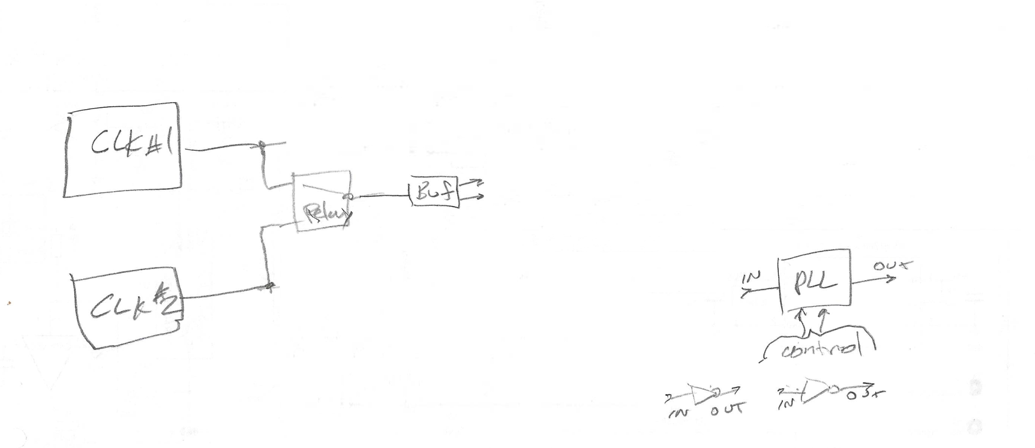

EDIT: Regarding the configuration described in post #144, it reduces the basic concept of the Clock Board to look more like this (simplified diagram):

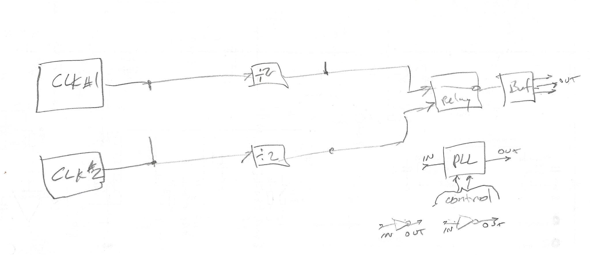

If using 45/49MHz clocks, there are few different things you could try, some of which I have not tried yet.
1. You could try configuring the Clock Board using the frequency dividers but leave out the constant outputs intended for Andrea Mori type use, and not use the PLL. Not sure if you would find a crosstalk problem or not. In that case the clock board would look more like this (you can also configure the frequency dividers to run from AUX power, which may or may not help):

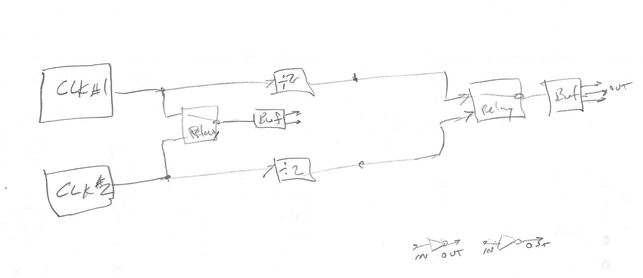

2. You could do like in 1. above, except leave out the first relay, and keep the PLL to generate the 45/49MHz clock signal for I2SoverUSB. It would look more like this:
3. You could use two clock boards, one board for each clock, then do the clock switching after the clock boards.

Switching clocks using RF Relays is a good solution, I have used it myself.
One problem is that it causes the clock to glitch, it may cause problems downstream.
An alternative are CMOS switches aimed at switching 480MBPS USB for example. The NXP/Nexperia 74CB3Q3257BQ can switch 5V signals on 3.3V supplies, have extremely low propagation delay etc. No contact glitches, switching in under 10nS.
Also, unless the clocks must be running continuous, I'd probably gate the unused clock off.
