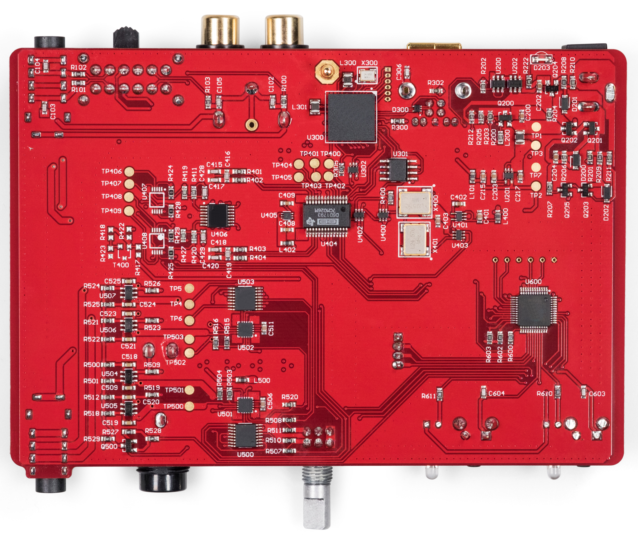

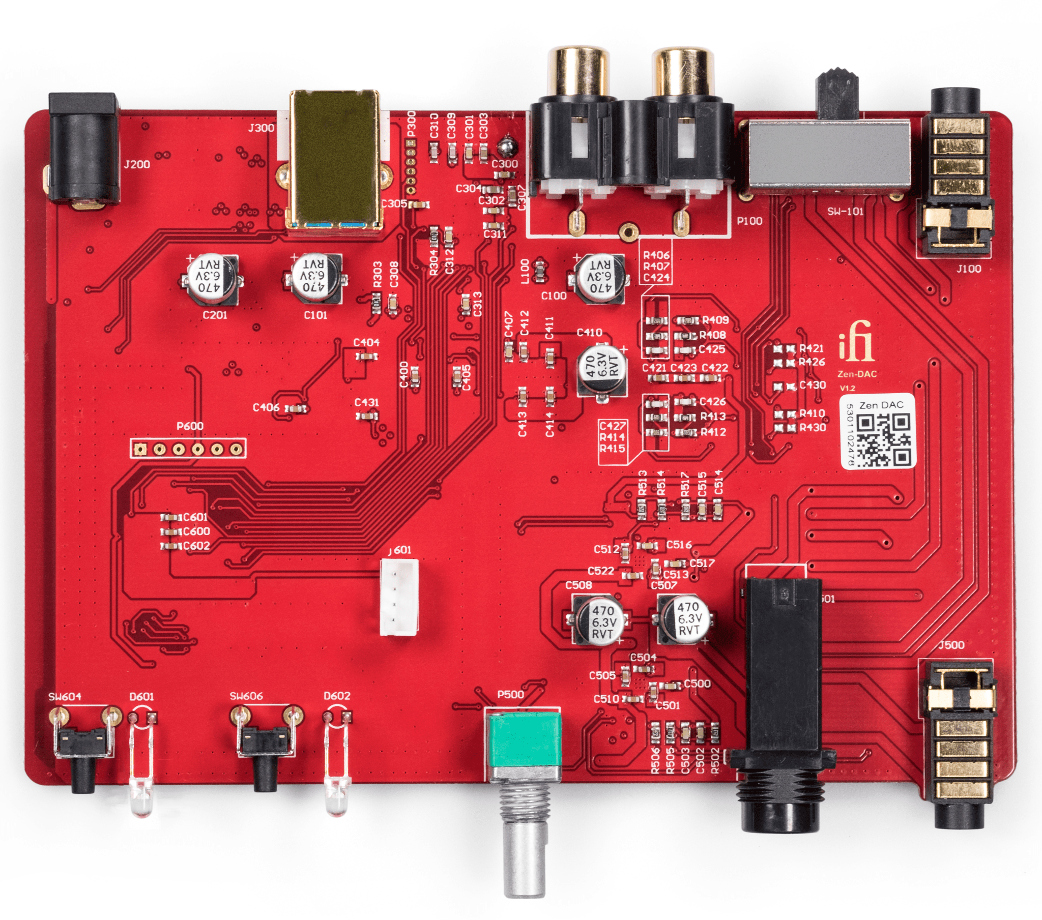

For illustration the PCB, both sides of the original iFi ZenDAC (PCB design under my supervision):
Top side has all "tall" components and every decoupling capacitor, power islands for some sections can also be seen.
Bottom side is IC's and directly related signal routing. PCB is 4-Layer.
The PCB obviously passes twice through reflow, in practice this has no reliability implications in mass production, price difference is nominal.

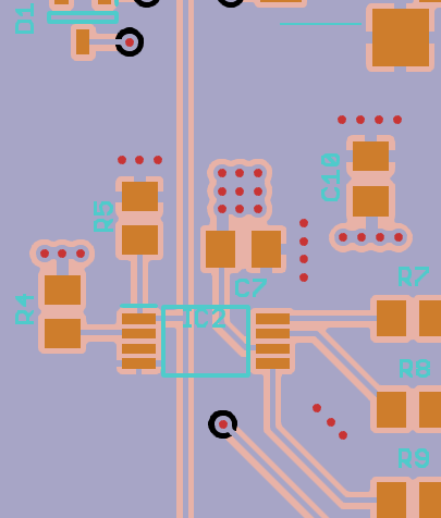

Yep, I would agree that this layout is quite non-ideal. The return current will have to go left, circle around R4, switch to the other side at the three vias above R5, and finally switch sides at the via block right of C7 which seems to be the decoupling cap. Further, the connecting trace to C7 is pretty narrow, increasing inductance.![]()
This is the output buffer layout from the board in #232. In the lower left corner is the ground pin off the buffer chip. It has no low impedance path back to the chip's bypass cap.
The fix would be easy: Place C7 right below IC2 so that it bridges over that vertical trace, and use wide traces (I most often do not use trace "wires" but simple rectangular fills combined to get wide traces).
And of course, as mentioned in another thread, place GND stitching vias everywhere and notably along any longer traces.
The basic idea is to think of the PCB as one solid copper block, all layers being initially GND and all layers connected together with tons of stitching vias. It's not uncommon to have hundreds of them, sometimes even thousands.
And, use as many layers as you can afford (not less than four, at any rate) and make the board as thin as possible.

Correct. We all now use ROHS solder paste which is "phase-change" if I remember the term right.
After applying the past via stencil and machine placing components, the paste holds the components in place for minor force or tilted boards.
After the first reflow, the solder paste changes so it needs a temperature notably higher than the official reflow temperature and reflow ovens have very tight temperature and process control these days. It's a whole science in itself. But even low end Chinese PCBA houses seem to master it all right.
You can see the results of mass production using such processes on the board pictures. Looks pukka enough to me, innit?
