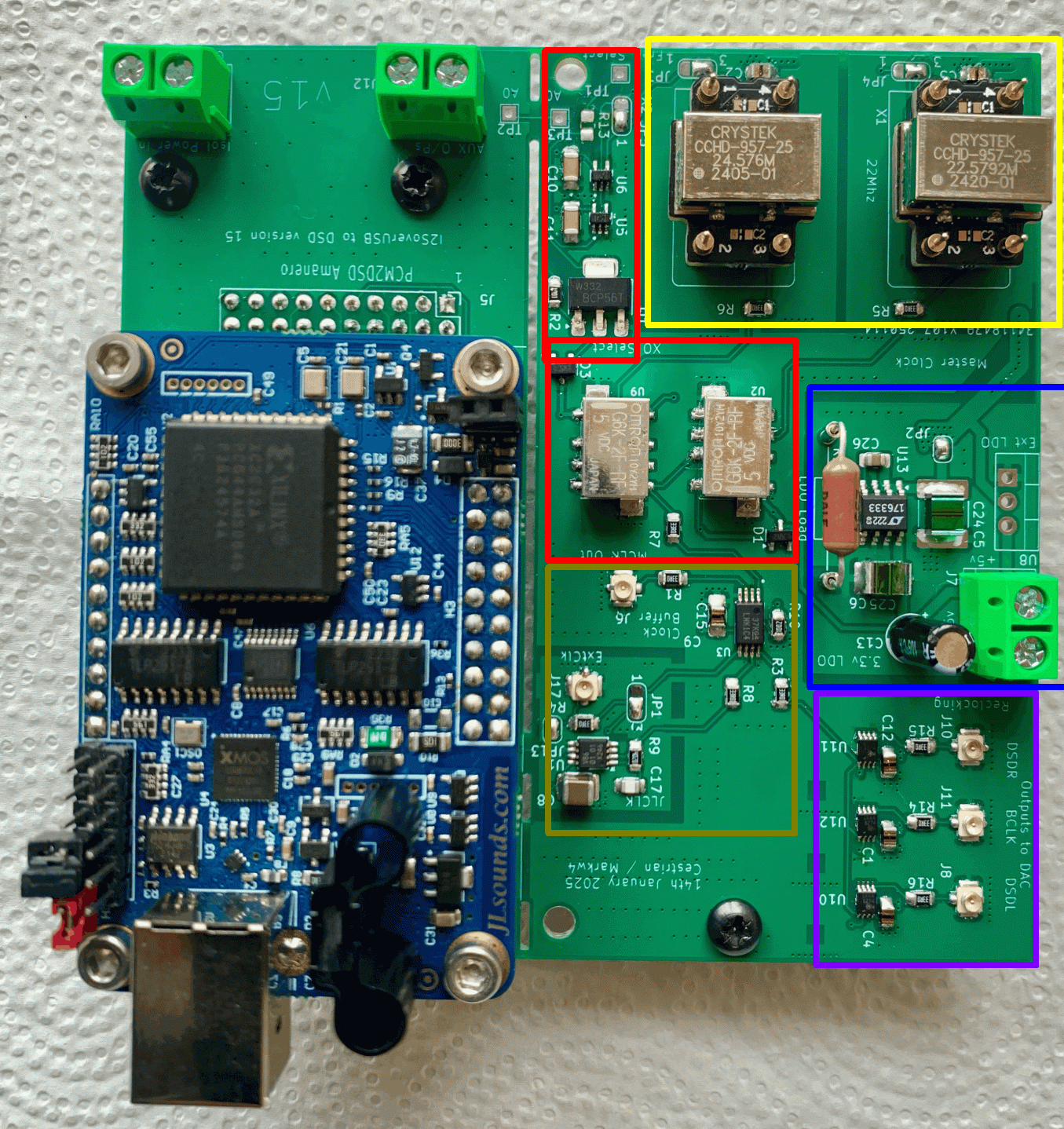

If we could get back on topic regarding my implementation of Marcel's RTZ dac, I have been asked to explain about the interconnections and signal flows. Maybe that would be easiest starting with Cestrian's simplified and compact clock and reclocking board. If I may borrow a pic from Cestrian's thread, here is a pic of the board.
Starting at the yellow box in the upper right corner are two clocks. Dacs typically need two clocks because there are two families of digital audio sample rate frequencies. The whole right side of the board including the clocks is powered by a local voltage regulator shown in the dark blue box. In the red boxes are some control circuitry and relays to switch between the clocks based on a control signal that comes from the blue color USB board on the left side of the pic. After the correct clock signal is selected, that signal travels down into the gold-colored box area. There is a clock buffer chip there to make multiple high quality copies of the master clock signal. On the lower left corner of the gold box is a frequency doubler circuit that produces the higher clock frequencies needed by the blue USB board on the left (45/49 MHz). One of the master clock copy signals also flows down into the purple box area in the lower right corner which is where the I2S signals from USB board and FPGA board are reclocked before being sent over u.fl coax cables to the dac board.
On the left side of the pic, the blue USB board includes galvanic isolation of the USB bus from the clean power on Cestrian's board. The USB board is powered from two external mutually isolated +5v power supplies. Underneath the USB board is an FPGA board which can convert PCM audio to DSD256. The FPGA can also pass external DSD audio coming in over the USB bus. By that means HQ Player or another app can be used to do the DSD conversion, and or DSD rips from SACDs can also be played.
Thus, I2S bus signals originate at the USB board, then they are passed through the FPGA board, then they are sent over to the lower right hand area in the purple box to reclocked before being sent to the dac board.
The setup shown in the 2nd pic of the first post of this thread works about the same way except the processing is spread out over multiple boards, so it looks a little more complicated.
In addition to the I2S signals, the dac board and the clock and reclocking board require a number of external mutually isolated power supplies which are only connected together at the grounds of the load boards they supply power to. That isolation is used to help avoid ground loop problems.
There should also be an ground-breaker (aka hum-breaker) circuit, not shown here, which safely connects the dac board ground to the AC line ground in a way that minimizes the chances of problematic ground loops.
Is it good to use mechanical relays to switch 22/24 MHz signals, instead of IC (logic, mux)?
Alex.
I believe so. Less phase noise, at least with gold contacts. Its what Andrea Mori used, and what Iancanada uses for his squaring board. Andrea has phase noise measurement equipment, and IIUC, Ian has some of that now too. I expect the choice was based on measurements. However as I have mentioned before, I'm not so sure if phase noise plots tell us all we would like to know.

@Markw4 , connecting to post #348 the explanation in post #365 is talking about the following (wanted to confirm) -
For the pic in post #365 I see there are three power supply inputs (a) two 15V and (b) one 5V. What is the peak current they expect? Wanted to check what power supply can be used here.
Another question is regarding the I2SoverUSB board. Its documentation has multiple configurations. How is it configured in this case?

Actually, they are all +5v power supplies. I mentioned Cestrian that someone might mistake the V15 marking to think it refers to voltage. In reality, it refers to Version 15 of Cestrian's design iterations. It was only at somewhere maybe around V13 that I offered to assist. Also, one of the screw terminal strips next to the V15 marking is a status signal output for MUTE and DSD_ON. The other +5v power input is hidden under the USB board.I see there are three power supply inputs (a) two 15V and (b) one 5V.
I use power supplies from Aliexpress or ebay. They are based on LT1083 or LT1084 because they tend to sound good for analog audio and because the load boards generally have local secondary regulators for the sensitive circuitry. What is important is that each external regulator board be isolated from all the others. That means no shared grounds at the voltage regulator boards and no shared or center-tapped power transformer secondary windings. IOW, each external regulator board needs to have its own dedicated power transformer secondary winding. Also, the FPGA board can share power with the clean +5v supply for the USB board (that's the only power sharing exception).Wanted to check what power supply can be used here.
As a side note: The Chinese power supply boards output stability can be improved by replacing the original trim pots used for voltage adjustment with quality Bourns trim pots.
In addition to the three power supplies used by the clock and reclocking board, the dac board needs 3 power supplies of its own. Also, if the output stage is a powered one then it will also need its own external power supplies.
The USB board is configured for external clocking, and to output a 22/24MHz MCLK for the FPGA board. This is accomplished by installing two zero ohm resistors on the bottom of the USB board. The USB board is also configured not to run on USB power for the dirty side. That option requires cutting a solder jumper trace on the bottom of the USB board.How is it configured in this case?
Forgot to mention something new: Cestrian is working on a V16 clock and reclocker board with basically a minor change that won't affect most users. The change adds u.fl connectors on the bottom of the board to bring in external clocks. That's to allow for people using Andrea Mori DRIXO or Acko clocks that require external squaring. In that case clock switching would probably be done at the squaring board and the output of that then brought into one of the new added u.fl connectors.
For anyone already using existing V15 clock and reclocking boards, its easy enough to hack on one or two u.fl connectors if needed. I can provide instructions for how I have done it before if anyone would like to see one way of doing it.
Also, an external squaring board would require an additional +5v (or maybe +3.3v) power supply.
