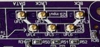

@Markw4 IIUC, the board in this thread is just the reclocker part? The I2SoverUSB will take audio from USB and output I2S signal. Does the reclocker board then reclocks the signal and then outputs I2S ? The reason i ask this question is that, is it a general purpose board that can feed other DACs like DDDAC that take i2s input?
For example in the pic you posted it says DSDR, BCLK and DSDL
Is it same as BCK, LRCK and DATA

I2SoverUSB from JL Sounds is galvanically isolated with clean and dirty sides. That's what I have been using. The dirty side can run on USB power or from an clean isolated +5v supply, which is what I do. That's the blue USB board you see on the lower left side of Cestrian's clock and reclcocking board.I2SoverUSB board itself can also take separate input power (dirty side) and output power (clean side). Do we use I2SoverUSB board like that?
Okay, now that you added the pics, no. Its called a "Clock and Reclocker Board." My open source reclocker board is linked to from the first post of this thread; it doesn't include clocks.@Markw4 IIUC, the board in this thread is just the reclocker part?
What we have been discussing recently is a simplified, compact clock and reclocker board by Cestrian. That's the pic you showed. Regarding that part of the board, its true the D-flip flops are used for the actual reclocking. However, if you don't have a good MCLK signal to clock the flip flops then you will have garbage in, garbage out. The rest of the whole right side of the board is to produce that good quality MCLK signal, and to synchronize it in time with the incoming I2S data so the the reclocking will have the desired effect. Therefore the right side of the board also has to provide an external MCLK signal to clock the USB board synchronously with the reclocker flip flops.
Those are the I2S bus signal Marcel's RTZ dac needs. That's what Cestrian's board is designed to work with. The signals work fine and are aligned in time to work fine with Marcel's RTZ dac. If you take some other dac, such as an ESS dac, it has different timing requirements. So, you may need to delay one of the signals a little, or you may want to only reclock the MCLK signal. You have to read the data sheet for the dac you want to use and condition the signals as necessary for that particular dac. Now, it isn't that hard to do in most cases. In some cases it can work as-is, or it might be as trivial as making one of the D-flip flop series damping resistors a higher resistance than we otherwise would. Or maybe we would have to add an inverter or two to make a low jitter delay. Depends.For example in the pic you posted it says DSDR, BCLK and DSDL
Yes.Is it same as BCK, LRCK and DA
