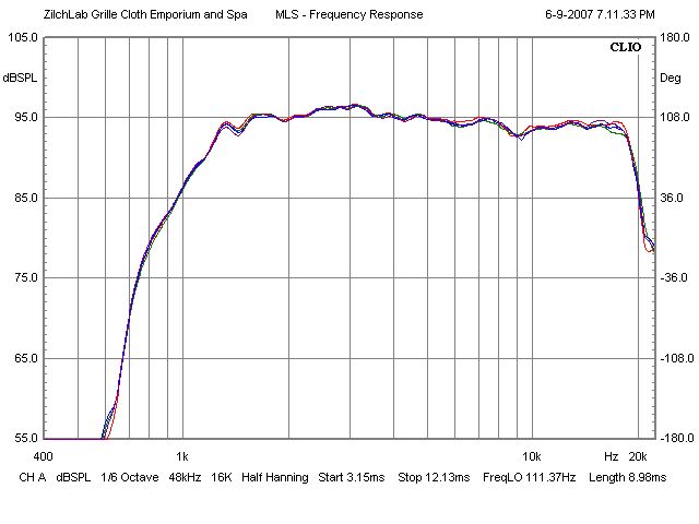

Best I can tell, it's a resonance.
Biggest virtue of BMS is the sonic smoothness of their Mylar diaphragms.
Compensation is easy. Here's four 4555s on JBL PT-F95HF using Altec M19 XO HF filter, as I recall:
