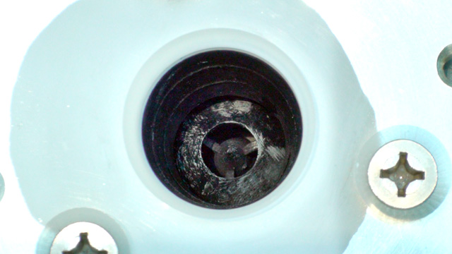

From a previously picture of the inside of the B&C DE250 it shows what looks like a rather crude metal plate with the narrowing 1" hole...are they all made so crudely simple at this point

I am sorry but I couldn't disagree more. The B&C compression drivers are exceptional products with a very high precision design. There is nothing "crude" about them at all.
Which way is "inversed"? Concave or convexed? Most high performance CDs are concave domes as this minimizes path length differences to the throat. There are some special designs that use cones and domes in combination, but these are high powered pro units.
Sorry, but this picture says to me that the outside is pretty, but what you cant see appears more shabby or sloppy...I didnt speak when I first saw the picture, but it was my first thought
But I believe you when you say its good enough and actually sounds better than many others

btw, I am not even sure that most other affordable CDs are any better on the matter on inside quality, "inner beauty", but I only hope
I am not even sure it would matter much in terms of sound quality, but I somehow like good build quality through out and believe that in the end it will reflect on sound...and no, I am not rich either...no GOTO in sight
btw, I reckon I will invest my money in FaitalPro and Azura, and live in the hope :clown:
I have not found this to be the case, to wit TAD drivers whose build quality is superb, but whose sound quality was shown to be no better than equivalent B&C drivers at 1/10 the price. Go ahead an spend what you want on "inner beauty" in hopes that it will sound better, but my advice is to not equate price and apperances with sound quality. "Inner beauty" costs a lot more to do.

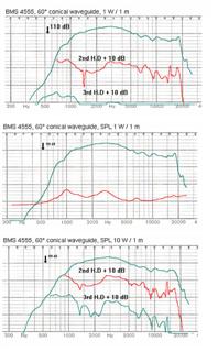

Thanks Eva, I have been looking at BMS...I think the 1.5" 4555 looks smooth, low distortion with no "hickups"
but its no neo driver...any comments ?

I wonder why there seems to be a high peak close to 20KHz that is quite close to where a normal breakup mode is. Wish I could see some CSD and impulse plots.
Do you know where information explaining the path length problem is solved can be found?
