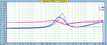

soongsc said:
Playing around with wave guide/horn the impedance peak seems to show two peaks blended, impedance phase crosover actually become lower than F0. This seems quite interesting.
It seems very interesting how a horn/guide can effect the driver impedance. Attached is some results. First curve is the raw driver, second curve is one third of the guide/horn from the throat, third curve is the whole horn/guide assembled together and with an RC zobel to flatten the high end of the impedance curve.
Any comments are welcome.
It is amazing how sensitive the match between the driver and horn/guide can be. Driver break-in seems audibly critical. I hope to do some measurements with broken-in and not broken-in drivers some time next week.
Note: direct radiating driver is used.
Of course the "load" on a driver affects the electrical impedance this is just fundamental lumped parameter effects. But I don't see how this can tell us much about either the waveguide or the driver as impedance is a lumped parameter quantity and does not show anything regarding wave motion etc. in the waveguide. One CAN see seveer horn resonances in the impedance curve if they exist, but once these have been elliminated, as they are in all of my designs, then the electrical impedance ceases to show much of relavence.

I am trying to figure out how the impedance change will effect driver and system performance. I understand that the lower impedance will allow more current to go through the driver, thus improve the power response at the low frequency.
I think the break-in might relate with the surround material. In the beginning, the driver really sounded harsh, when I added the zobel, it did improve the harshness somewhat. But just sending full spectrum audio signals through the driver for a few days, the sound became much smoother. This is the first time I've experienced such break-in difference in any driver, and I've played around with quite a few wide range drivers.
And maybe your ears just got broken-in to this sound character.
