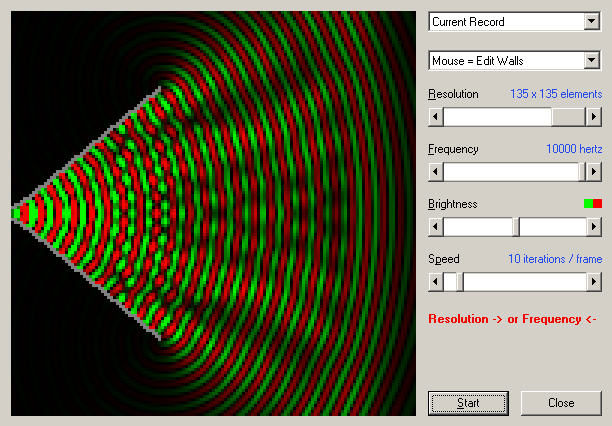

i have made some research here in brazil, but the companies that make this kind of foam, are not interested to sell a small quantity. i have read however somewhere people made direct comparisons with and without the foam, and the difference was reported to be very very slight or even not perceptible. So i really don't know....
Angelo
No one here will sell a small quantity either. I have to buy about $1000 worth at a time. The material is very expensive - and then it has to be cut, which is no small feat.
I can only say that I have only ever read where people have reported a big difference, which agrees with my experince. What your reporting I have never seen anyone say.
angeloitacare said:i have read however somewhere people made direct comparisons with and without the foam, and the difference was reported to be very very slight or even not perceptible. So i really don't know....
I have a Unity horn system. To my ears it had a slight "horn" character. Not much, certainly not to an objectionable extent. That is to say, that it didn't stop me from enjoying the speakers, but on certain passages it was there - that slight echo kind of quality. If I fill a little more than half the depth of the waveguide with the foam (that I bought from Dr. Geddes), it completely goes away.
Maybe some are more sensitive to this effect than others. However, I'm no golden ears listener. I build my own amps and speakers and I can't hear differences between most caps I've tried, or most tubes - though I can measure differences between individual tubes and I pick the ones with the least measurable distortion.
Now if your horn has low HOM's to begin with, maybe the difference would not be so audible. But I would certainly try it.

Please post the URLs. AFAIK, I am the only person who's ever done an A-B comparison of a horn WITH and WITHOUT the foam besides Sheldon, and posted the results.
I did this back in 2005 on Richard Clark's forum.
The differences I heard were DRAMATIC, and eventually led me to invest in a pair of Summas.
Keep in mind that the ONLY proper comparison is done with a re-designed crossover. If you don't redesign the crossover, the comparison is meaningless, as the frequency response is affected by the foam.

I'll sell foam, but most people are surprised by its cost. The stuff is very expensive. And cutting it, well thats your problem if you buy a solid chunk from me and don't use my waveguides - the foam is precisely fit to my waveguides and won't fit other designs that are different. As to crossover mods, well those are all going to be different and there is no "rule of thumb" that I can give. The foam drops the high end about 2-3 dB.
Foam reduces HOM but it also reduces internal reflections whcih ALL horns and waveguides have. There is no way to distinguish between the two so I seldom mention it. Hence, any horn or waveguide would benefit by the foam, but to varying degrees.
454Casull said:Is there anything particular about the foam that cannot be replicated with some carefully-cut-and-folded fiberglass insulation?
I use the foam because it is quite porous - unlike fiberglass. Its probably four times less dense than fiberglass. And fiberglass is not well controlled, being denser in spots etc. I've never tried fiberglass, but I wouldn't think that it would work too well. The foam is ideal since its highly controlled and comes in various densities etc.

To fit into a waveguide - no! That takes a custom cutting tool and apparatus that I had to design and build. Sure there are companies who would do that but they need about $10,000 in orders to make it worth their time and effort.
Patrick Bateman said:Keep in mind that the ONLY proper comparison is done with a re-designed crossover. If you don't redesign the crossover, the comparison is meaningless, as the frequency response is affected by the foam.
To get an apples to apples comparison, yes. But my HF hearing is poor, so I don't hear much of a difference in frequency response. But I do hear the change in horn character. Still, my system is frequency corrected with a DEQX, because I use it for my crossovers anyway.
I'd wager that even without the correction, most horns/waveguides will sound better with the foam. I find it fairly easy to adjust to small changes in frequency response, less so to horn artifacts.

I think that you are quite correct here and there is data to support it. The foam will be a very gradual smooth (nothing resonant) roll-off of the high end and almost nothing below about 6-7 kHz. Its major effect will be on waves that pass through the foam several times, like reflections, and waves that travel longer distances, like HOMs. This is why it works so well. Its effect upon the main wave is minimal, but its effect on the aberations (distortions if you like) will be major. A real nice net improvement overall.
I early subjective tests of the foam (with no EQ), some, like myself, liked the change, but others didn't like the HF loss. When I corrected the HF loss with EQ everyone liked the effect.
