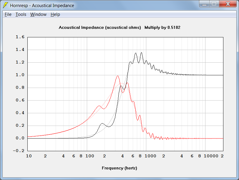

But it is well known that Webster's equation is wrong,
The error is not with the equation, but in its application.
Used appropriately, Webster can give a reasonably accurate prediction of the throat acoustical impedance of an OSWG, required if acoustical power is to be determined.
The light traces show an infinite horn, the dark traces show the finite horn.
This appears to be a view that is somewhat at odds with accepted practice. Are you able to provide links to work that supports it or perhaps expand a bit more? Thanks.I have never made a device with a rectangular cross section. It just doesn't make any sense to me to do that since the source is not rectangular. I have made elliptical section devices and they work just as expected, but are significantly harder to work with and in the end I found little to no advantage in doing so. I just stick with round. They may look boring, but I have not found anything that works better.
If all you care about is the acoustical impedance of the lowest mode at the throat then Webster works OK (it is still a rough approximation, not exact as the OS is when done properly. And the two don't give the same answers - the exact OS is clearly the correct one.) I find the information provided from Webster of little practical use and no use at all in finding the devices directivity.The error is not with the equation, but in its application.
