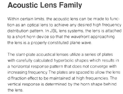

Funny, soon after making my last post looked up refraction, it seemed more appropriate for the primary function of the slant plate lens.
Then looked up the old JBL horn lens brochure, they only mention "lens diffraction effect" in the explanation.
At any rate, they sound warm and fuzzy 🙂.

I did my MS thesis on slant plate acoustic lenses. They are definitely refraction devices NOT diffraction. But hey, refraction - diffraction, its just a couple of letters. What's the big deal?!
Earl.
Where would refraction come into play in one of those plate lenses on a JBL horn? It seems that you would need a change of medium to have a true refractive change. I don't see how there is anything but diffraction involved here? Can you post that thesis or a link to it, something just doesn't add up for me here.
Well I looked at both those articles and from what I see it confirms what I am thinking. I see no change in medium or change in temperature where any refraction would take place. The second article is talking about reflections and not refraction, reflections would appear to be diffraction effects and not refraction effects. Someone want to show me where I am incorrect here?
Yes Earl,
Those horns never worked as described, at least not very well if at all. I do have personal experience with those horns and know them well. This was one of those things that JBL did that just didn't work as planned. The polar response of these horn lenses was pretty bad. Talking about internal reflections back into the horn this takes the cake.
First, you need to understand that refraction does not take place within the medium, but at the interface between two different mediums. One medium, in this case, is air and the other the plates. Since the plates require a longer path, the wave speed is slower where they are present. When the slower waves meet up with the airs normal velocity refraction occurs. It is not ideal, which is why it works so bad, but that's the idea.
Got it Earl. At the same time wouldn't the speed in the aluminum plates themselves be faster than the air? It would seem due to the extremely thin aluminum the actual emissivity at the end of the plates would be rather small compared to the air itself except perpendicular to the plate surface area. Refraction would appear to be very minimal while diffraction would seem to be the dominate factor here.
There would be almost no sound going through the metal plates. Even less through the plastic ones. there would be a significant amount of diffraction, yes, which is probably why they didn't work as the theory suggests.
