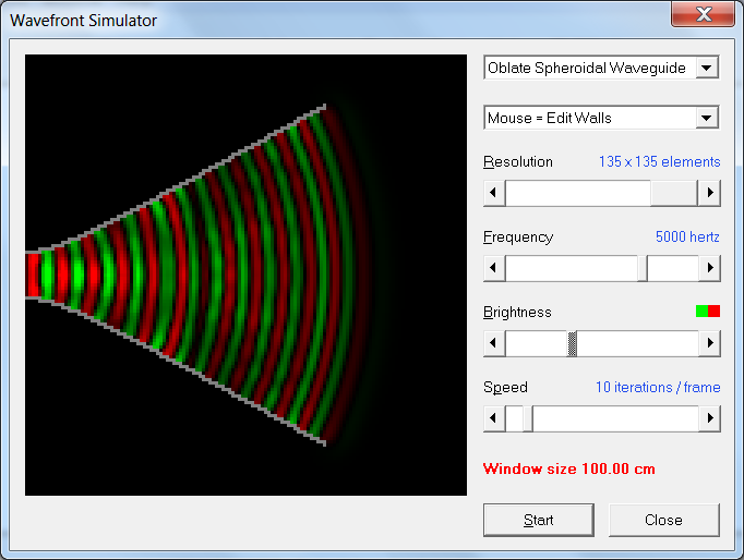

I would like to design a radial horn with an OS profile on the horizontal plan and a hypex area expansion. So to calculate the vertical profile I need to know the expansion in the horizontal plan.My question would be what do you need the area expansion rate for?
I will use a planar wave model for the vertical plan (should be close enough), but I would like to use the correct model for the horizontal one.
I think I will stick with a "normal "OS profile without any radius at the mouth (I might us dense foam there if I measure anomalies, but it will probably not be too severe with a radial horn).The mouth is near conical, but the throat is far from that. If one wants the wave front area from the throat to the mouth then it could get complicated. It would be true that this wave front is always a spherical section, but near the throat the radius and angle subtended would vary continuously, starting at an infinite radius and zero subtended angle. Unlike at the throat, near the mouth the radius would vary directly as the distance along the device.
So my only concern for now in the expansion at the throat.
I am currently using a mix of a planar model at the throat, changing to a spherical one along the way. But this is not really precise, and not really satisfactory to begin with...
Maybe I should look at a simplified model like the Peavey quadratic one?

Use that tack for the first approximation, then adjust for the area over a toroidal patch, instead of over a cylindrical segment. You have two [r]'s instead of just one. [r(x.y)] is the first, discussed in an earlier post, the second [r(x.z)], where [x] is the horn axis.
Note: As Area and [r(x.y)] are givens for a particular [x] values, you should be able to calculate [r(x.z)] and [z]. (or at least iterate and converge on solutions using Newton's Method).
It is the two long curvilinear mouth edges that should be of concern; put some lips on them. Then foam the short ones if necessary.
That begs the issue. You are morphing orifice boundaries from circular (flat disk wave front shape) to that that approximated by a toroidal patch. Squeeze flat, the cut-off end of a garden hose, while the water is running, to get some idea as to effect you are trying to create acoustically. The most important part of horn design is what you do at the ends, not between them.
You will need to get your mind around the math and geometry needed, all of which is not beyond 1st. year courses in calculus and analytical geometry.
What you are trying to accomplish is approximated by a Smith's horn design [1] and its derivatives [2]

I've tried to express the area expansion in some simple way. Obviously, there is a difficulty near the throat (radius of the spherical cap goes to infinity). To avoid the struggle with OS coordinates, my thinking to overcome this was as follows. The contour function (i.e. hyperbola) can be expresed as a weighted sum of constant and linear function (Eq.1). The weights A and (1-A) are also functions of x (Eq.2). My guess is that the area can be expressed in some similar way but I haven't the time to elaborate on that. Maybe someone will catch. Whether it's even possible, I don't know at the moment.
I don't think that it is impossible or probably even that difficult to find the rate of change of the wave front area with distance for an OS waveguide. I just fail to see the use of such an equation. This form could only be useful in Webster's equation which is defined by the rate of change of area. But it is well known that Webster's equation is wrong, so what is the point? You will also find that the area equation has two terms. Having tried two term forms in Webster's equation before, it is difficult to solve - there is no closed form solution possible. Basically I see the whole thing as kind of a dead end.
I see it only as an interesting mathematical exercise. I don't see the need either. Pos has just asked me if I could help...

Earl, I agree with you. Doing this would be incidental to modeling horn acoustics: a much more daunting task [1].
For an experimental radial horn just take two hyperbola pairs, defined by the coverage angles desired, [Øh] & [Øv], for the horn boundaries, and don't worry about area expansion. Just extend the curves out far enough so that the mouth is big enough to pass the lowest frequency of interest with negligible response ripple. Then morph the throat from circular to rectangular using declining fillet radii.
Note: The [Øv] pair is swept through the angle [Øh] to form a radial horn.
Have you tried this? Is so, how did it sound? How did it measure?

When you have a horn that is not axisymmetric, thing are a bit tricky because the wave front is going to vary. Probably some 3D BEM simulations can give a general idea what is involved.
OS Radial Horn Revisited
Sent
Arguments for a radial OS Horn (with narrower vertical OS section swept out by following the locus of an elliptical segment in the horizontal plane:
1) A cross section would not be rectangular. it would look like a bow tie.
2) Only Sections of an elliptical cylinder cutting through the horn vertically would have Rectangular Boundaries far away from the horn throat to allow for a gradual transformation from flat disk to approximating OS patch.
3) As there is a cylindrical shaped aperture of two differing dimension expanding at differing rates, as apposed to just one for the circular section horn, HOM's should be diversified and less energetic.
4) As more horn surface area is in contact with the propagating wave, a higher degree pattern control (guidance) would be provided by the horn.
5) While the driver diaphragm is round the audition space (room) is not. For a short throw horn a dispersion pattern wider in the horizontal plane than that in the vertical plane is desirable.
