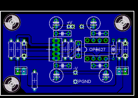

Things have not changed much atm, just the replacement of the Stand off holes, and the repositioning of the +V decoupling cap.
I ran into a problem when i first removed the +V connector block.
As the middle pin was a ground there was a source for the ground in this area, as soon as it was removed it created an "Island", and this was the reason i turned the decoupling cap 180 degrees.
As you will see i have added to pads for a jumper to over come this island problem.
I have tried for most of the day to find a better solution, but apart from redoing the board, I can see no other viable option.
I hate using jumpers and always feel its a bit of a cop out, but I have been forced to commit the dreaded sin of putting them in there.
If someone could see a better way of rounting it to get rid of the jumpers, please feel free to guide me toward the light.
I like the idea of having the regulators onboard also, I may be working on a headphone amp once this pre is finished and would like the board to be stereo and have the supply all on one board.
If i manage this I would revisit the pre and update the design then, if someone has not done so allready.
In addition I'd prefer to get rid of the connectors an have bigger pads for the in/out wires.
Don't worry SvErD I have not forgot about your suggestion, and I will implement it, as I think this will give more options, for various hookup wire.
Ok, this attachment shows the loaction of the mounting holes, and the jumpers to remove the island effect.

Hello n00ber
First of all, i see a serious fault. Before, you and I had the BW and V- pins on the BUF tied together but now when you have added option for a BW-resistor it seems that you have forgotten that the V- is actual pin 3. So if someone is using the BW resistor they will power the BW pin with the supply and the V- pin with the supply+resistor and if a jumper is used then you will have a pretty long V- trace and loosing the "100nF cap close to the pins"
Second, don't know if it's a problem but it seems that the route for the V+ to PGND has to go around the whole card and thru a 1mm wide trace close to the output resistor.
Keep it up!

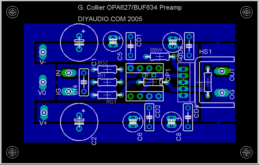

Not trying to step on any toes here, but I promised a new layout of my own about a week ago, and finally got around to finishing it. The boards are 1.75 x 2.75" ...quite small. Those big caps are intended to be 470-1000uF to hopefully clean up any ugly supply ripple and of course are optional if you are using a regulated PSU.
A few notes on this design. RF1 is the feedback resistor and is intended to mount on the bottom of the board. The pads above the resistor are inteded for a feedback cap as suggested in the BUF634 app note for use with several opamp combinations in this circut. I personally don't bother with an OPA627. RBW is the bandwidth select resistor (if some people wan't to use slower opamps you can leave this out). A resistor should cut down on the heat in the BUF, but you could jumper it if you like. The input cap is small, I've been using vishay MKT caps for this and they sound fine to me. If you want something big and fancy then solder it inline and jumper the cap pads. And finally...the output is located behind the heatsink...I left a bit of space here to accomodate for thicker heatsinks, I've been using cut offs from aluminum T-Track which have a 1/8" thick base, these make really nice heatsinks.
I'm also putting together a PSU layout to go with these. The plan is to use an AMVECO encapsulated PCB mount toroid (I just bought one). It will be a regulated supply very similar to what NUUK has on his site.
Anyway I'm off to bed, fire away with any comments/suggestions you may have.
G. 😀

Gcollier:
I like your design. Seems like you have lots of unused space left on that small board. If you stretch it out from left to right and move C1 and C2 to the left their might be room for regulators. I stretched it out using Paint to give you a visual.
Also, the way you connected the output-ground-plane to the main-ground-plane using two connection points might cause a ground loop, I'm not sure. Someone else might know better. I circled that on the pic.
